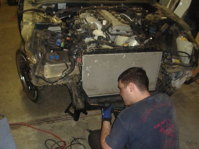

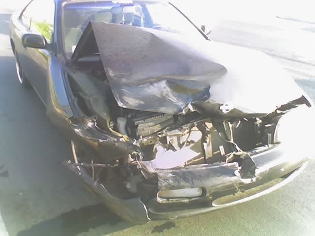

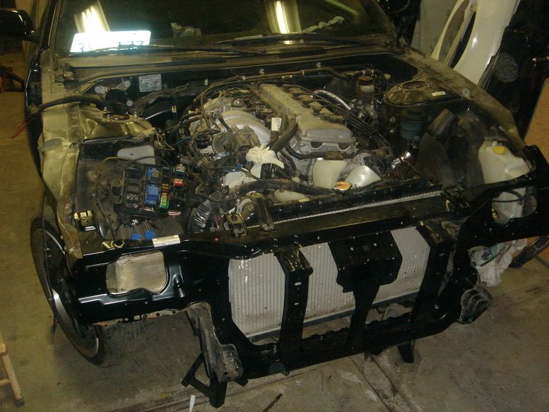

For further input, another forum member recently did similiar damage, though much higher up, on his car and I sent him an entire front apron/tower assembly from a parts car and he will be attempting installation of it soon. With the chassis stripped back enough it's as easy as one nice seam weld, but I would never rely on the section for anything more than support of the vehicle. In other words, hard driving, abuse, or using it as a tow/pull ram would not be ideal.

^ Yep Russ, thats me . By the way thanks for all the effort and the materal! Heres a couple of pics so far, It is being sent to a shop to be done the right way, with this area it must me its importain and should be done correctly, If you dont mind ill post a couple of pics that were taken and show you the damage, about a week or so it will be at the shop, in which i know and ill take some pics for you all. This damage is very freqent, and I will see how it will hold up to some abusive drifting after the repair :P
and no this wasnt a drift accident,..... me, going to work... bahhh
Picieeeeyss
The Day of ^
Front support off ^
Test Fit of s15 raditor support, thanks superior nissan for the hook up1 ^
and soon more pics of the arm repair, becouse of my damage, it was close to the tower, but no other damage, it was a 50/50 but i will fix it,
Hope it helps good luck mang!
