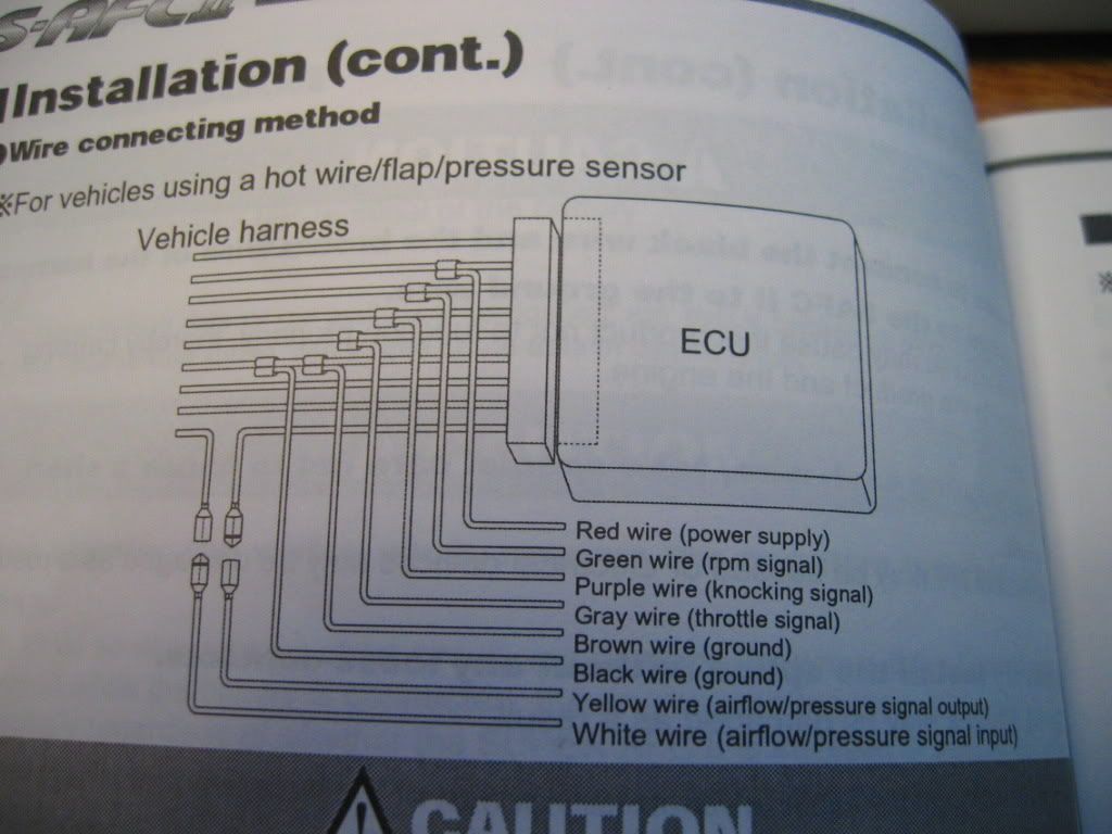

Ask and you shall recive. this is the installation document that coame with the SAFC ANd the caution says unhook - battery terminal before installing. witch is a GREAT idea:

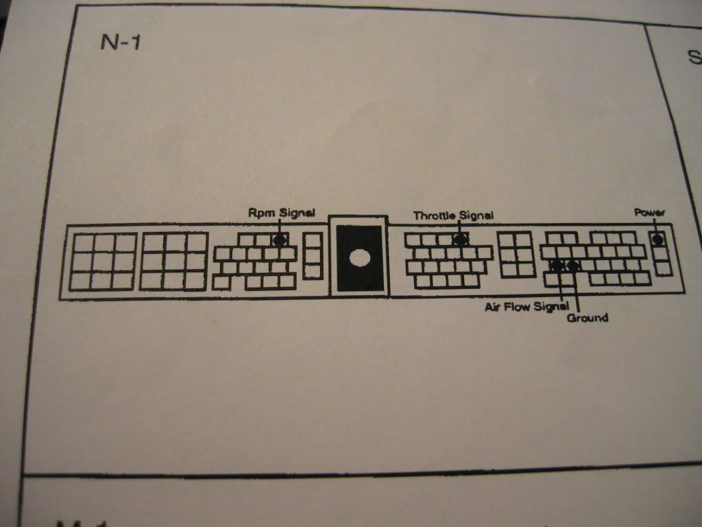

this is the american vehicle suppliment thet you have to search really hard for on the apexi website:

btw that diagram the 2nd one is for a 97 ka24de powered 240sx right.
where do i put the other ground and air signal?

yes the second one is for the S14 US model 240sx.
those are the only 5 wires you tap into for the KA.
the air signal is spliced in. look at the diagram. signal goes into the SAFC and back out into the ECU.
the second ground is hook up
*****AT LEAST 3 INCHES*********
behind the 1st ground
notice how i emphasize it beause it will not work right if you don't do it that way.

look on the right hand side of the diagram. notice how one says imput and the other says output? that is the kee. signal comes from you MAF into the white wite (imput) then gets edited by the SAFC and goes OUT the yellow wire (output) inot the ECU so the ECU sonly sees the edited signal.
if you can't get that you may want too look into getting someone else to help you out on this one.
and the ground it in the direction AWAY from the ECU and 3+in past the connection of thre brown wire. it's best to use T splices to put this in. (1.99 a box at napa)

i think i get it so the air press. would be some thing like this:
___ecu (maf)____ ____ ecu(box)
______________| |
______________| |
_____white(input) yellow (output)
_____________ ____
_______________^
_____________safc
right?
(dont mind white lines at far right had to use to space properly)
s14 kouki ka-t
turbo2nr is offline   Reply With Quote
Old 01-16-2006, 09:45 PM   #16
Tenchuu
Tenchuu's Avatar
Join Date: Apr 2004
Location: Oregon
Posts: 2,474
Tenchuu is close to perfectionTenchuu is close to perfectionTenchuu is close to perfectionTenchuu is close to perfectionTenchuu is close to perfectionTenchuu is close to perfectionTenchuu is close to perfectionTenchuu is close to perfectionTenchuu is close to perfectionTenchuu is close to perfectionTenchuu is close to perfection
yeah that's the basics of it. altho i thought the manual did a bit better job of drawing it.

conceptually i tihnk of the mafs signal more like this:
MAFS--------SAFC-------ECU
and stock is just like this:
MAFS--------------------ECU
the safc intercepts the signal and modifies it how you want based on throttle position and rpm.
it basically lies to the ecu about how much air the mafs is reading. the ecu tells the injectors how much fuel to flow based on how much air the mafs reads, so if you modify the mafs signal, the injectors flow differently to match the signal.
