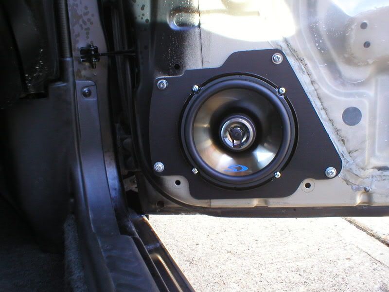

There's a seller on Ebay now selling adapter plates for 6.5" speakers to go in the doors of an S13. They're made from 1/4" thick PVC sheeting. I bought a set, and they pretty much fit perfectly; they exactly mimic the outline of the stock yellow plastic mounts, and have three sets of holes for whatever speakers you get.
They cost about $12, and I highly recommend them, they made my install go very easily.
Here's a pic on the passenger side, with the Alpine speaker I used:

Yea the Ebay conversion plates where what I was going to buy since I wouldn't have the time to make my own.
I would like to keep it looking stock, another words keep the grill on. Will I be able to do that with the Ebay conversion plates? I would post a link but I'll get in trouble.

i made my own plates. that look exactly like that..damn i should have jumped on ebay selling those a long time ago. But yes, with those plates u can still keep your grill on the doorpanel.
ALSO since those plates dont come with speaker baffles you might want to look up on some 6.5 speaker baffles so water will not damage the speakers when it rains or u wash your car etc. although i dont use baffles but i woudlnt doubt one day my speakers start getting rust and crap out on me.
