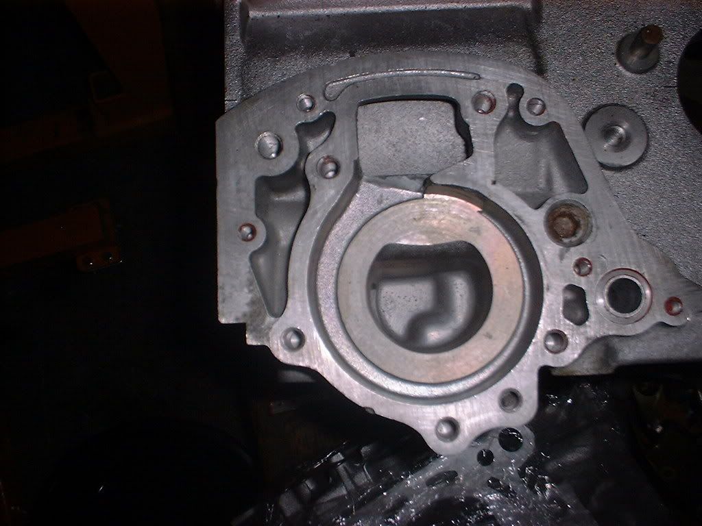

Hey I was wondering if ayone out there has or can take me a close up picture of the hole behind the waterpump with the waterpump off on a s13 SR20DET. If anyone with there waterpump off can snap a quick picture and measure the hole into the block It will be much appreciated. Thank you for your help in advance.

I dont think you can make this based on pictures alone, you would need a block and pump to do this. I have an extra crap block i will let go for $100. If you are serious about this project, hit me up.
Also, i dont think the devil is in the impeller, but in the spacing behind the impeller, i remember this being covered somewhere, and someone made a backing plate behind it, so it would not have a dead zone to churn water.

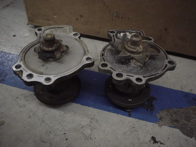

from what he said he wanted to bring the tolerances from the wheel to the block a bit closer so he needed a picture of the water pump flange on the block without the water pump on. the impeller he is wanting to make is a one piece aluminum wheel that has a backing plate like the in picture
so all i need is a picture of that space, if anyone would be kind enough to share one I would appreciate it much. thanks

IDK what he can do as far as "tolerances" are concerned with this picture alone. This pump DOES need to be made though, not so much for "fixing some horrible problem", but high rpm load.

koyo rad (no ducting), SPAL dual fans, toyota coolant, 420hp 1.7+bar of boost up to 32psi on a bottom mount turbo, seibon dual vent carbon hood, revlimter for DAYS at 90+mph (generally 60+), never hotter than 95c on the track running 5+ car tandem. with THIS waterpump. (LEFT)
and i overheated my friends car to 130c+ in under 1 lap...soooo im gonna go ahead and say that mine works good.

Thank you johngriff I think that the picture will work if not I'll let you know. I'll keep you all updated on this.
