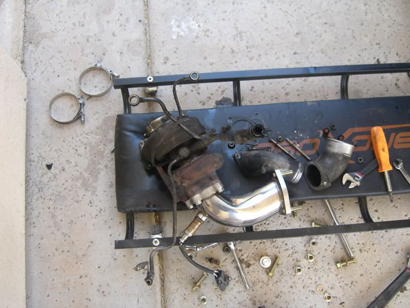

Hi guys, I bought a turbo recently for my KA-T build. It was advertised as a stock t-25 but I don't think it is. It says Garret m-24 on the side and ar. 80 Anyone know what turbo this is? Here is a pic:
[/img]
Also, I was wondering if the turbo is bad because when I try to spin the compressor, it won't spin easily. I have to try hard to spin it. I don't know much about turbo's. Does this mean the turbo is dead, or will it spin fine when hooked up to the oil lines and installed on the car, or should it spin easier in one direction than the other?, any help would be appreciated. I was always under the impression that you should be able to easily spin the turbo with your hand.
Thanks Alex.

that's one clean ass used turbo...
i'll go home and check mine since it's out and ready for sale,
but mine spins freely, both ways, no shaft play,
you shouldn't have to be struggling to spin it,
yours is possible busted, but it's journal bearing, it's rebuildable, probably 100-150ish??? not sure...

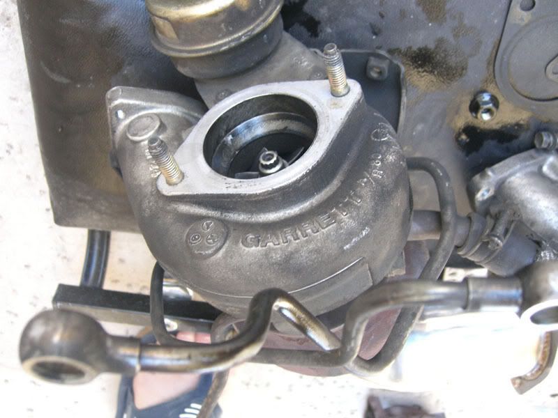

After doing a little searching, I found this on Wikipedia, which says that is a t25g turbo (shown below). Seems to be just the stock s13 red top turbo.

Man, that compressor wheel has a bunch of sludge on it. Pics of turbine side?

thats what my stock turbo says on it. s13 redtop

yes, thats a stock s13 redtop turbo, and yes, it's bad that it doesnt spin freely. It's true that it could be buildup in there - you can try spraying some degreaser in the oil holes and through the blades and spinning it by hand for a while, but theres no guarantee that the turbo's not toast.
