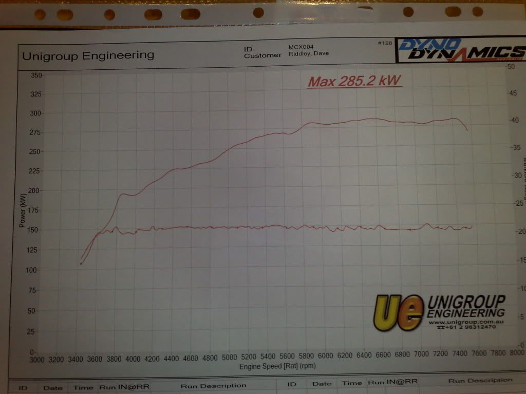

what i'm wondering is why your curves fall @ 6500? is that the turbo choking?
also, do you think you may achieve better response + more power with a different exhaust manifold?
would you ever go equal length?
If directed to me:
The torque curve does fall off, but still at redline it's making near 285/290 ft lbs....I think mainly because it's a T28 at heart, but in the same respect I'm making 400 whp at the same time...so loosing the torque at that range of the rpm is the least of my concern...
And on track I tend to shift at 7k anyway...no reason to take her to the limit all day long....shifting to the next gear is right back in the sweet spot anyway, so it's more of a continuation of carrying speed, rather than making more...
I was in the works of setting up an exhaust manifold test with Full Race and their new bottom mount vs my swain/extruded OEM unit, but it ended falling through...mainly because FR wanted me to be running a tunable EMS vs my ROM to see if they could extract any more power out of it...not saying it is, but in my mind that basically tells me for all intensive purposes that mine performs equal to theres on ROM tune cars. Plus I like the idea of the factory log style manifold to help keep spool times fast as possible, and to create more low end trq.
Like before, I will be dynoing with cam gears here in the spring....maybe if I can find some extra duckies laying around, I'll get a new OEM unit and make a provision for external gate (like the FWD guys do) and go from there...

okay i saw ur graphs and ur numbers and mods .. maybe compare it with my brothers .. as of what i know he should be getting the following items in and get tuned by nexy month or so
all items he all readys has but needs to get them in and tuned!!!
*gt2871r.64
*740cc injectors
*megan exh mani
*fmic
*hks ssqv
*brian crower 264 cams <-- didnt want the 272's cause he wanted a quick response
* brian crower valve springs with titanium retainers
* tomei 1.2 metal Hg
* greddy RAS
*arp head studs
*AEM EMS
*3.5 bar map
*full 3ich exh
and i think thats it well he has alot other lil bolt ons like sard fpr walbro fp and so on but those are the main things .. what do u guys think he's gonna get? i think its a lil similar to cody's just the fact that he doest have a rom tune or he doesnt have all the swian and porting or whatever that is on ur turbo .... also he will be getting tuned on pump gas 91 so yeah

Originally Posted by codyace
Undoubtedly...I credit that soley for making my car act like a disco potato on steriods
damm it so ur saying with out the hounding and so on there is no way to even see 400 whp?
also isnt the dico potato smaller than a 2871r? cause my friend made 375 whp on the a disco potao ... and i was impresed @ 17 psi with 340lbs of TQ and 100 octane .. o and also a built head hks camd and so on
hahahahaha is offline   Reply With Quote

Originally Posted by EchoOfSilence
What I think would be nice is a short-equal length manifold but obviously that's hard/inpossible I don't like the idea of log-style manifolds...
I really wonder what the gains would look like...certainly not worth the cost Im' sure...
The newer twin scroll setups are nice (that F/R offers on their top mount manifolds) and I believe they work well, but again, cost per users able to purchase them...
I definatly think that copying my setup is about the only way to get near that mark with the t2 manifold...but regardless, anything over 350 whp with this turbo is unreal to drive...and will be damn fast as it is...aren't guys already in the 11's with slicsk with 350 hp setups??? That's fast.
Built head and the 100 octane maybe part of that reason....but that's really stretching that poor spuds effeciency range...if possible post a graph...I wonder how bad it died off....again total area underthe curve >peak power ANY day of the week.

Old 06-15-2007, 05:18 PM   #13
delphis
Location: antioch
Posts: 312
delphis has a spectacular aura aboutdelphis has a spectacular aura aboutdelphis has a spectacular aura aboutdelphis has a spectacular aura aboutdelphis has a spectacular aura aboutdelphis has a spectacular aura about
not to rebump an old thread or anything but I found the same exact dyno sheet on brian crower website is this your dyno sheet on the site? if so congrats!
delphis is offline   Reply With Quote

Yes that is my dyno sheet on brian crowers web site. Ive talked to him via phone a few times and I atribute my higher than normal hp numbers to his cams and my custom exhaust manifold.

Yes T3 .63 3071 ....21 psi by 3600rpm and 285rwkw = approx 382hp max / approx 255rwhp by 4000rpm / 281rwhp by 4200rpm. Stock motor. Baby 255 inlet and 260 exhaust cams. Stock intake. Australian dyno dynamics. Pump fuel
