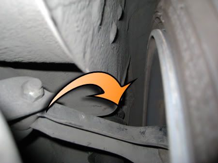

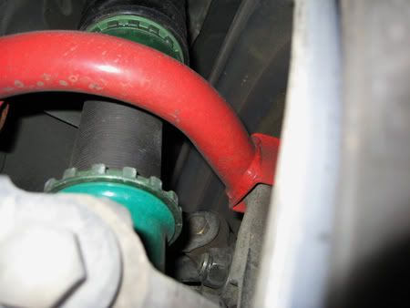

here is what the clearance of an s13 looks like with Volk CE28N 18x9.5 w/+28mm, no spacers and 2deg. neg camber. The fender has been rolled but to the extent of being flat against the inside of the fender in effort to get close to the desired 1.5deg. neg camber. Other components include tein flex suspension, battleversion ruca & z32 brake/hub assembly.
enjoy...

^Finally somebody does something worthwhile in this thread.....
SO for anyone who may be confused....
For INSIDE clearance.....the above picture shows a 9.5 wide +28 wheel
The INNER clearance is the same as:
10" +22
9" +34
8.5" +41
8" +47
You get the point....this is for S13 btw

The fender has not been rolled but the inner lip has been flattened against the inside of the fender
Thats what a roll is, you haven't PULLED them yet.
+1 for the post, though
