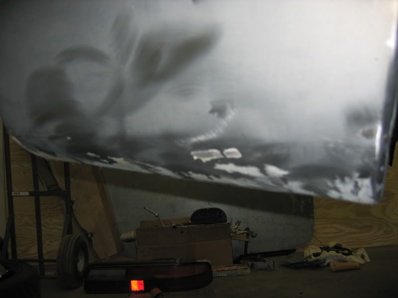

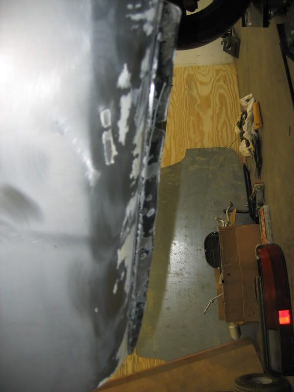

added spot welds to the door seams:
at this point this is all mock up, before the car is complete the car will be stripped of everything that is bolted on to it, notice the floor? that will all be undercoated.
as of last friday the engine is at the machine shop, full head work, here's some extra's I'm dropping off this weekend.

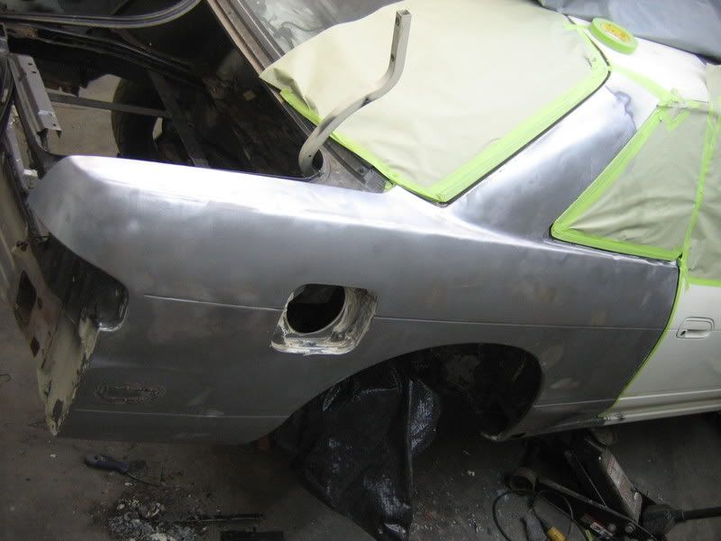

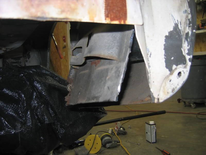

anyway, to answer questions, the rust has been fixed by combination of cut and weld, and the sections that aren't as bad get stripped to bare metal, ground smooth, and coated in POR-15, great stuff.
hope this gives you an idea, it gets a bit messy, using a chemical based stripping agent, you will need to let it sit for about 15 minutes to penetrate, then scrape, usually I repeat this process 2 or 3 times before it will get the area to bare metal.
^ here is an example, I didn't even really think about rust lurking under the surface, I knew there was enough here and there, but when I stripped this area, I found 2 spots, you should be able to see one here, look near the lower right of the picture, there you go, see that? CANCER! after stripping an area I use POR-15 and make 2 coats with that, which turns out something like this (on the radiator support)
nice huh? after that you can lightly scuff the surface and spray a rubberized undercoating on it, atleast that's what I like to do to areas that are not inside the engine bay and visible when the hood is open, which turns out looking something like this (driver side floor pan)

thought I would post an update of the progress I made last weekend, at some point the whole car will look like this.
above: no the jack isn't touching the car, theres a jack stand on the rear sub-frame.
below:removing the flange cleans up the lower part of the quarter panel, atleast looks better to the eyes,
below is the end result of cutting away, tho not the final product, it will pretty much look this way when it's finalized.
