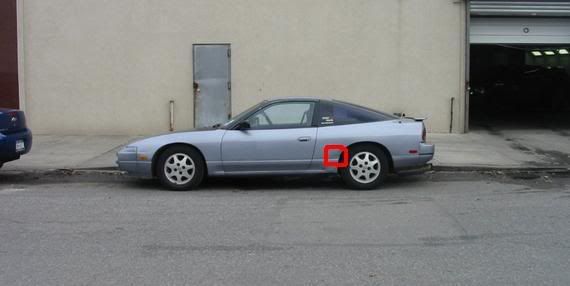

how would i get inside the 1/4 panel with that other metal panel in the way? and how would i get to a dent right here (not my car just circled the area where the dent is) this one is one of the creased dents

rage is all i use. right now im trying this new stuff. Not so good on the sanding like rage. As for the dents do as what kouki monster said for the dents. Depending on the location and how big the dents are. You might need a pick/spoon, or just a small comma dolly. You can oftern push them out with light taps from the inside. The metal will want to come out by iself but at the same tight taping ur hammer lightly around the dent. Working your way in.
i belive if u remove ur panels inside ur hatch and rear seats. You should be able to acess it. If not then u might need a stud welder/ or a mini suction cup. If u decide to go with the stud welder than be carefull not to burn any wires inside.

the problem is i cant really get to the dents because inside the 1/4 panel there is another metal panel in the way

then you have a few options
1, you need a welder and a drill
drill holes stick something in and pull dent out
weld hole
or wipe hole with filler and watch it come back through in a month
2, fill it with filler. all the way with filler. just keep wiping and sanding wiping and sanding
(lots of filler will crack and fall off eventually)
3, this would be the proper way(imo)
rent/buy/borrow a stud welder
weld stud on, pull out with slidehammer while tapping edges of dent
done

well.. i plan on pushing the roof dents out.. but the dents on the 1/4panel are all small round shallow dents(all from the previous owner.. idk wtf they were doing)
the only problem is the creased dent near the wheel well..
