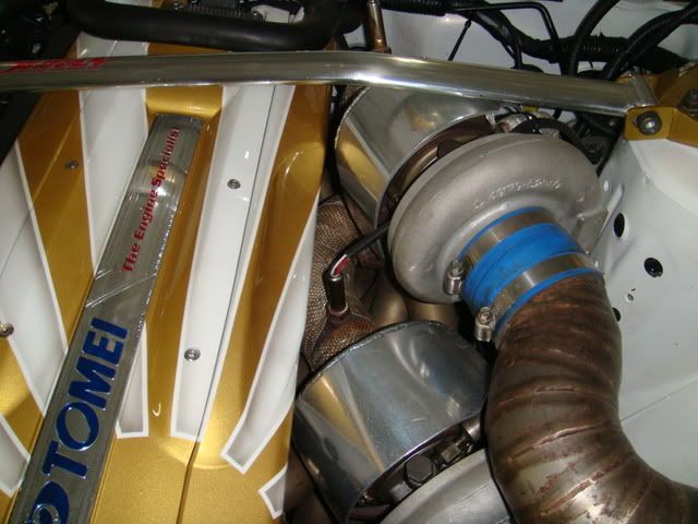

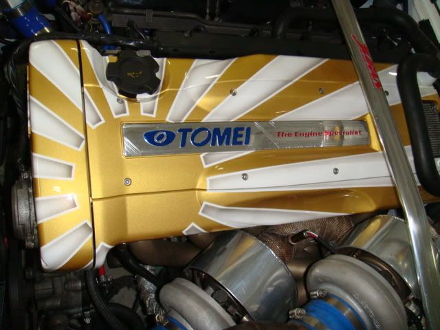

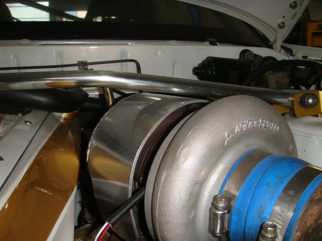

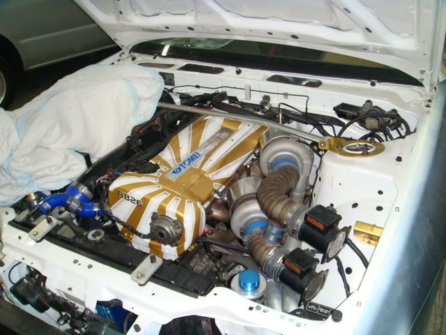

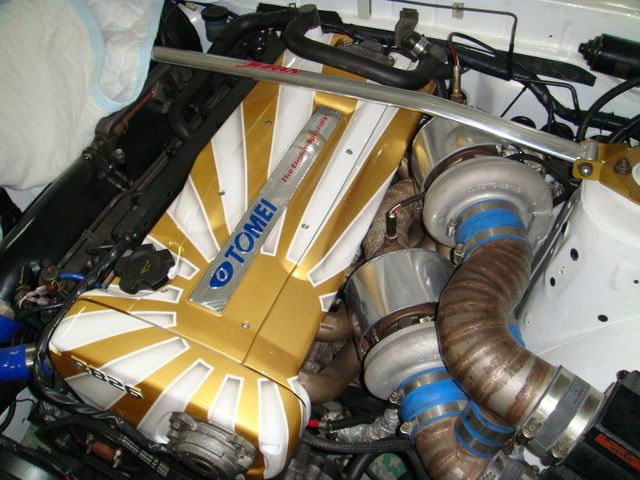

Buddy out here with an RB26 in his S13 just went Greddy twin TD06-20G setup...here's some shots if you're wondering about clearance. The only thing is this is on a RHD car, steering shaft was not an issue for the DPs.

You can go as big as you want, problem you'll have is finding a manifold to support the turbos and having enough space for it. You got the strut tower to worry about and then you have to figure the downpipes to clear the LHD steering shaft. Biggest reason folks go big single turbo is due to the lack of room.
