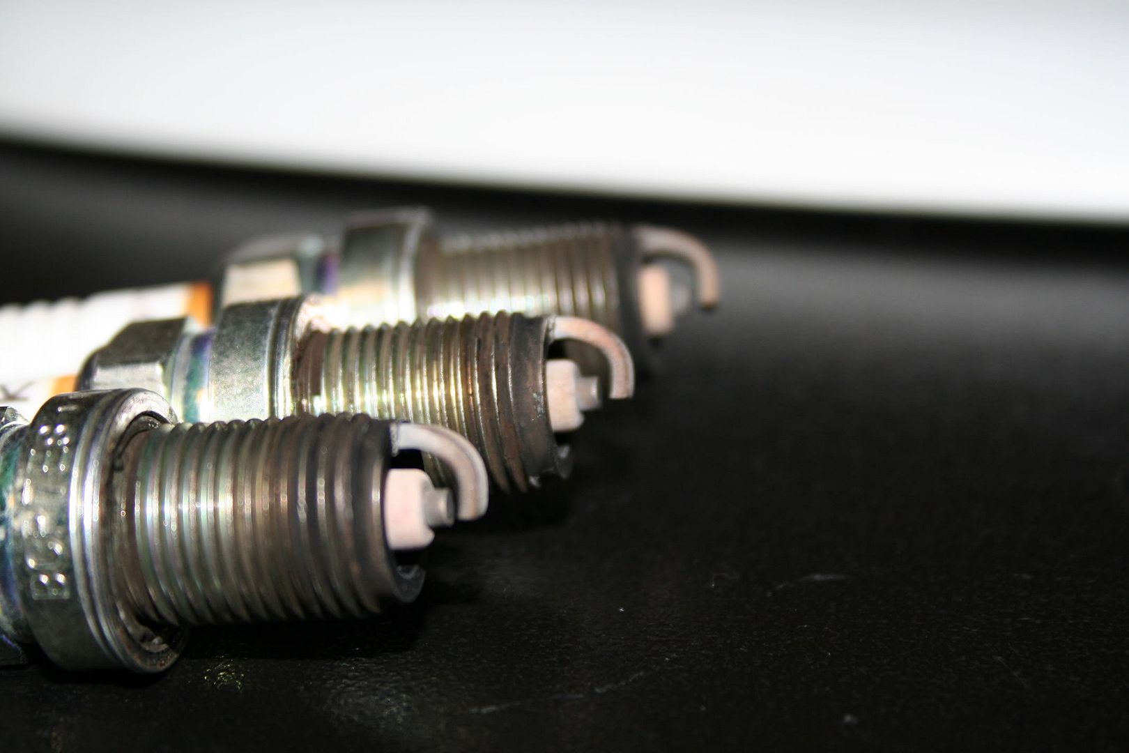

i agree with what autobacs said. you can't rule out the plug wires or something in that area. do you have a a/f guage to tell you that you're leaning out? or are you just going by sound? if by sound change out your plugs, wires, and cap and see if that works.
well i pulled my plugs repeatebly and the electrodes appear to be lean? here is a picture of them
Spark plugs
im not sure of my duty cycle , i cant imagine that a t28 at less then 15psi would run 72lbers out. i ordered a wideband today it will be here tomorrow. how can i figure out my duty cycle?

ok, i guess fuel and tuning wasnt the problem, because i installed my windeband today (aem) and my afr are good, 11-13s at anything over 50% throttle, idle and low throttle is around 15-17.... im starting to point the finger at ignition?

i thought it was lean because of the popping and the plugs but i got a wideband and its not running lean
