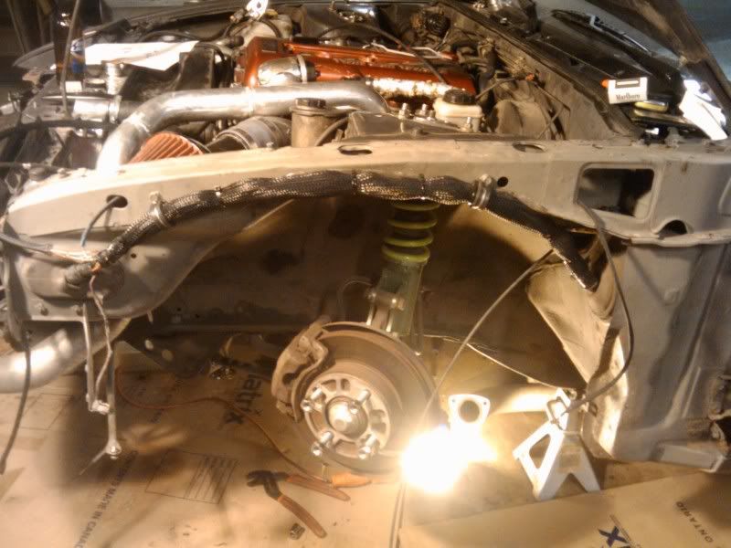

Heres mine, I pounded the seams flat with a sledge after bending them with pliers too it worked well just take your time and get them flat.

Originally Posted by nismosx View Post
do you have a write up on this ?! i cant find anywhere
You basically go under the dash board and find all the plugs for that harness and disconnect them. You pop them out to the wheel well and route the whole thing on top of the strut tower. Only thing is you have to make sure your hood wont be smashing on to the wiring. Most people will unwrap the wiring and kinda flatten them and then rewrap them flat with electrical tape.

I would highly suggest Adel clamps over zipties.

I tucked mine like SANDWICHED in between the fender and the chassis, with a tight ziptie, that sumbitch isn't going anywhere.
^^^ did the same thing and works pretty dam good for me. Easiest thing you can do.

I searched and Yakota I don't wana sound like a dumbass, it does sound simple like 'disconect everything' then reroute.
But can you be more specific?
I want to move everything possibly under the dash. I have a cut up dash and alot of interior wiring removed.(stereo, etc... -- stripped out car).
I rather move the harness under the engine bay than have them in stock location for fenders anyways...
I would like some more pix or write up I am guessing I'll have to take the fenders off to do this... I tucked mine up with zip ties and hammered this seam to push it up... but i am trying to alos get rid of non-essentials on the car and i figure harness not being hidden under fenders is one way to go to track down all the wiring...

Just finished doing my friends.
We depinned the brake master cylinder harness and the wiper return box and moved them inside.
It makes the harness thinner. Then used some split loom to try and make it as thin as possible so the fender fits better.
And P clamps are more reliable than zipties for holding the harness.
lok is offline   Reply With Quote

you might still have rubbing issues in the back, i did the same but with steel zipties. No issue there
I'm going to remove my smj and maybe depin it so i can fit it through the firewall or something.
