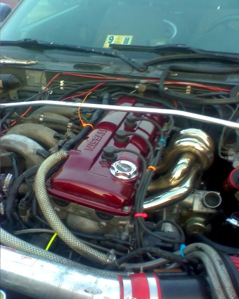

here's just a cell phone pic of the new setup... since i had to replace the oil pump, i sold the gt28r and installed the gt2871 gt28r style...
