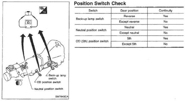

Now On 95 S14 which connector is the ''inhibitor'' switch? 1st or 2ND?, I've already jumped the 1st one....?
some write-ups say the 2nd? care to help ?

All you need to do is jump the first one on the top:
wire in the reverse sensor, and your done.
