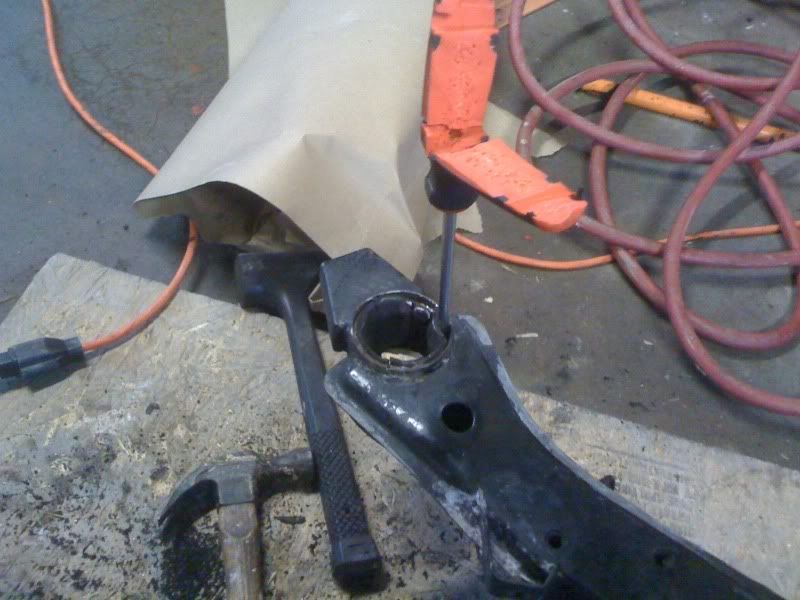

Base on my search I would need to remove two sleeves on the front side of the subframe. But after removing both. It seems like I would need to remove the third bushing? The nismo bushing seem like it just to tight. Please see pic attached. The first pic are the sleeves that I pulled out the second pic is the sleeve that is in question. Again thanks. I tried searching but no luck.

I have no experience with Nismo Bushings, but if you are swapping say PBM solid bushings, you need to cut the collar out.
There is a metal outer collar, rubber, then inner metal tube.
@#%k that burning non-sense guys do around here, saw-all around the bushing, dropping the center tube out, then saw-all the bushing collar, pound out with hammer. Takes like 30 minutes.
Just don't use a POS screw-driver.
Finished product -

you still have a metal sleeve from the looks of it
you have to remove that too
use a hacksaw, to saw a slit
