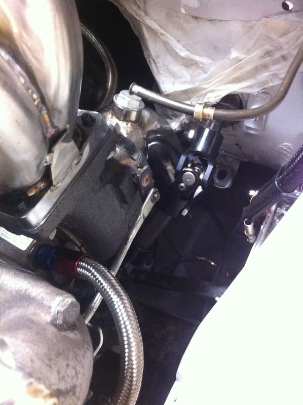

Since the steering shaft comes out of the firewall at an angle, the further back you move the engine the more clearance you'll gain. Hard to to explain but maybe this picture will help.
Also, don't know if this applies in the case of an e36, but for e30s sr20/ls1 swaps its necessary to run some sort of compact steering shaft to get enough exhaust clearance. Should be possible since there have been a few rb swaps done in lhd e36s.
Edit: Found the pic of an sr20 down pipe clearance on an e30. If e30s with their tiny ass engine bays can make it work it should only be an issue of engine placement in your case. E30s can get away with using the stock pan since their bay is shorter and the crossmember sits further back.
Anyways, good luck with your build.

yea they sell smaller steering shafts, but all the ones i have found are hella expensive. so im just gunna stick to top mount easier to maintain and such.
and the reason i set the motor in the way it is was to set most of the weight over the wheels to have better forward grip, i know people will say it dosent make a difference but it really does with the e36.
yea i have a friend that owns a company that built a rb26 powered e36 and they did some weird stuff to make it work. and thanks for the help and the info and impute i really appreciate it
