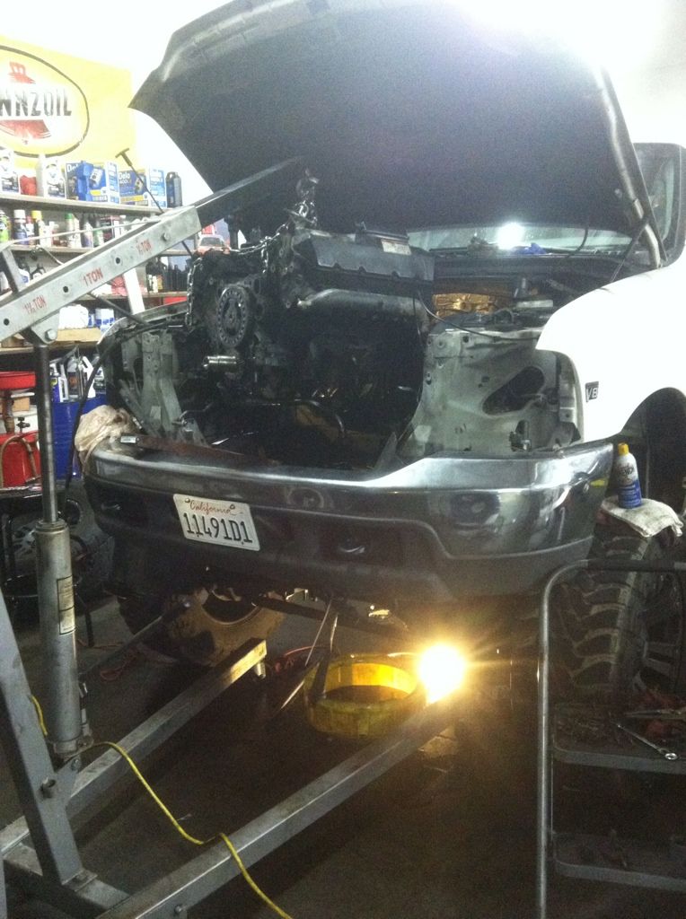

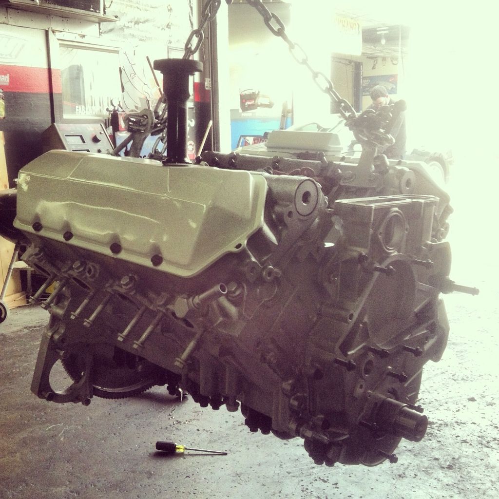

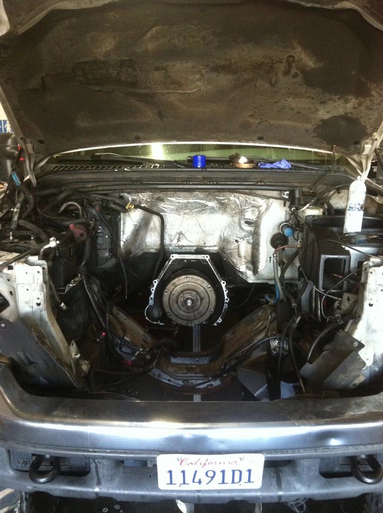

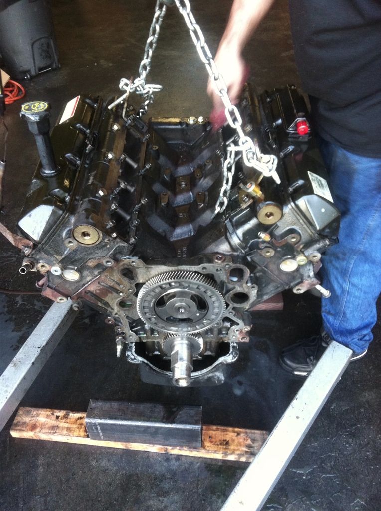

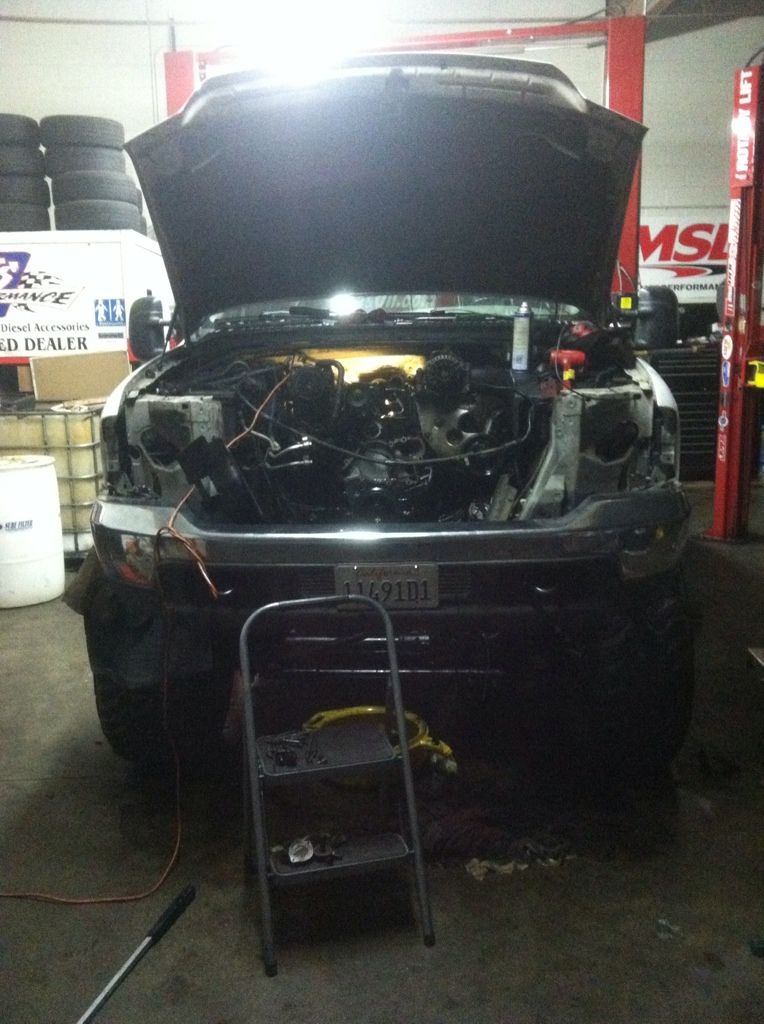

Anyway, one of my good friend's diesel truck power stroke 7.3 engine need rebuild with over 300,000 miles. Also i found many broke parts like crazy! Start with oil cooler mount on front cover have broke cause oil leak anywhere engine bay really bad!
My friend said whatever it need fix or new parts then go ahead fix it no matter what price. then i recommend him rebuild engine. he said sure. i pulled engine out ...
Power washer clean all of dirty out
time rebuild! before rebuild
after rebuild
My first time rebuild diesel engine pretty interested different than gas engine. Anyway i still wait for ford dealer sent me brand new transmission and turbo and more parts.

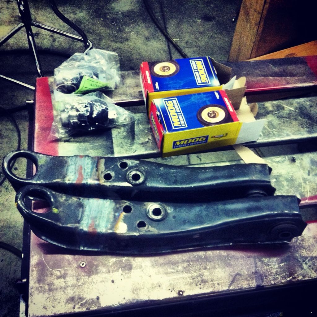

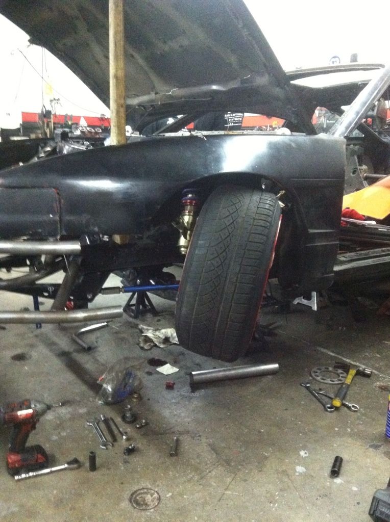

back to my build car. i don't really work on car much but i have to make car back to on rolling because i need it move to park so i can build my brother's crappy honda for swap engine.

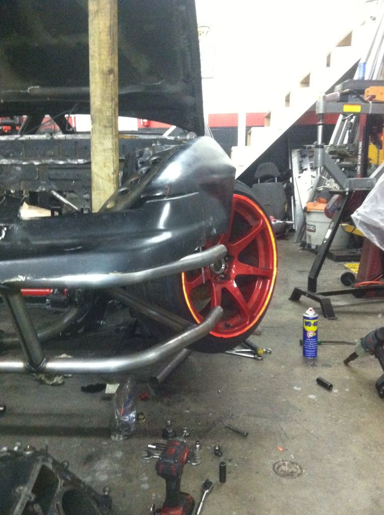

i order MOOG front ball joint
with 25mm spacers good for Rocket Bunny body kit or fender flares
2 inch clearance between tubs and wheel
I know that i still need more work on front suspension.

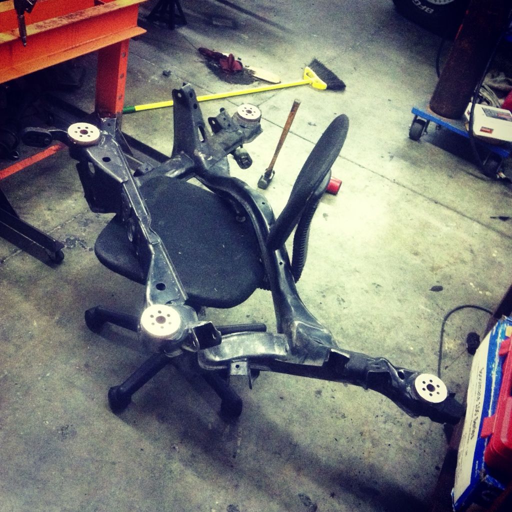

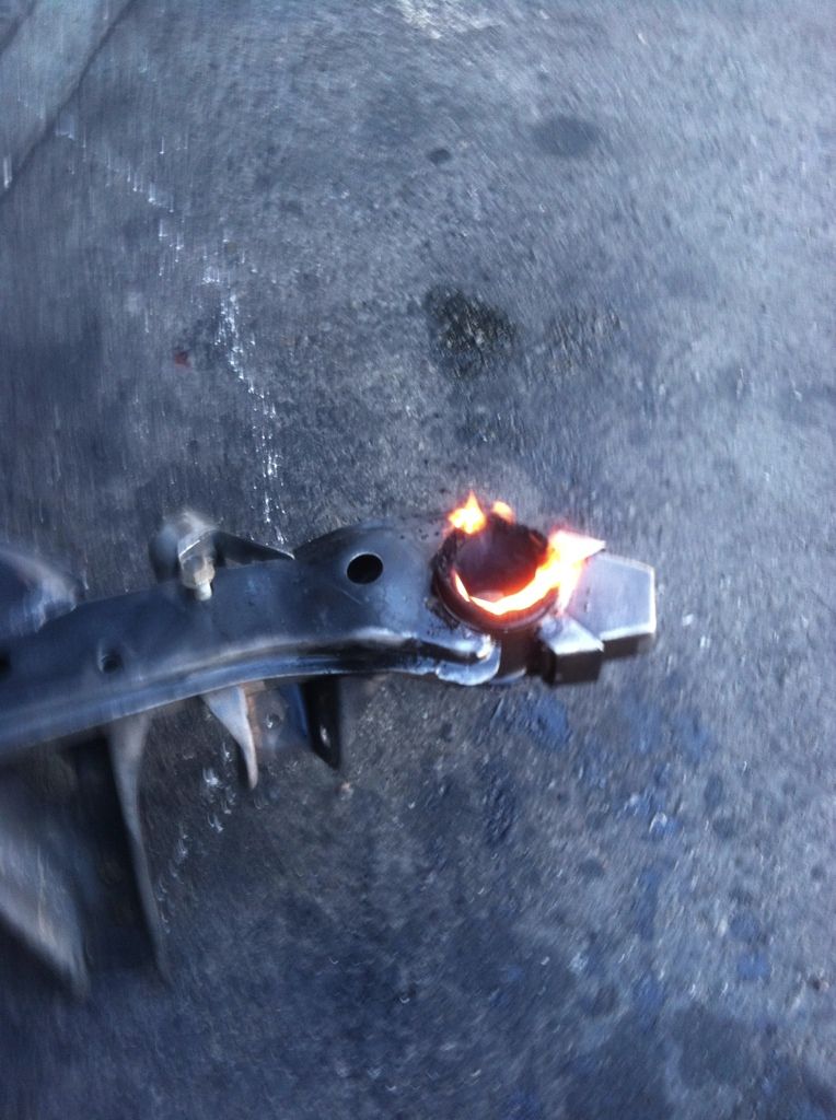

remove rear subframe bushing and installed stance solid
why not open gap vent for smoke come out of tail.

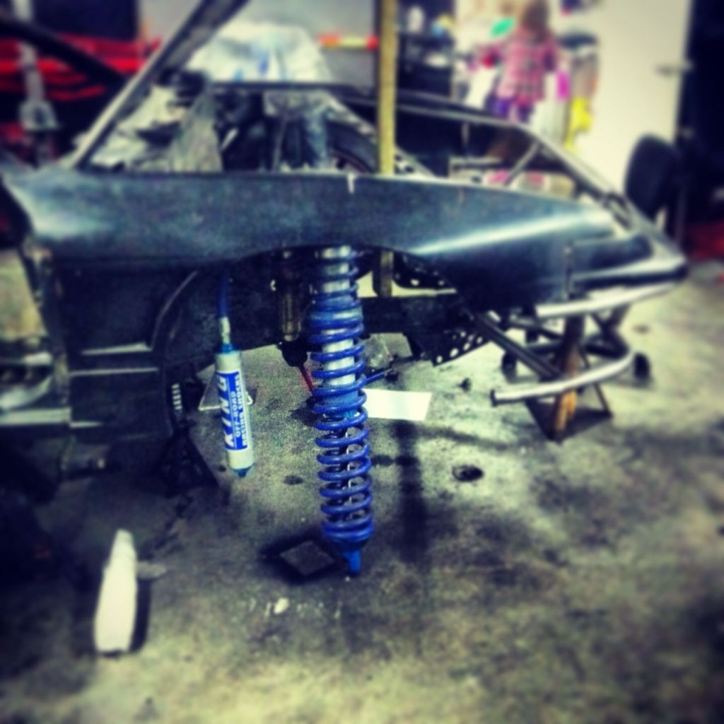

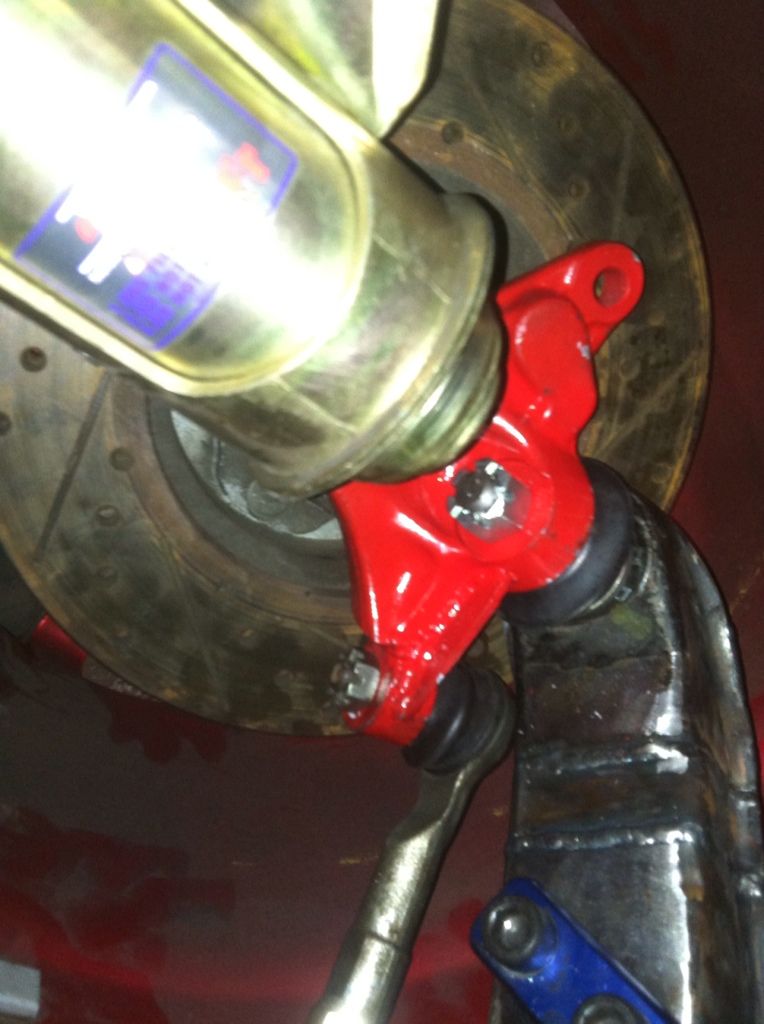

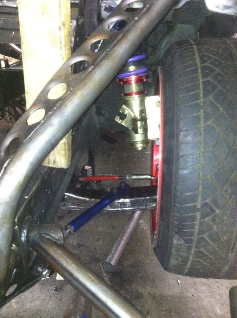

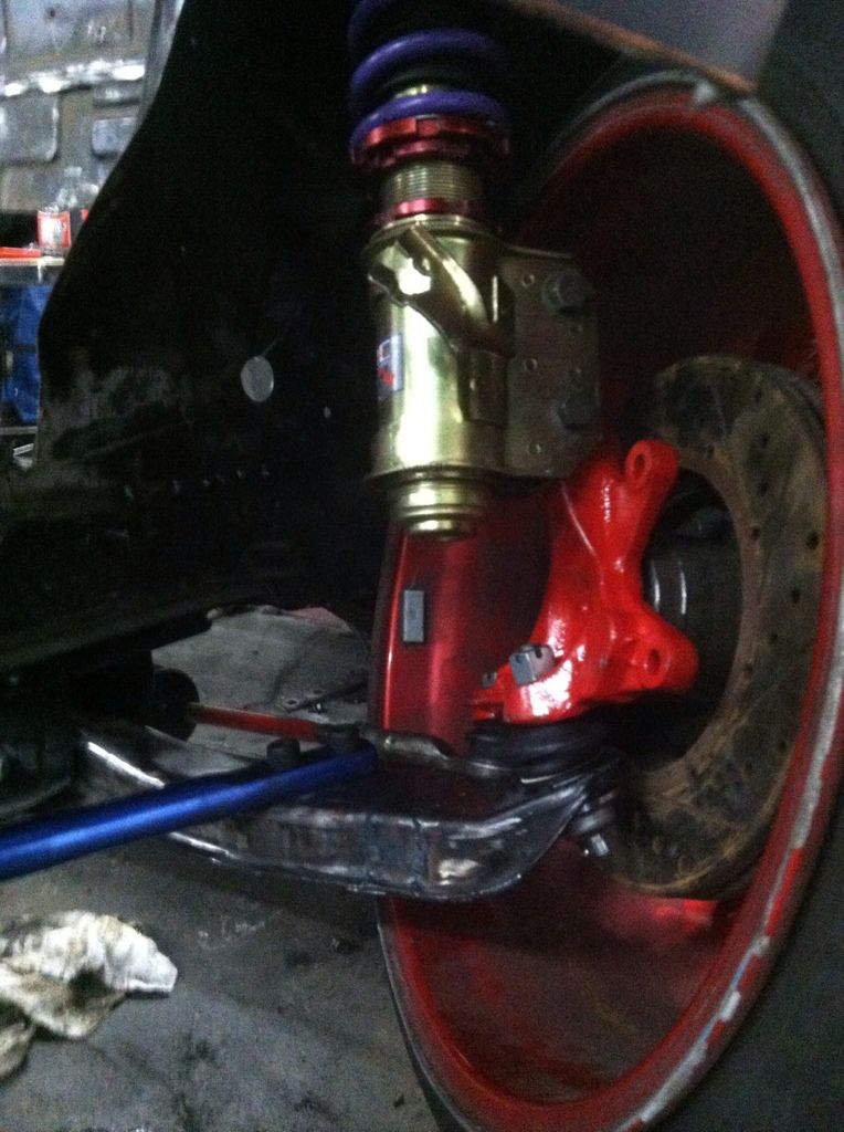

Install new coilovers! no joke! ha

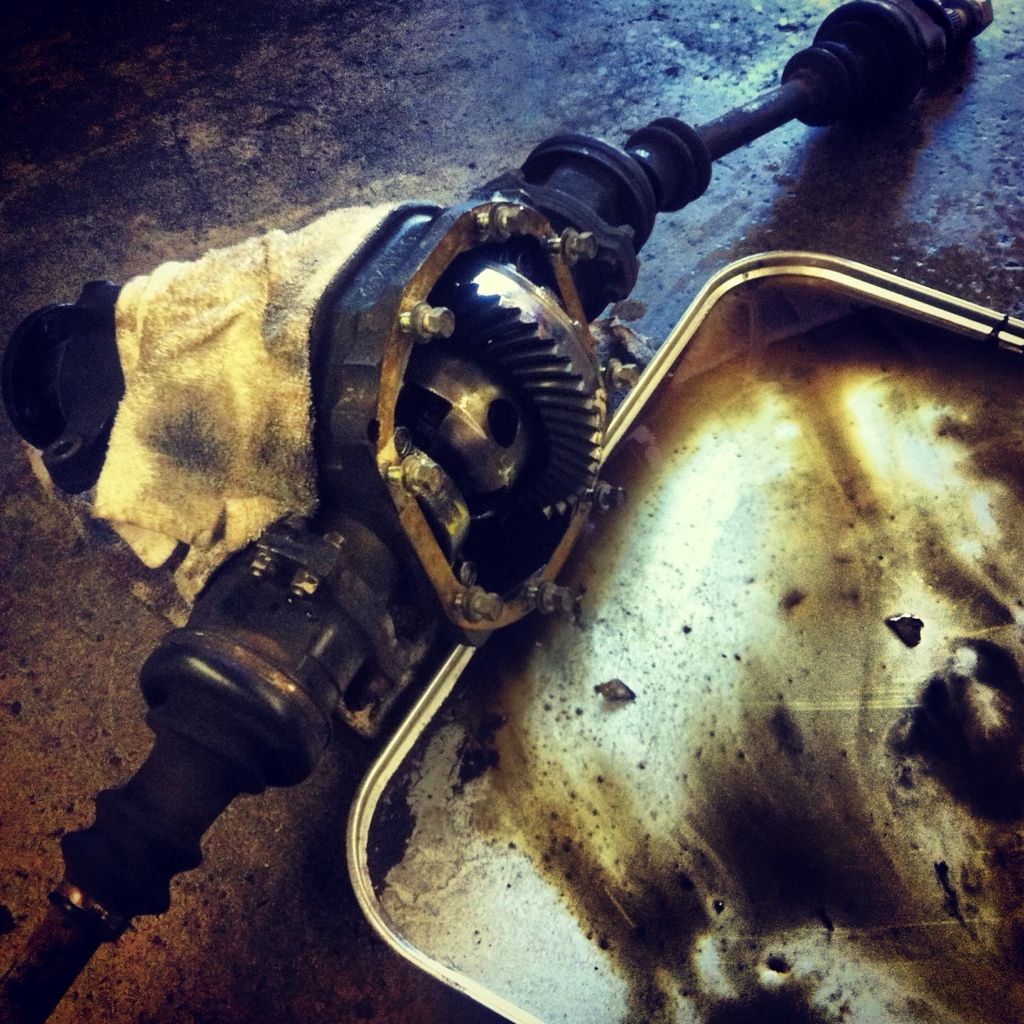

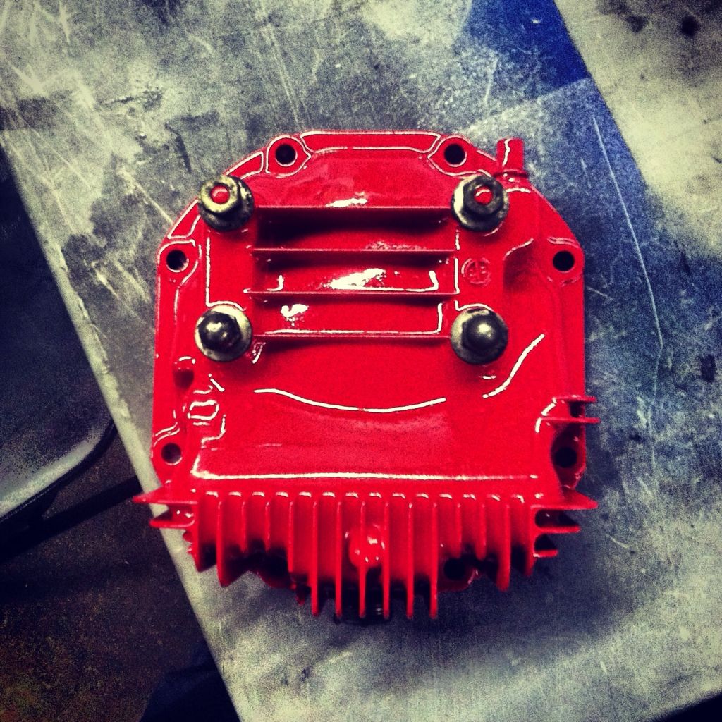

I take diff cover out and see which vlsd i had. from what i see i have j30 vlsd that number 47:12... i think about weld diff or just get thinner shim which mean it would be 2 way, that true? im noob lol
hello, RED!

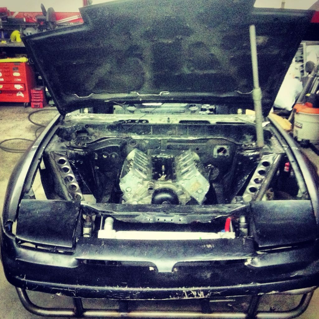

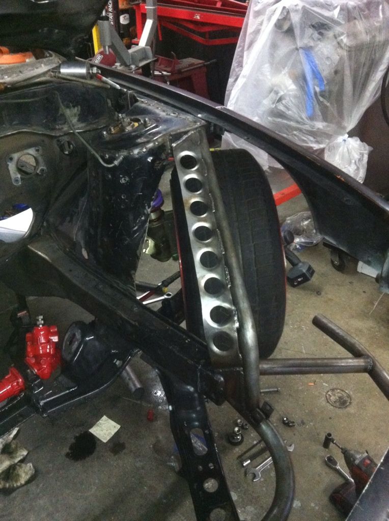

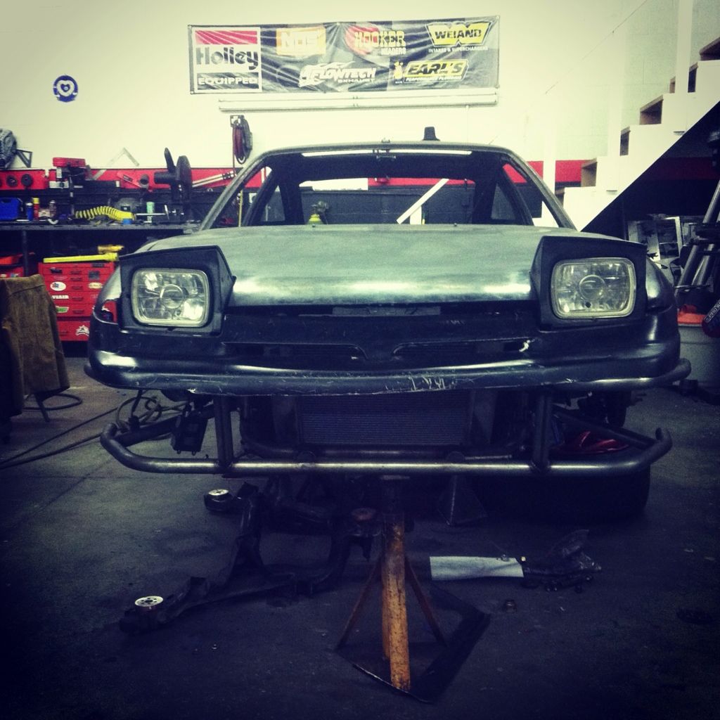

I think twice that i decide keep stock front support for reason headlight mount save time.
Break time, enjoy eat

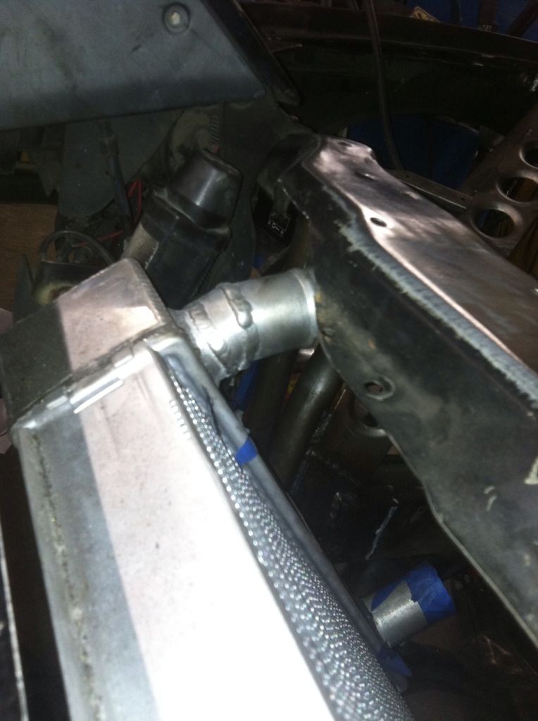

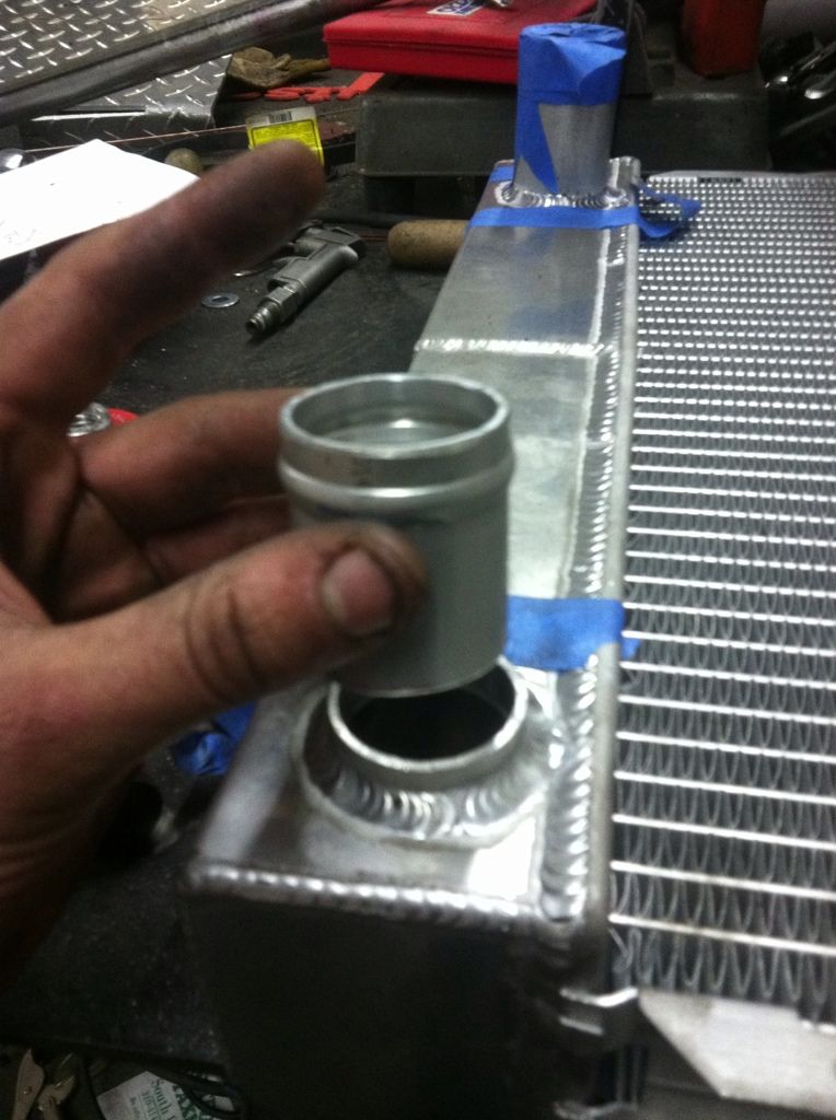

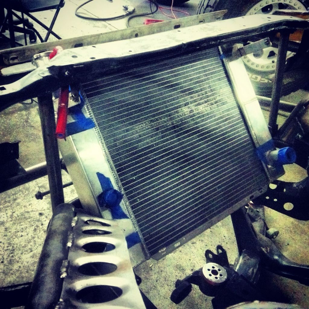

cut radiator upper become to 35 degree for clearance front support
radiator have been modify mount
finally headlight back bolt on!
that it

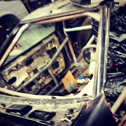

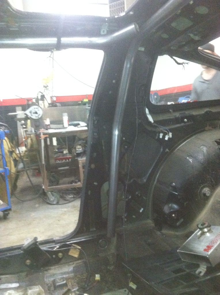

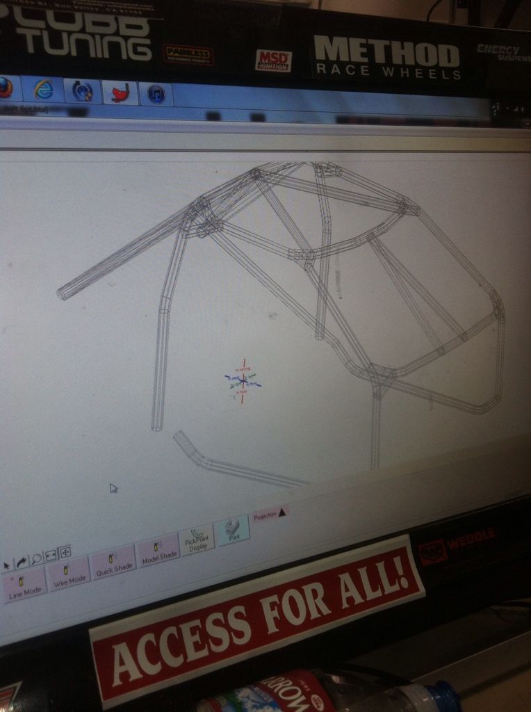

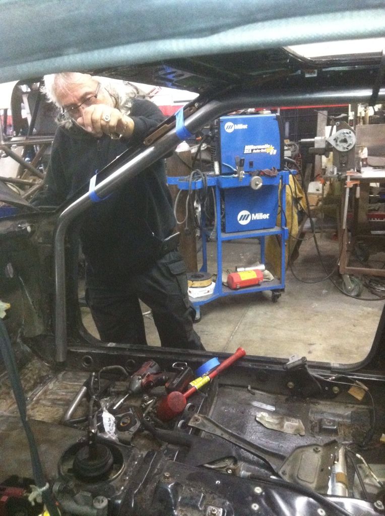

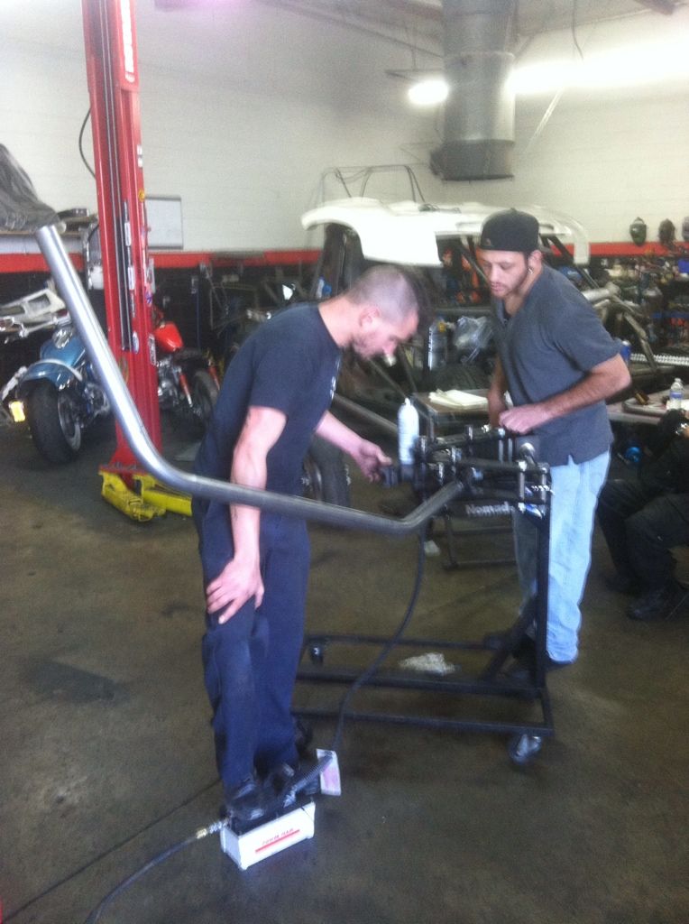

here the picture work on roll cage!
spec tubs dom 1.75x0.95
i have Bend-Tech Pro computer program and play with it practice.
they are help me the cage. left person name is Andrew who the one has talent with the cage.
this old man is one gift me the tubs 40 feets big thank to him for support me.
get ready motor drop in for make custom headers 1.75 to 3 inch
cant wait to see awesome the roll cage

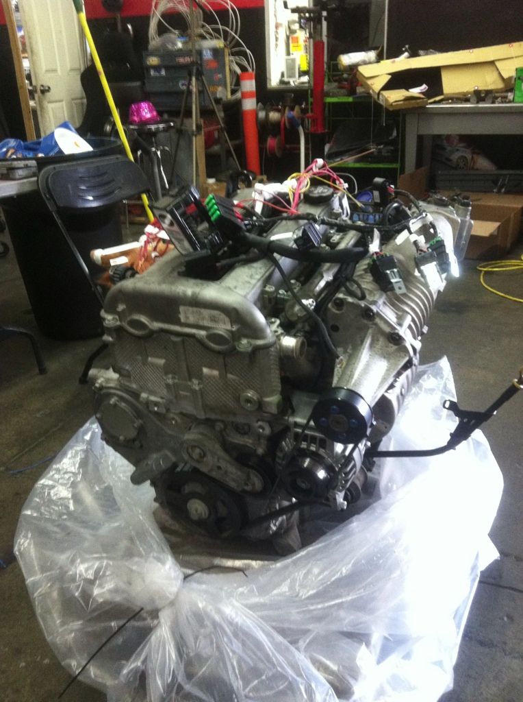

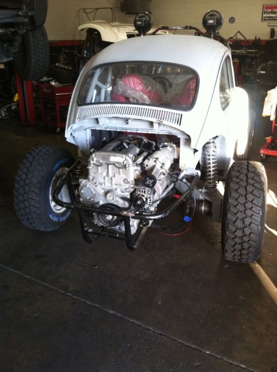

I havent update been long time. so here i have few new update.
VW Bug Ecotec 2.2 have been mounted from CBM also standalone wiring with CBM tuning PCM.

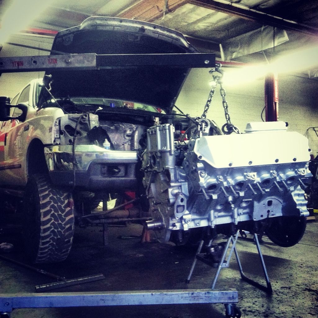

My boss got Ford Ranger with the cage and long arm travel and more but motor have been blew out so He wanted sr20 swap so here we gonna build sr20 with gt3071r turbo.
stock piston and rod short block but new arp bolts rod connecting and crank main. new bearing and piston ring.
we got BC 272/272 camshaft install on stock head rebuild

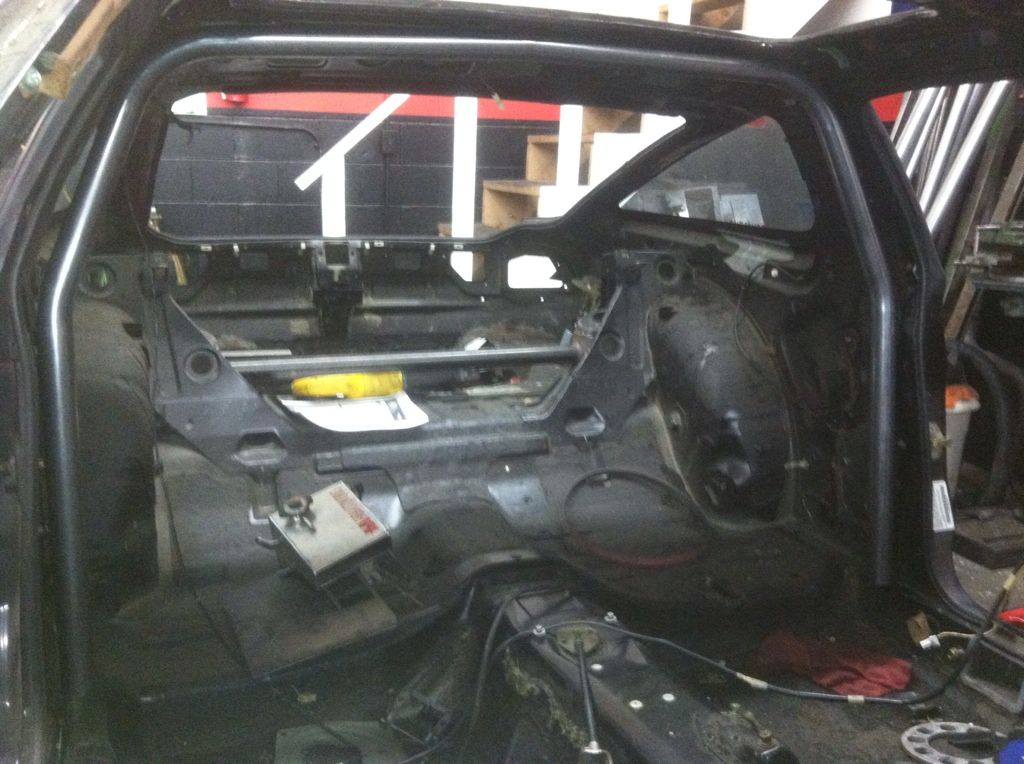

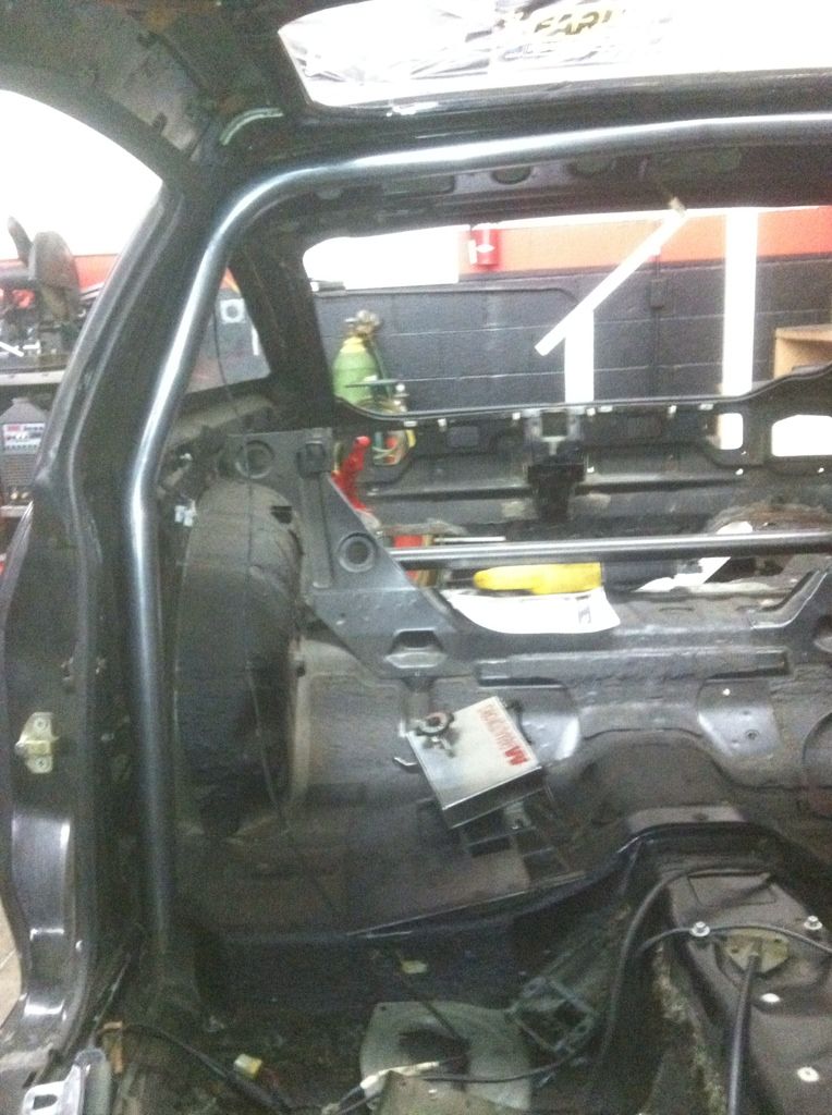

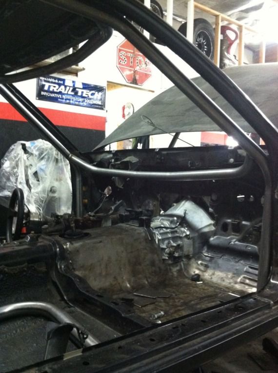

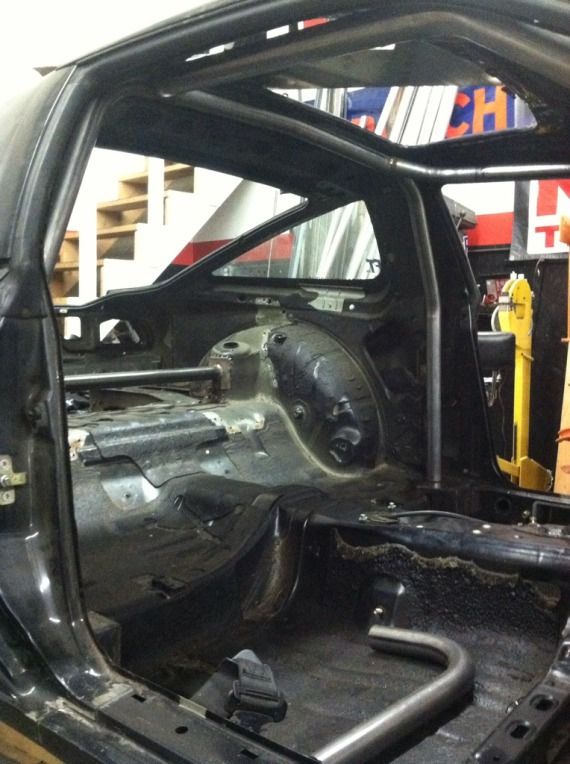

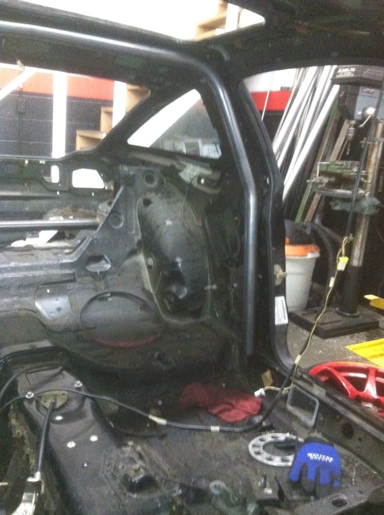

back to my project car. the roll cage almost done

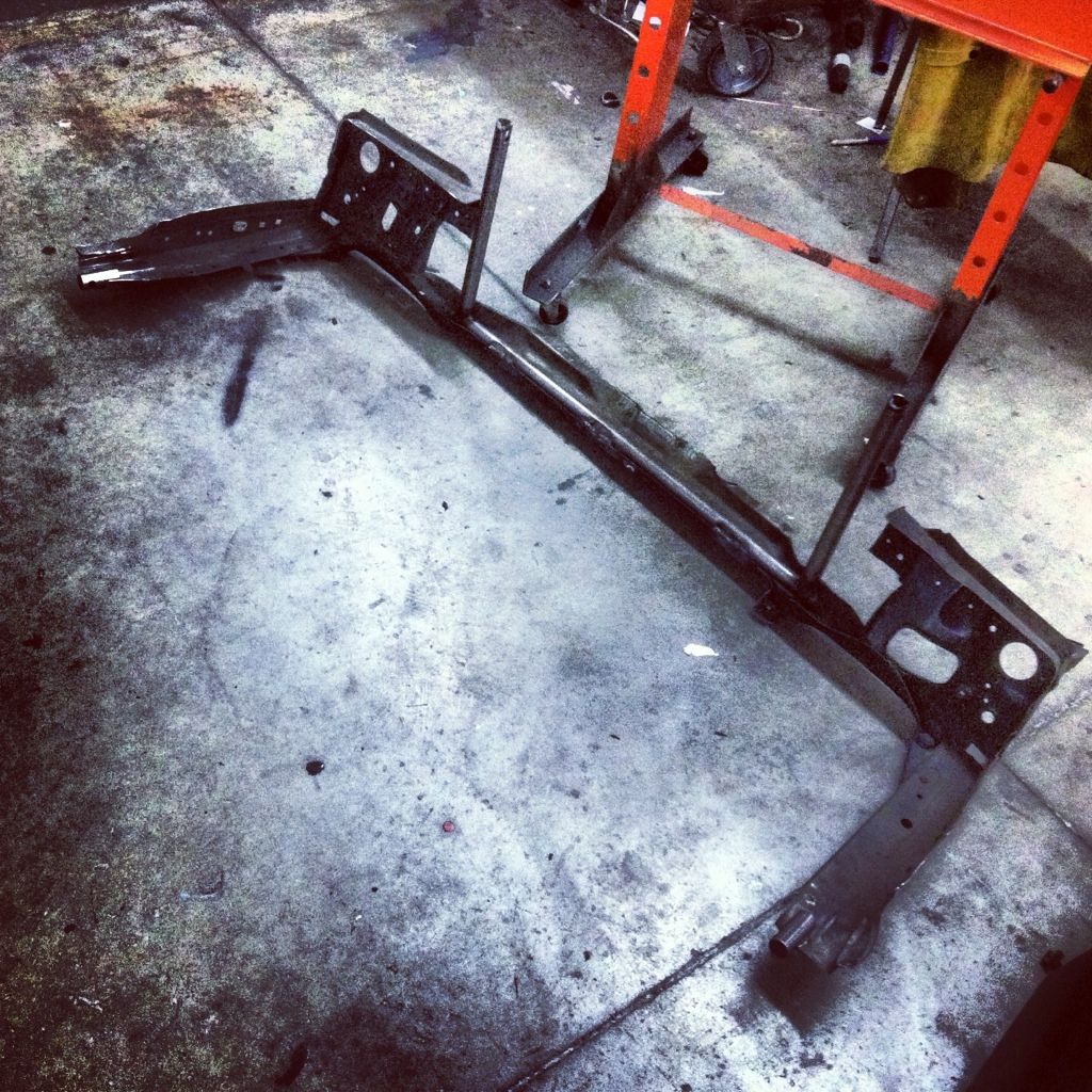

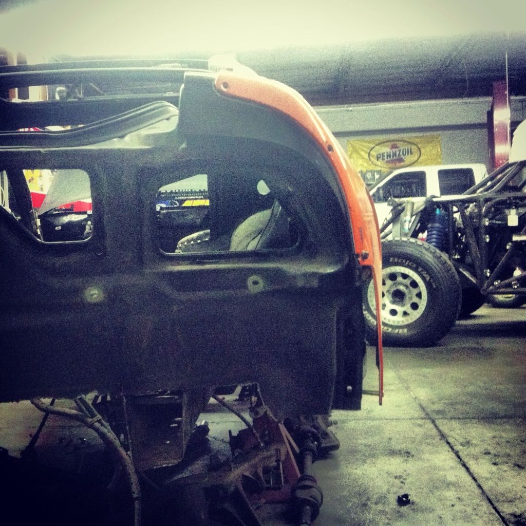

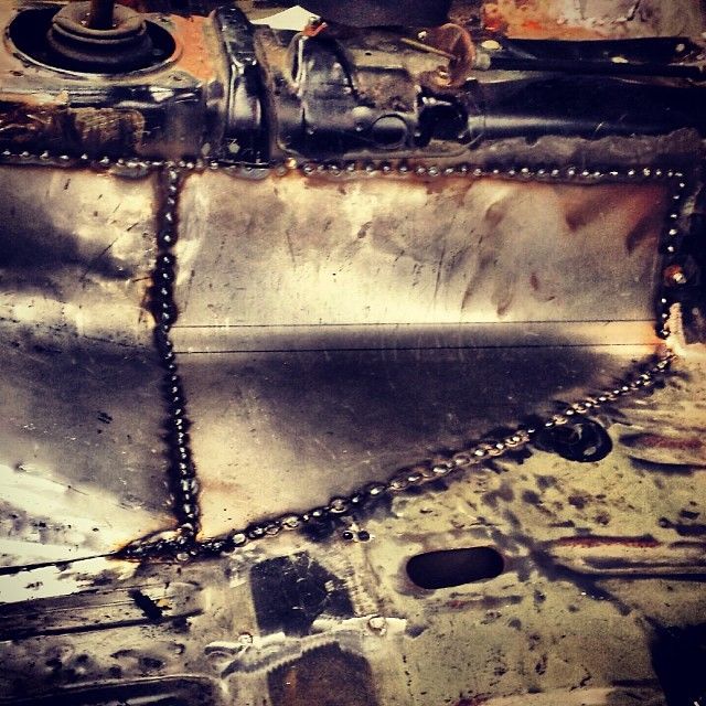

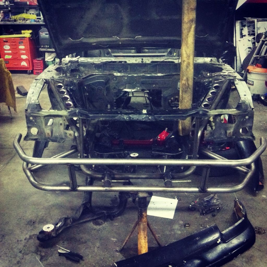

hello, i have small update build 240sx project, just do fab chassis that all but i really hope running this car before summer.

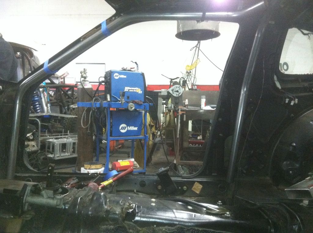

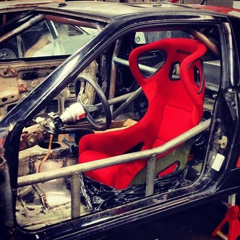

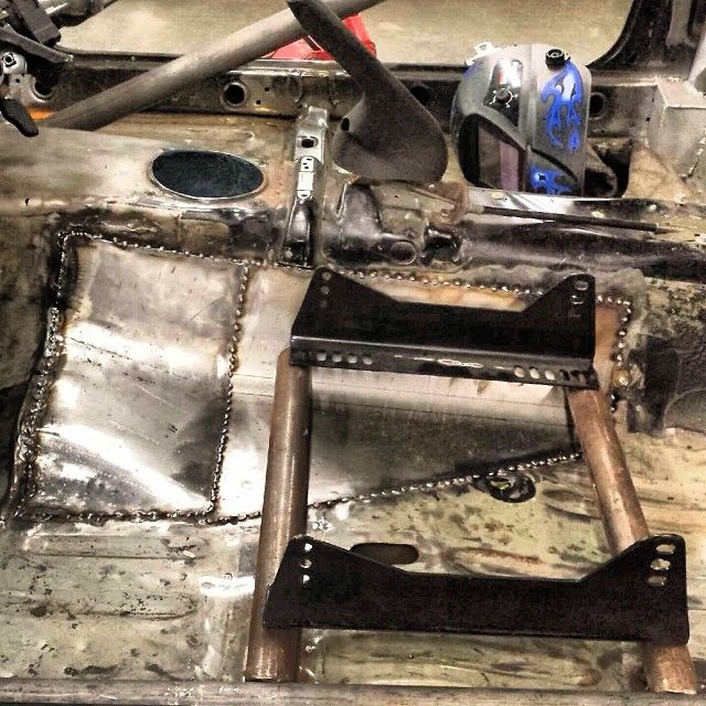

Im done with passenger door bars last night, next is rear bash bar and fuel cell mount

other more update
i got new impact gun cordless!
Roll Cage have been completed 99%
10 gallon Fuel Cell mounted!
Tonight will do rear bash bar
