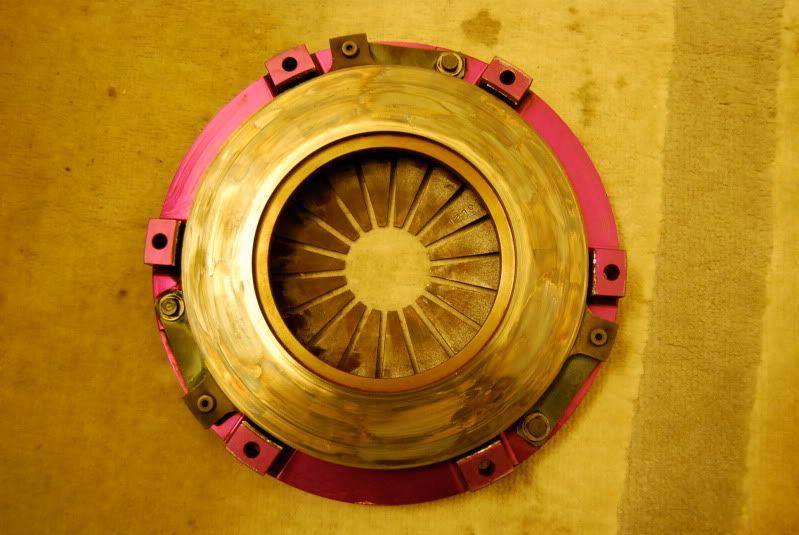

exedy hyper single sr20det, fixable?
so i bought this exedy clutch for dirt cheap on craigslist. According to the owner and from what i understood, he resurfaced the pressure plate which created more space in between, so he lost clamp force and the clutch would slip under load. Now im hoping this is an easy fix , something a machine shop can take care of. I was thiking they can resurface it and take very very little just to clean it up and maybe trim the area where the bolts go through into the fly wheel to bring the pressure plate in more and close in that space, not sure if it'll work but maybe worth a shot? Im no clutch expert so all this is based on the little bit of reading i did.
hopefully some gurus can jump in.

if you can get the specs on the pressure plate thickness, then measure your current one it should tell you if that is really the case.
It could be worn out clamps on the pressure plate, or a glazed clutch disc.

like said above,if i did make any modificaction to it, i would have a professional machine shop take care of it, I will not attempt to do any "grinding" my self.
Im thinking if what this guy said is true then i can just have a machine shop take a little off of where the bolts go in to bring it in closer.
what do you guys think?

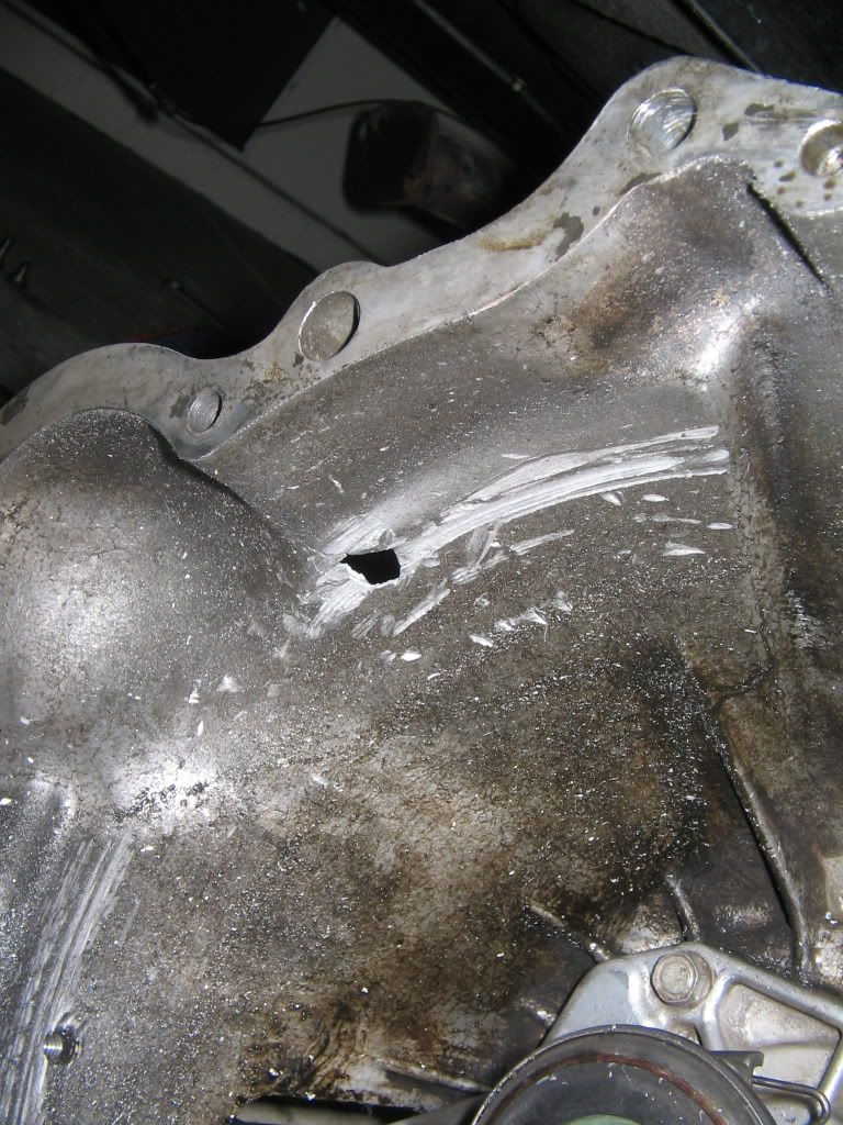

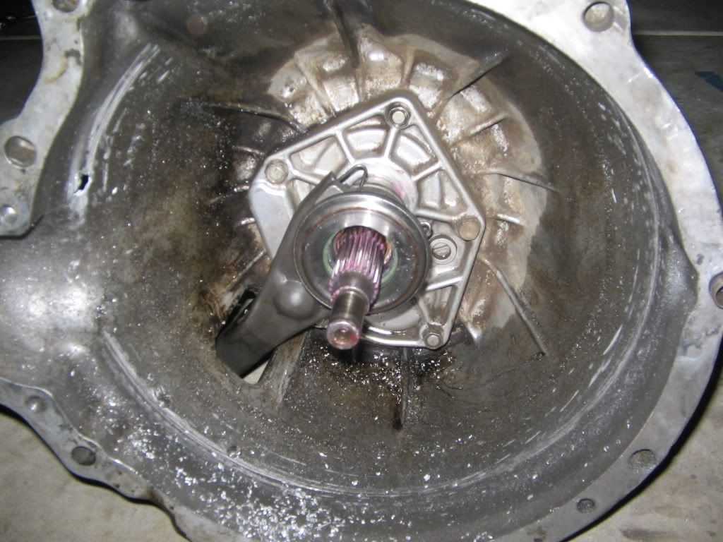

Here are a few pictures I found online of a cobra who's clutch/pp/flywheel exploded...
And here's my buddy's 510... The bolts holding the PP to the flywheel threaded out, the PP swung around and blasted a hole in his bellhousing...
Don't trust what you don't know...

just got off the phone with exedy, he said its not recommended to resurface a PP but if it is done you need to take off some meat from the bolt hole section. So pretty much they said to find out how much he cut and take that off from that section and the clutch should work fine if everything else is in good shape.
not sure about the first one or the others for that matter,
but the second and third picture are of a skyline here in Edmonton Alberta. during friday night "street racing" i had it on tape lol
poor matt but hes onto much bigger and better things now

i just asked him
"What happened was the flywheel was remachined, they didn't machine it within tolerance, it developed a heatcrack due to the metal being thinner then spec and basically the flywheel cracked. The crack was unlucky, thats what caused all the damaged, because when it cracked, it broke a spot weld on the ring gear. The motor was turning 8,000 RPM at this point and the ring gear slowly peeled off, acting like a sawblade by cutting the exhaust, frame, bell housing and starter to pieces. When all the welds finally broke, it blew through the hood."

If the clamping surface was surfaced than you will loose clamping force and durability
The usable range of travel is limited for pressure plates
The disc is considered worn out when it is .030 " thinner, if that much was removed from the clamping face, it's no gonna work. If you want to sell it as is let me know. Im making a flywheel for my next project car, and I could compensate for the changes made to That one
