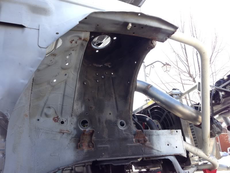

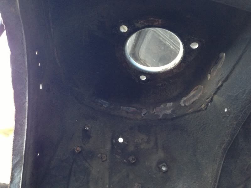

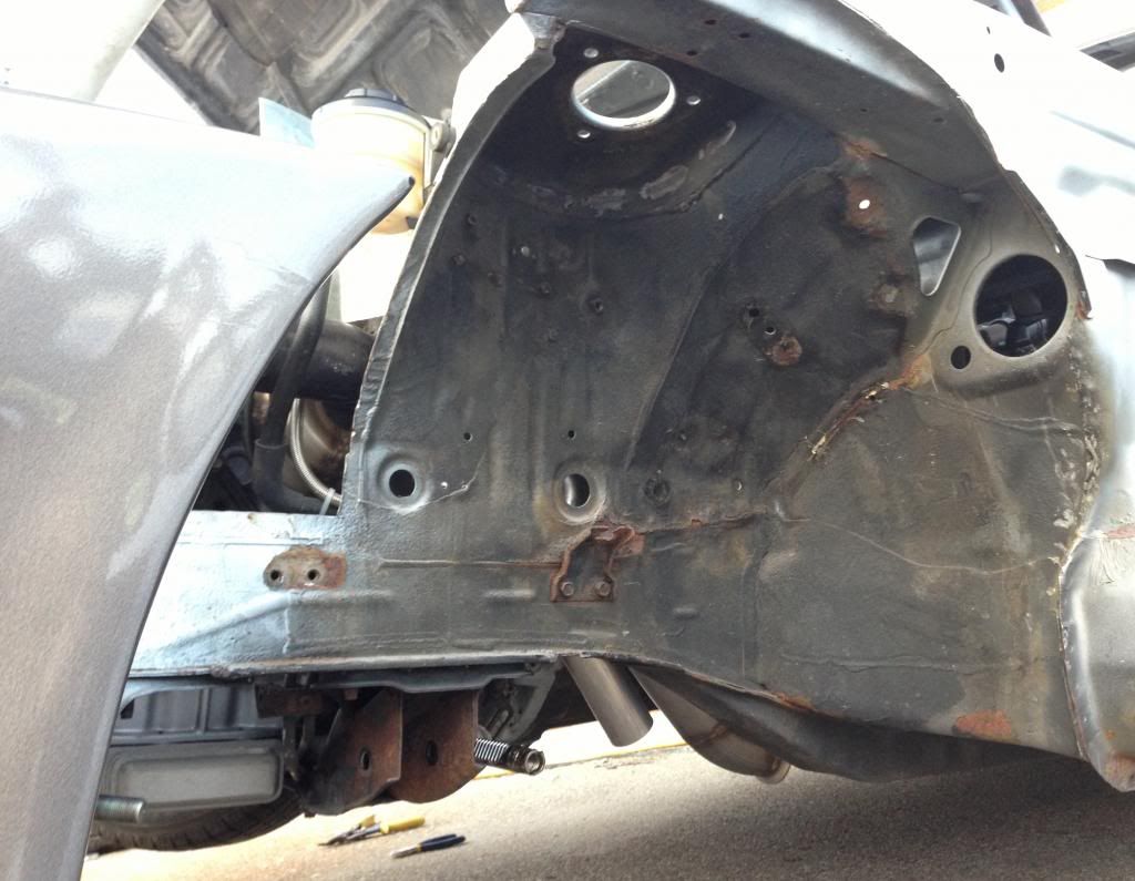

Local Performance Improvements
I spent some time grinding and cleaning the inner wheel wells and removing any surface rust. I also needed more clearance for steering so I hammered the inner pinch welds back and test fit some wheels. I still need to do this to the rears before I paint the chassis. The wheels in the pics are 18x10.5 so they still hit the frame rails and back of the wheel wells but 9.5 should fit fine.
Chad Dugan is offline   Reply With Quote

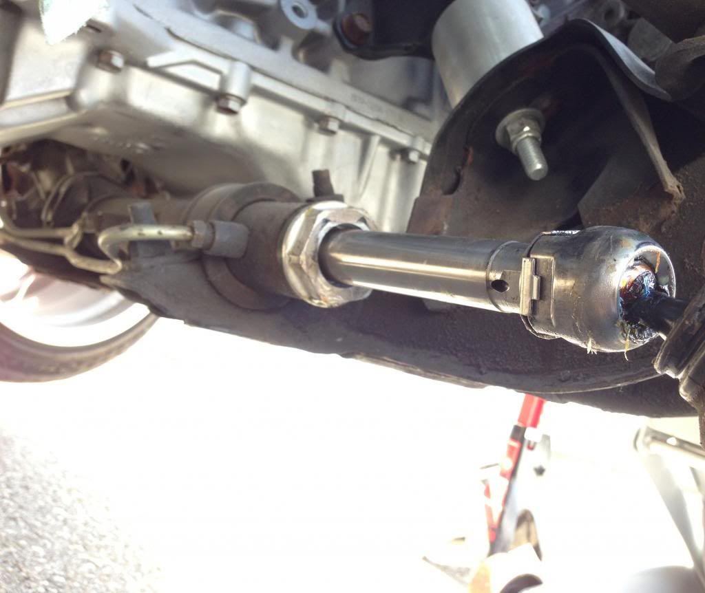

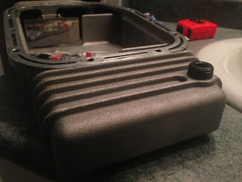

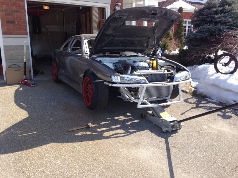

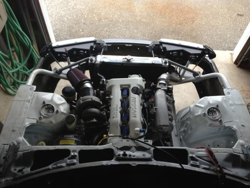

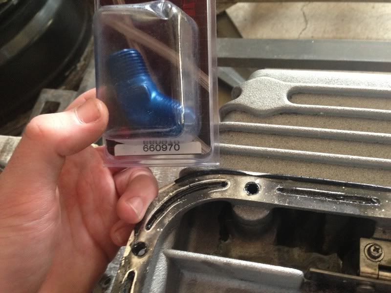

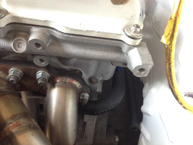

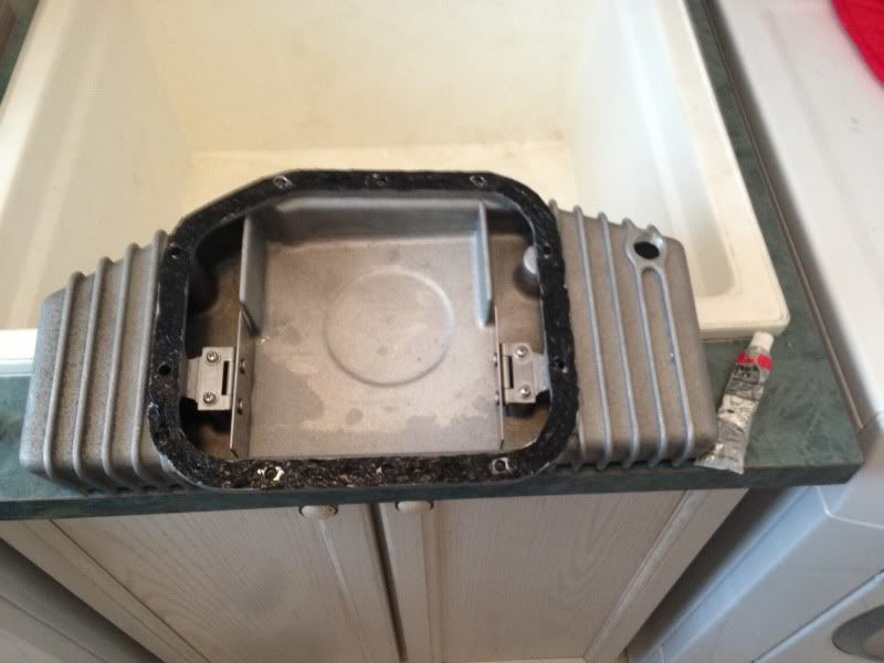

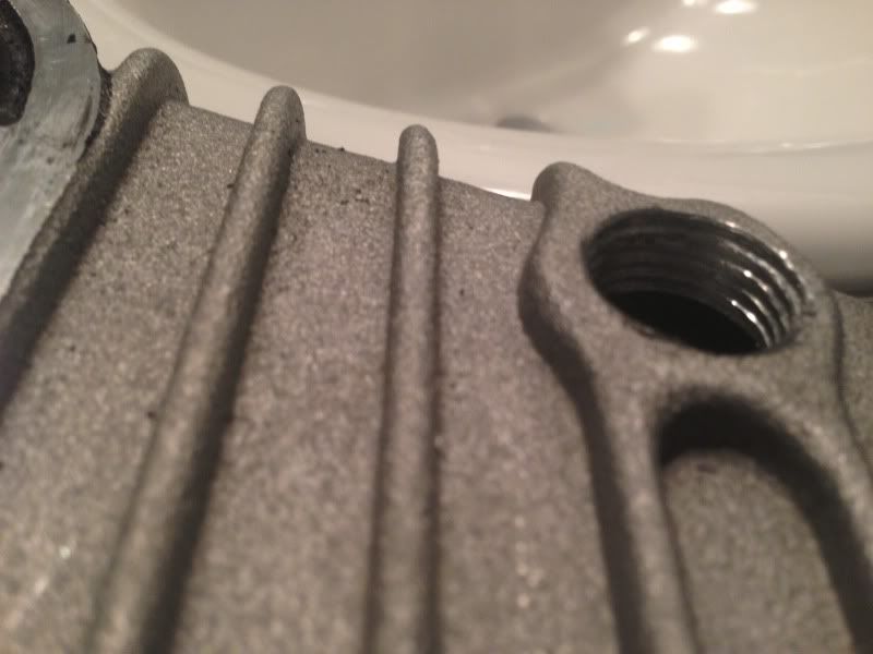

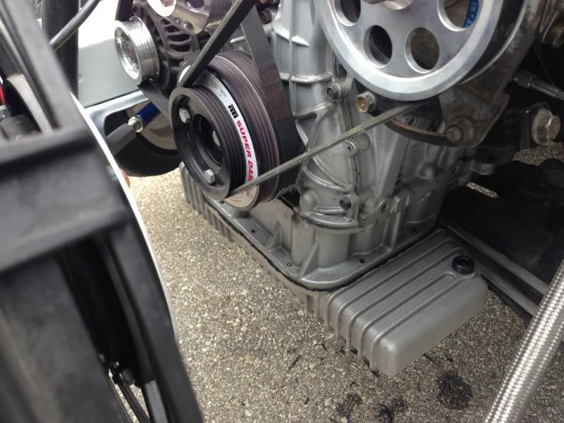

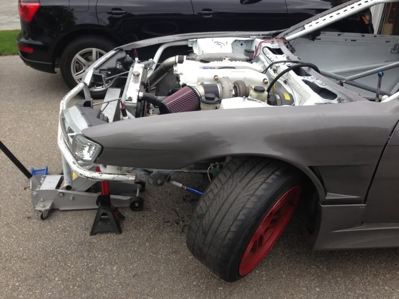

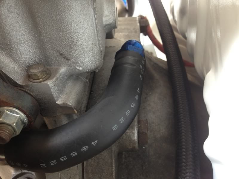

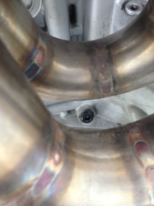

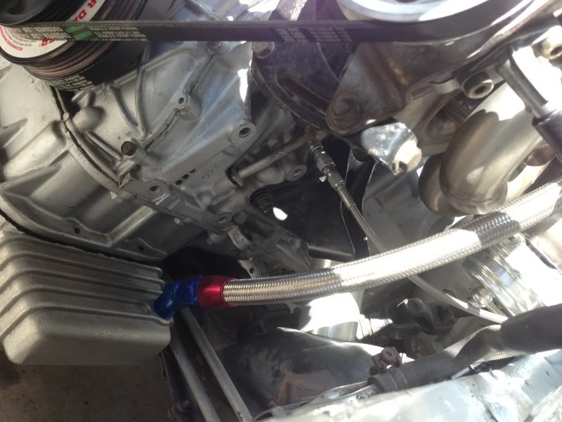

So I forgot to slip the transmission spacer on when I last put the motor in, so I had to pull everything out do that and while I had the engine out I thought I would paint the bay again since it was scratched and ruined from a brake fluid leak and tool marks. I even made new corner windows out of stronger less brittle lexan, much cleaner than before. Heat wrapped the downpipe, throttle cable, made a catch can and plumbed 95% of the lines.
-10 oil return to 1/2 NPT for the block
1st coat
I had this piece of 3'' stainless left over from my exhaust and these 3'' die cuts a friend made for me so I made this catch can. I think I might paint it textured black with a rubber coating I found.
Wrapped the upper portion of the downpipe that runs close to the booster
Cut and ran these lines for the catch can and for the fuel cell
These new windows are much more resistant to cracking and scratching
These lines come pretty close to the exhaust housing but I think I will use a smaller radius bender and tuck them closer to the master
Almost there

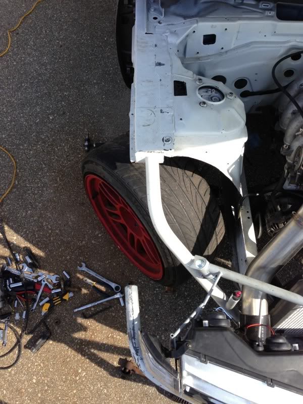

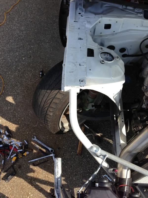

Can you pm me more info on your headlight mounting bar and brackets ?
I might be getting into the same thing here sometime and wanted a similar removable setup.
The car has tubes on the front but no upper radiator mounting brackets or headlight enclosure brackets yet.
Can you send me some close up pics of the removable area for the upper radiator mount bar / headlight bracket bar and also the actual headlight mounting rods as well ? Greatly appreciate it if you can.

Yeah ABS, I have considered changing with a friend and going this route before i have any serious melting issues.
I think if you check back a few pages there are some clear pics of when we built it but here is some to give you an idea.

I ran into some issues with the -10 oil return line rubbing on the steering column so I had to re route it up front directly into the pan. This is such a better way of routing the line, it created more room behind and under the turbo and allows the heat to escape better.
First I had to drill and tap the pan with a 1/2'' NPT
I then test fit a plug I would be using for the block since that location would no longer used
Re sealed the pan and put it back on the motor to dry
Then I had to shorten the -10 line so it would fit in its new location
I also had made a catch can earlier and wanted to finish routing all the vents so I used the existing block vent under the exhaust manifold and ran a hose to -8/barb fitting and wrapped it behind the motor.
Plugged the block
Hose to barb to -8
