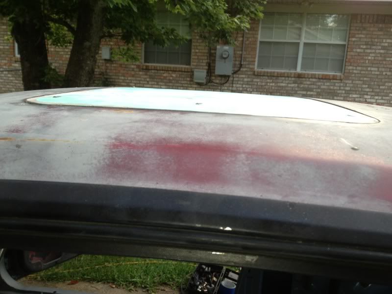

I made a delete bracket that reuses the sunroof glass.
It bolts directly to the rack mount and to the bottom of the sunroof.
Here is the fitment on the top.
DLG - DIRTYLOVE

I really like this, Im going to attempt to do this as I love my sunroof, I just don't fit in it with a helmet and brides...

The solid brackets wont really fix the issue you'd have with the sunroof, which is the fiberglass trim breaking apart, not sealing the edges and leaking like a muffo.

My plan for the bracket was to also make a sealant strip that would go in between the roof and the sunroof, creating a water tight seal on the entire piece. Also the plastic trim is not broken on mine, so basically I really only have to worry about making sure that the sunroof glass is sealed. Doesn't seem like it will be to big of an issue.

Thats the thing, the fiberglass piece is not broken...yet. Itll happen eventually. Once that piece starts chipping away, a chunk of it will just fly off one day while youre driving. When that happens, welcome to the same issue that every S14 sunroof owner dreads. You cant replace that trim, that piece holds the rubber sealant in place, so you'd have to figure out another way of sealing it without making it look like absolute poop.
Keep an eye on the edge of that trim. If you start noticing it delaminating off the glass on the inside corners, its roh-roh time.

Which is why I'm a bit surprised that no one has come up with a fiberglass piece that would work similar to the brackets I made. Would look similar to an RX7 sunroof from the outside.

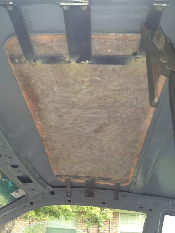

Older thread but thought I'd share my delete panel from fiberglass..
