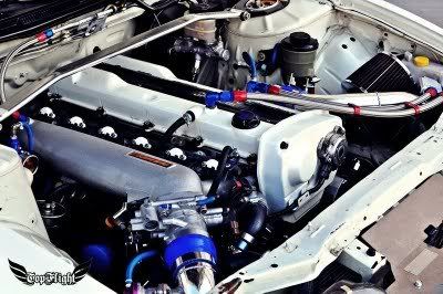

Heres mine, r33 member and stock mounts, no issues closing hood, elbow etc.
Nothing says racecar like a stock car with no interior.
What tranny mount are you using? I see yours is in an s13, which mine is too. I used an r33 crossmember on mine and it didn't work at all and ended up being a huge pain. Way to far forward, elbow was sitting on the steering rack, oil pan on the sway bar, etc.
