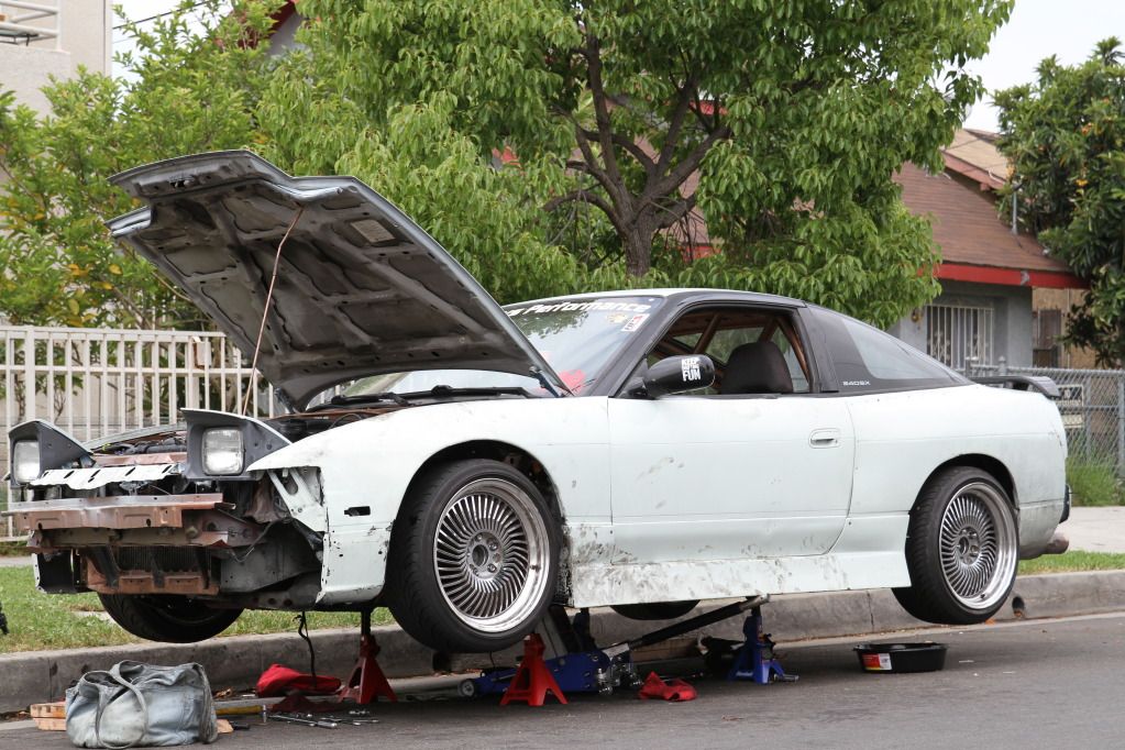

I'm not sure what you mean by "the whole swap", but I've done more than one 240sx trans swap on just jack stands. Hell, Castro has even done clutch replacements at the track iirc.
Old 08-21-2012, 10:46 PM   #12
ericcastro
ericcastro's Avatar
Location: Malibu
Age: 48
Posts: 7,033
Originally Posted by jdmRB2011 View Post
any of you guys ever dropped the trany without have to bring down the whole swap?
What do you mean? You dont need to do anything to the engine, it does make it easier if you loosen the engine mounts a bit so the engine can tilt a little when you pull the tranny off.
finishing the 4 hour clutch swap at the track with
nates help
and did it solo at my house over 2 evenings on a LA street.
put the car on jack stands!!! and use the jack to help lower the tranny!!
