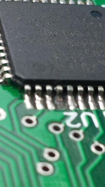

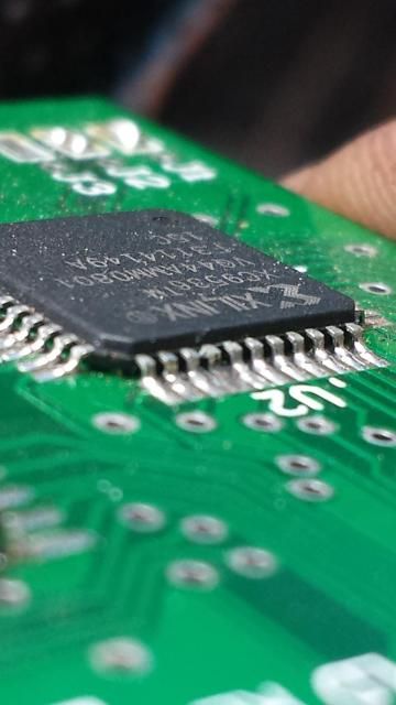

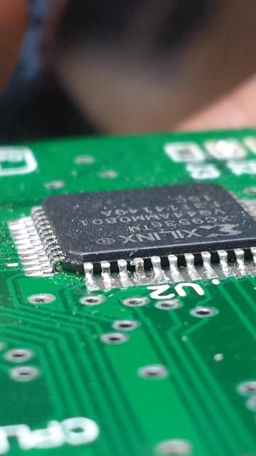

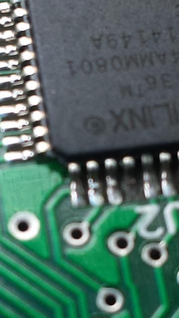

I recently checked the TPS and MAF wiring, everything is fine. Then i decided to open up my nistune and after looking at the type 3 chip this is what I found.
