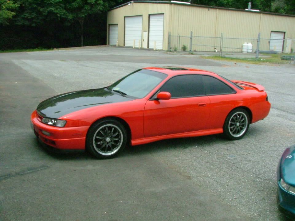

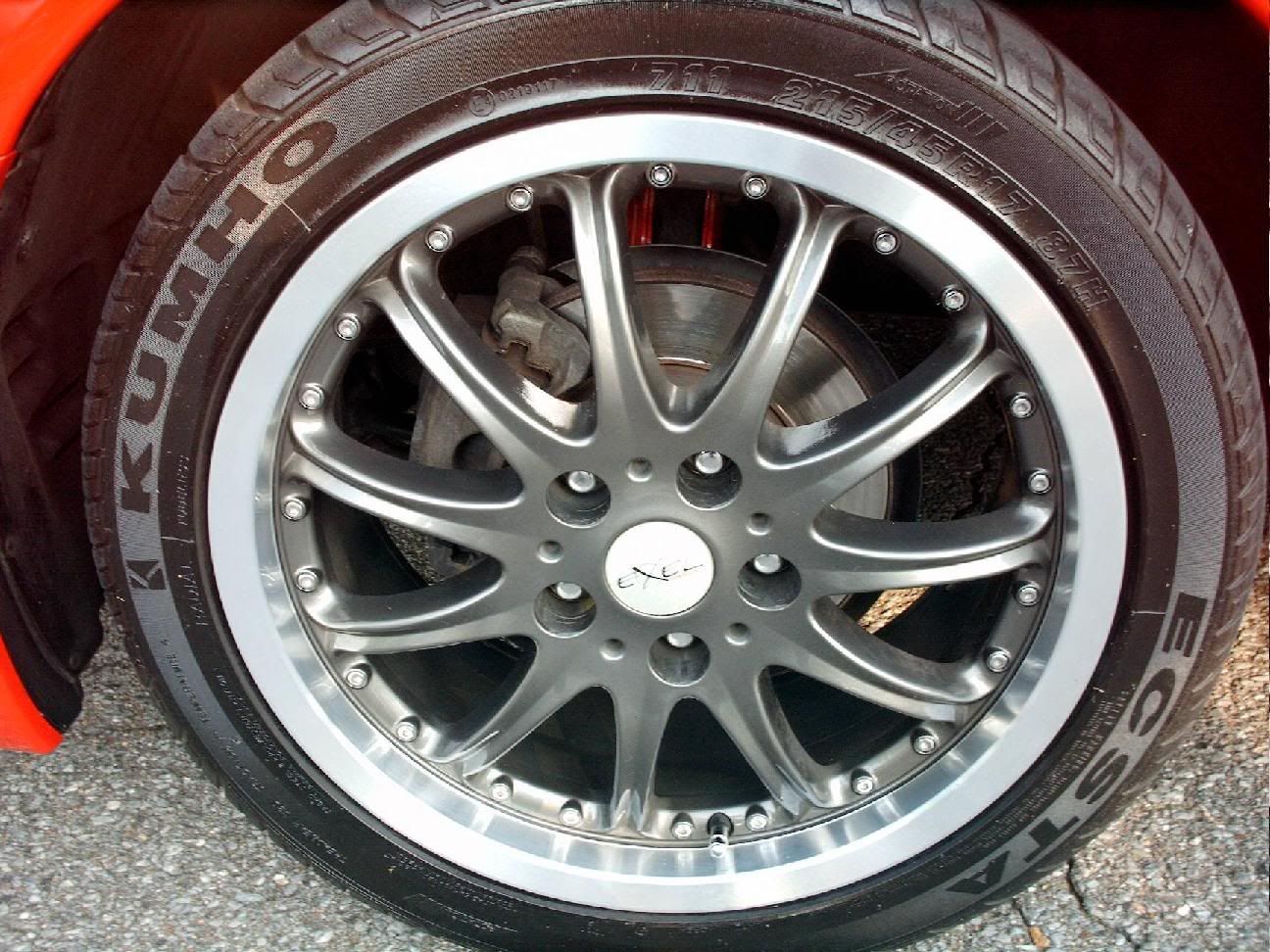

They are 16x8.5F with +13 and 16x9R with +19 I believe. I always get foggy about that though, I may have the offsets backwards.

Running Work Termist 17X8 +20 Front, 17X9 +27 rear, on a S14...Awesome fitment.

Kakimoto N-GTs 17x8 17x9 +37 all around 235 in front, 255 in back. clears the WS coilovers but not the 300zx brakes
Regamaster 17x8 +35 all around with 235 in front, 245 in the back. Clears everything so far. Haven't tried the 300zx brakes yet but looks like the spoke design will clear fine.
