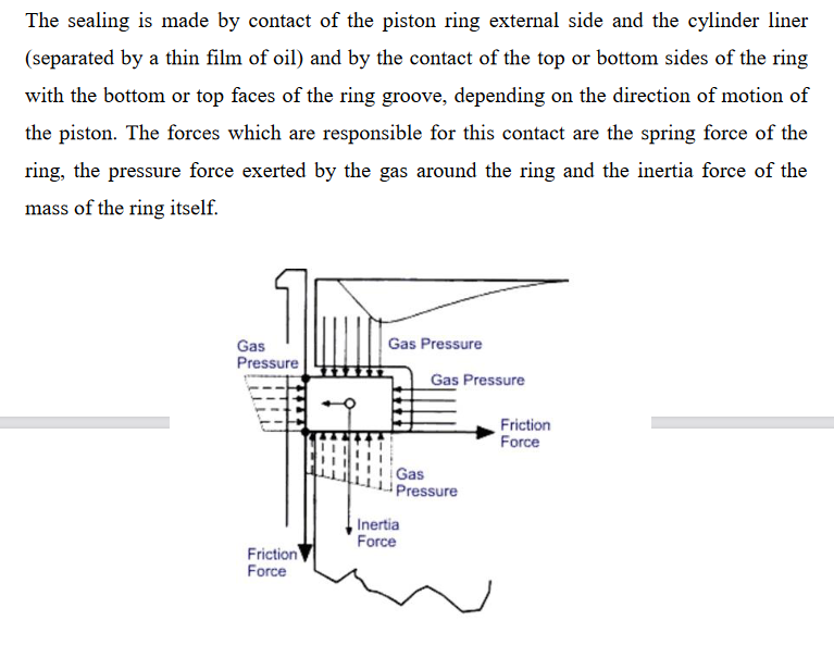

And finally the can and lines does nothing useful. Healthy engines don't spew oil mass enough to cause harm to anything. Not to any engine thats even been produced by any manufacturer- not turbo, natural aspirated, not corvette engines used for track duty, nothing ever came with a catch can and nothing ever needed one. They fooled you, fooled everyone, into thinking you need one. You see everybody else has one, so you assume you need one also. Its just a cheap part they can sell you, everybody has $50 or $100 to buy a catch can. Everybody can afford it. Nobody is actually measuring their crankcase pressure before and after to realize - Hey! It hurts the engine! People lack education to understand the relationship between pressure and oil droplet size, to understand differential pressure of the ring pack, the pressure goes behind the ring to hold it against the cylinder wall from above while pressure from the crankcase is trying to force the ring up, unseating it and creating excessive blow-by, lost sealing, oil occlusion. The two forces on the end of the power stroke play tug of war as the piston decends and the higher the crankcase pressure is the sooner the ring will lose tension and switch sides allowing oil to enter the 2nd and 1st ring pack, causing burnt carbon glue to gradually stick the rings and prevent them from turning. And I am only brushing the subject.
