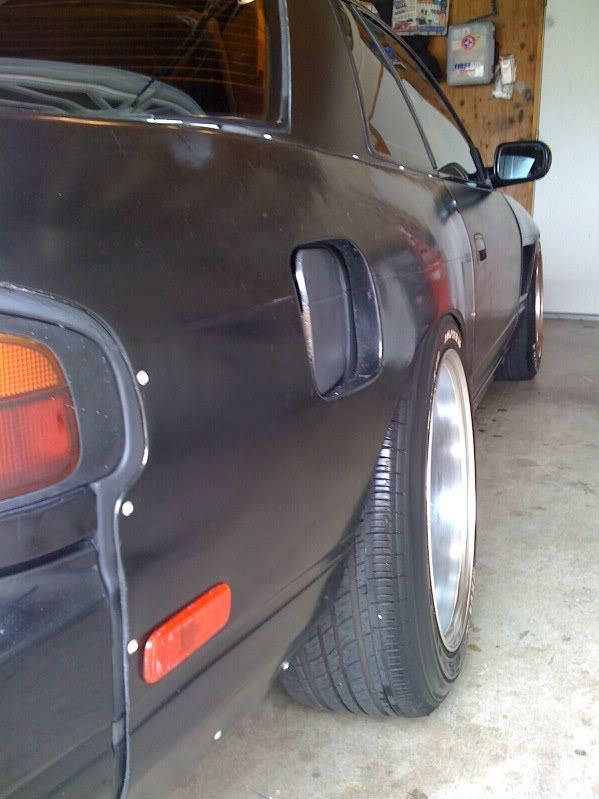

All depends on what coilovers. On my old Kouki, I was running 17x10 +12 FN01s on MR coilovers. Fuckers wouldnt clear for shit. I had to stuff 8mm spacers for them to clear, effectively making the fronts down to 10J +4. \

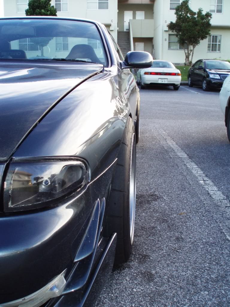

On my current S14, I got a set of Topline Aragosta Coilovers, currently got a set of 17x10 +18 RPF1, same shit, hitting the coilover, had to slide some 5mm spacers, even tho looking at it, 3mm would have been enough clearance.
FN01s:
RPF1s:
Planning on running a set of 18x10 +18 Work Equips when I get back to Okinawa in about 3 weeks...planning on running 235/40 up front and keeping the 265/35 rears (will probably change that down later to 245/40s) that came with the wheels, will post that up when I get back.

Strange Ray, I had to run 8mm spacers to clear my Topline Aragosta dampers with those exact wheels on your car.

No clue koops, im running 5mms and I got about 2mm of space. I can probably take one more collar, drop the car a bit more and ride the lip between the springs and I wont need the spacers.
does it hit the tire or the wheel itself?
The rim lip itself...
