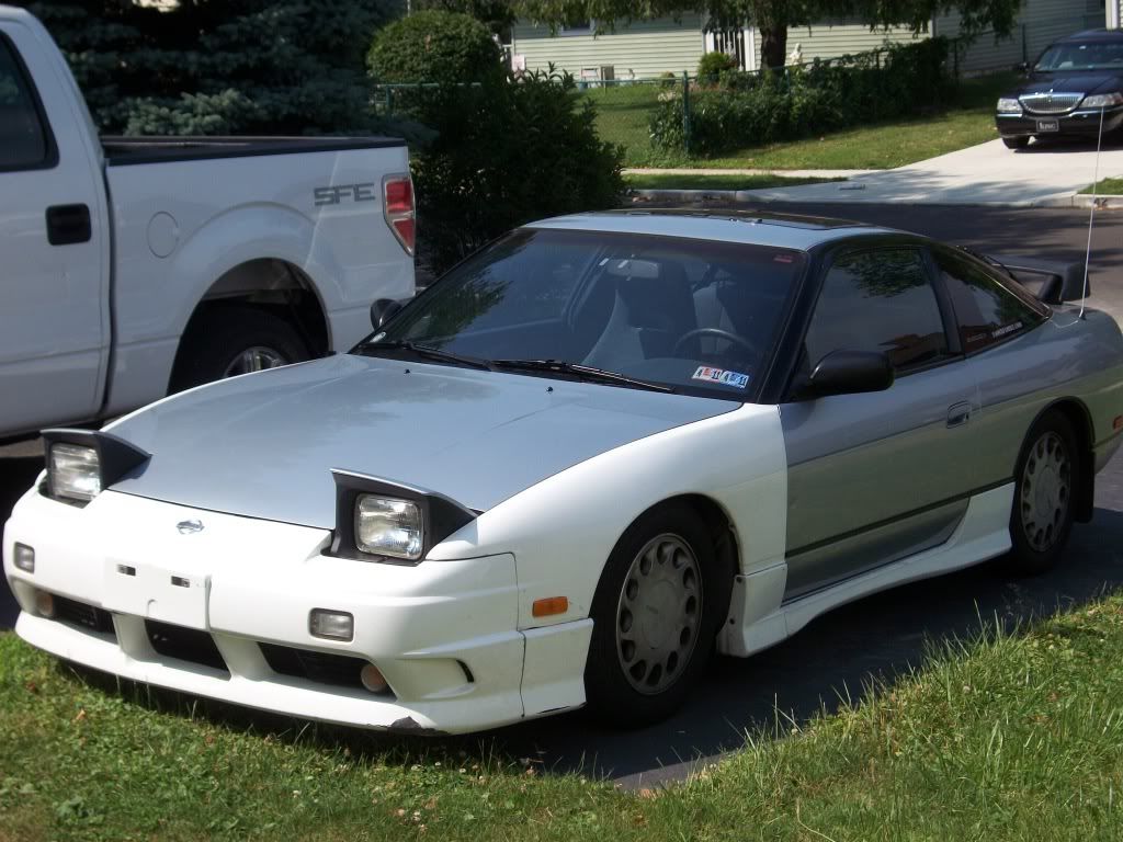

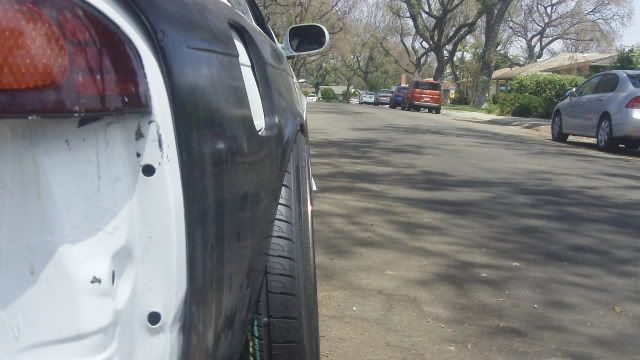

1/4 panel rattle canned with krylon and cheap primer
Now the car looks unbalanced though because of the akward two tone

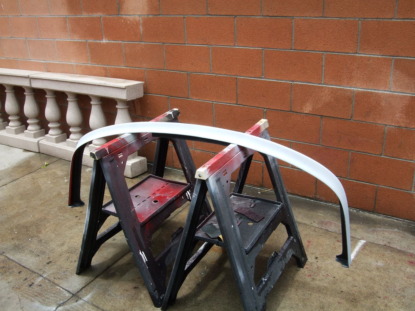

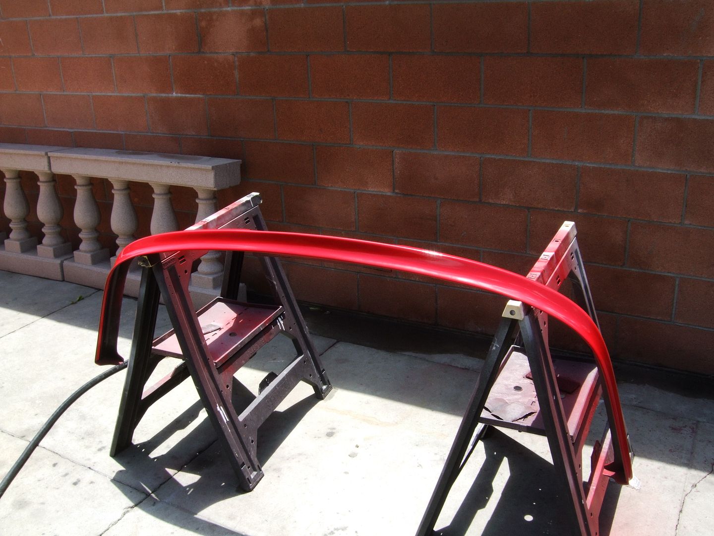

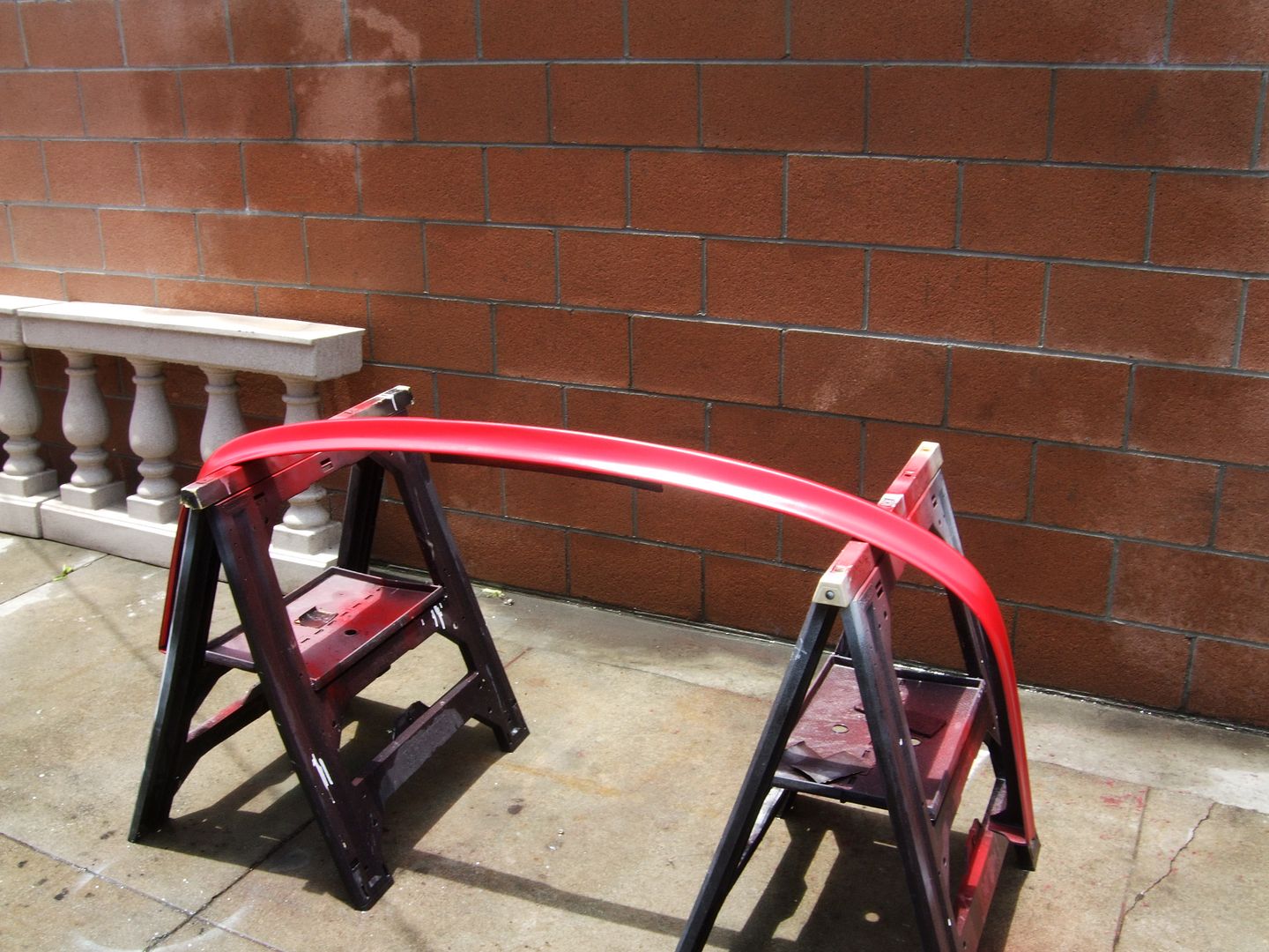

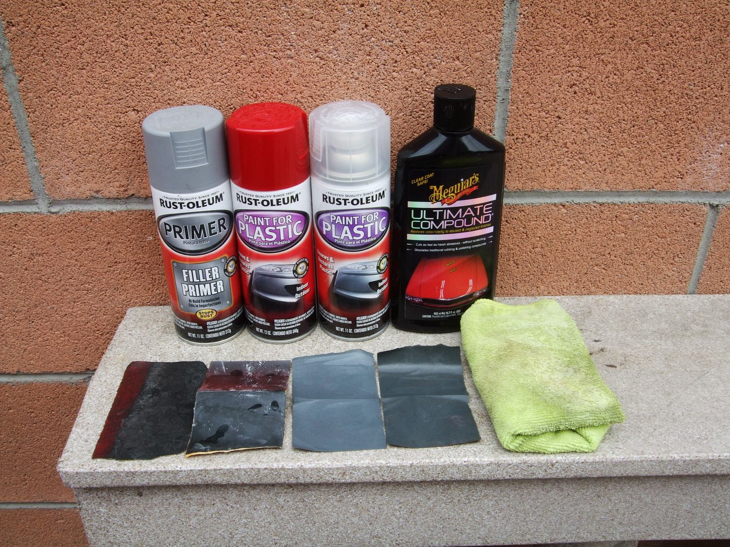

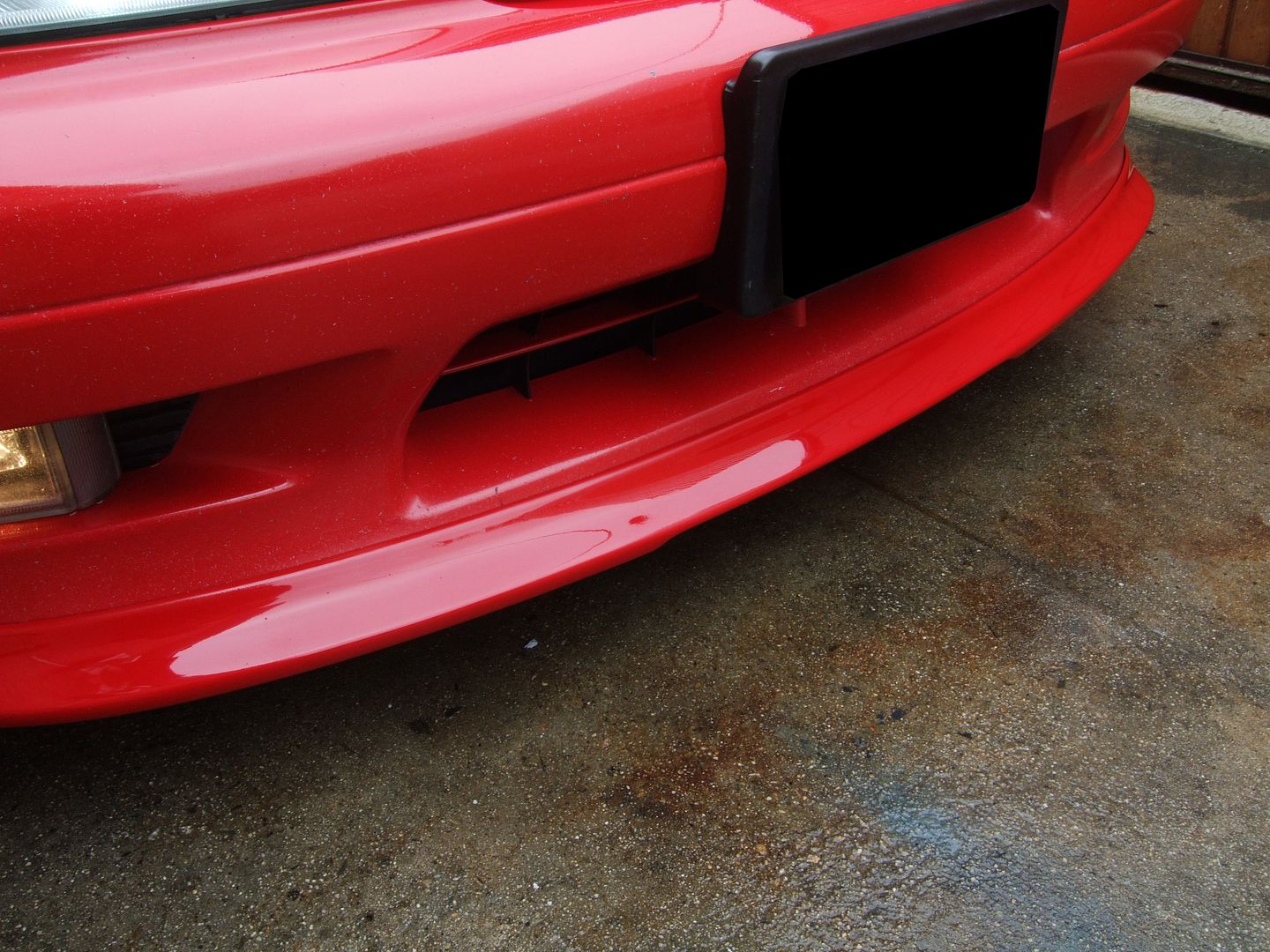

I did the front lip and mud guards on my G20 recently.
Prepped the lip and mud guards with 220 grit. Two coats of primer, then wet sanded with 400-800 grit. Laid down base and clear (2 coats each), then let the clear dry overnight. Wet sanded the following morning with 1000, 1500, 2000, and 2500. Buffed with Meguiars Ultimate Compound. Spent probably around $35 in materials ($5 each can, $10 for the compound, and the rest on sand paper). A shop would have probably charged me somewhere in the neighborhood of $250 for everything.
Primer:
Base coat:
Clear coat:
All done:

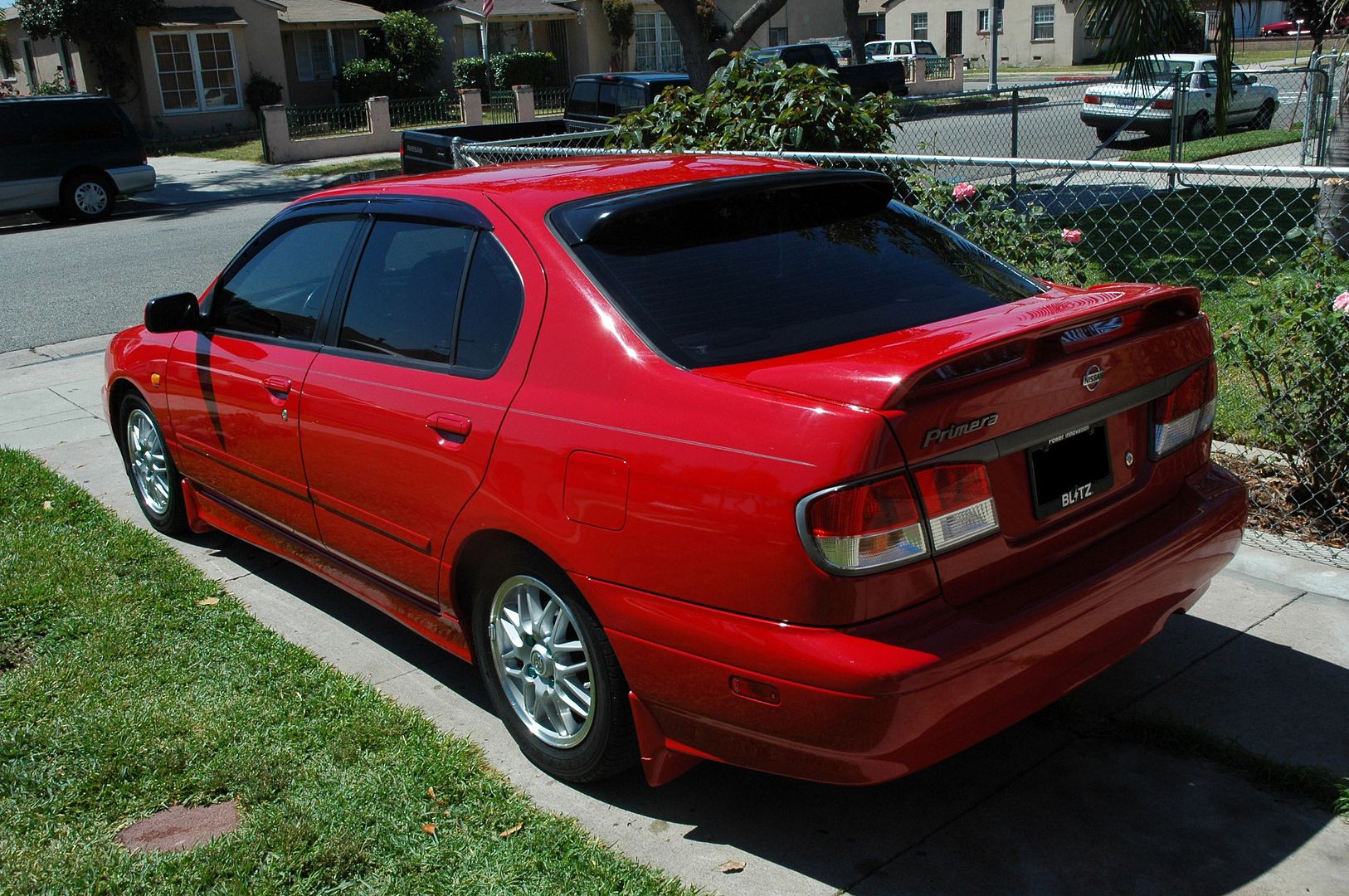

Didn't take pictures of the mud guards, but here it is all finished:
Materials used(all of the sand paper sheets weren't pictured):
Got an extremely smooth and glossy finish. Not an 100% match with the OEM red, but it's close enough for me. Some of you guys are getting pretty shitty results with rattle cans.
I'm usually the guy to tell you to paint it properly with a gun and compressor, but I really couldn't justify going through all that trouble for a lip and mudguards (aka something small/minor). Now, if I were repainting a front bumper or a bigger panel, I would have definitely gone with a gun/compressor.
If he had bothered to clear, wet sand and buff it, it wouldn't be so noticeable.

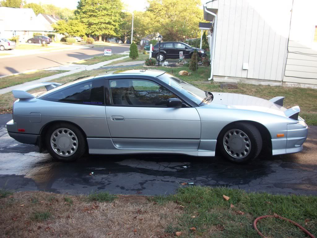

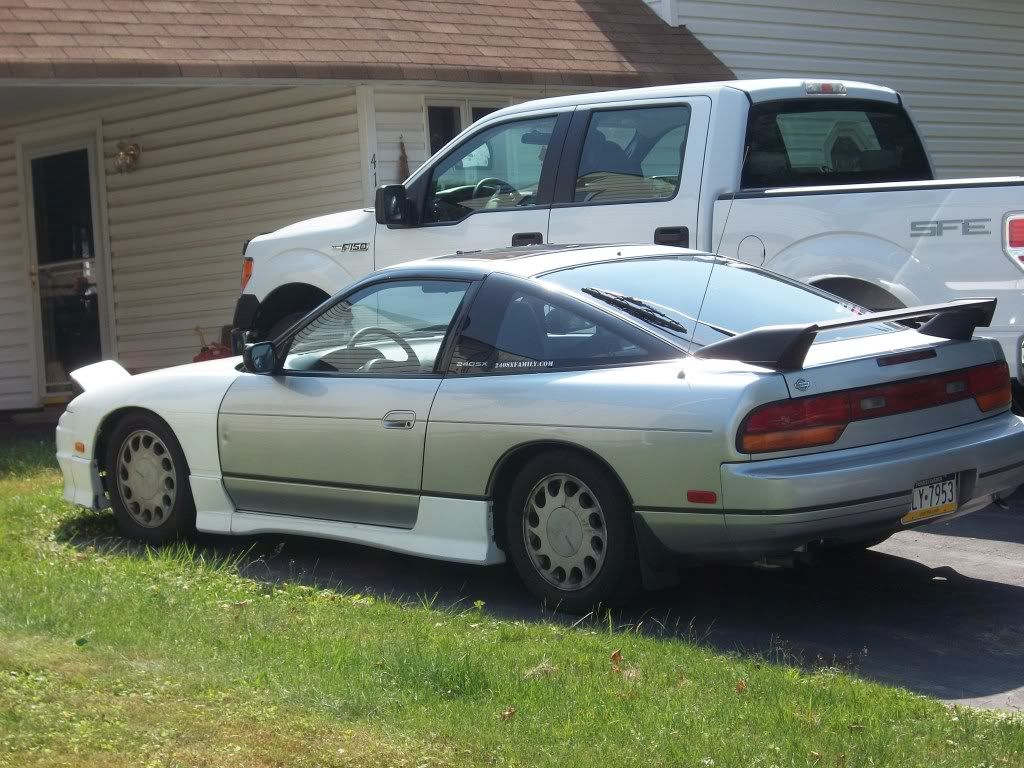

Color matched my type x stuff.
Before
After
All done with spray cans.

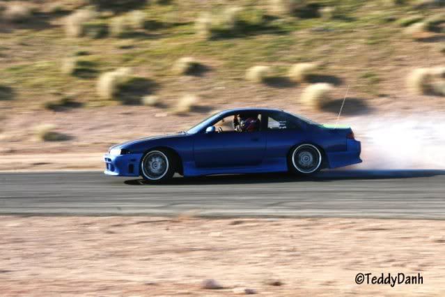

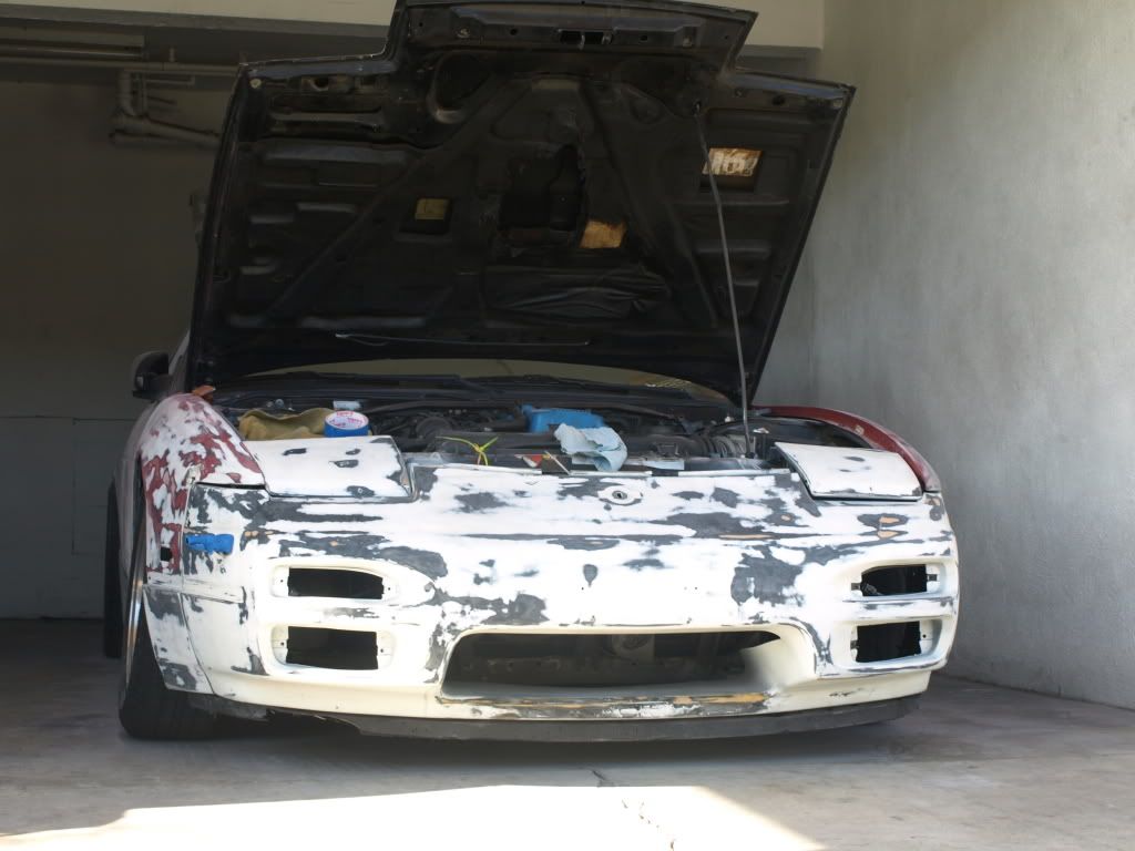

so i've been reading this thread for a long time....and since I wanted to try and paint my car myself...i tried something a little different....
car used to be blue.... crashed it into one of the guys at a drift event (he actually hit me) replaced the whole body with a "nismo" replica...this is rattle canned that metallic flakes blue that you see in autozone...it was the only one to remotely match..you can see the difference in the bumpers/sides.
I then got lucky on some really fancy wheels, and decided to redo the whole car because of the wheels....and lets say...it was a job.
I hung out here on this forum, and decided to not spray the car, but try the "ole" roller method. and for about 50 bucks...i painted my whole car outside my house...a panel at a time.
as you can see...i wanted everything painted...
so I sanded the whole car down...all the panels, took about 4-5 hours for a quick sand....after washing the car really well of course. I then put on the first coat...at this time it was really warm in socal, so the paint was a little wet when I put on another then coat.
the following weekend, sanded the car again, and put the second layer on her....I have yet had time to sand the car, and put a final coat on...
but I did have time to hit up the friday night lights at irwindale for a whole 4 runs, but someone was able to snap this shot.
It's cheap, not a bad job...would I do it again...hell no, i'd pay someone 5 bills to paint my car for two weekends off....but for those that can't afford shit...this was cheap, and came out more than decent.
and yes, don't touch wet paint.

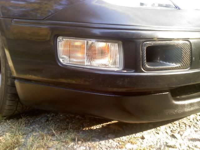

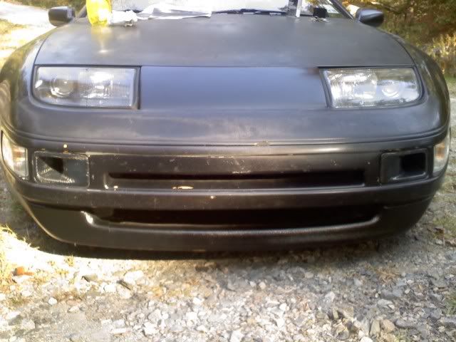

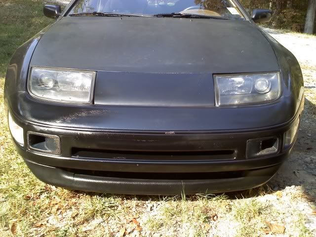

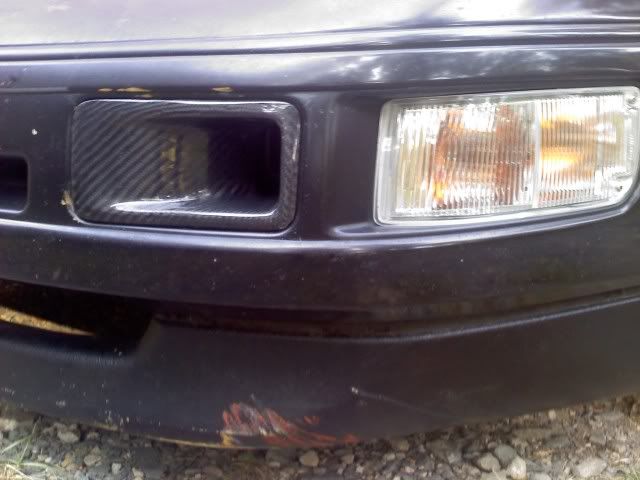

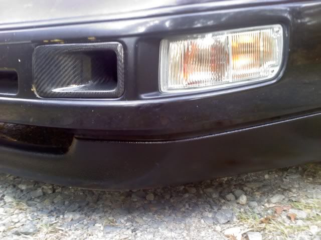

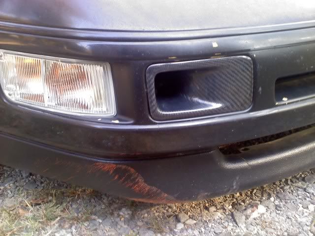

Before:
From the U-Haul trailor, car was too low. :/
After:
Before:
After:

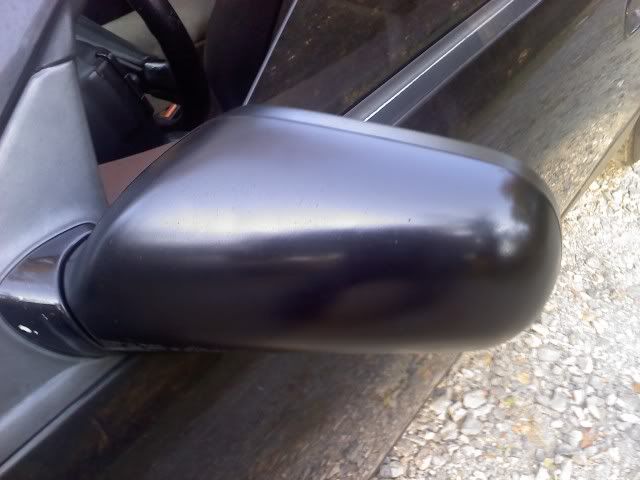

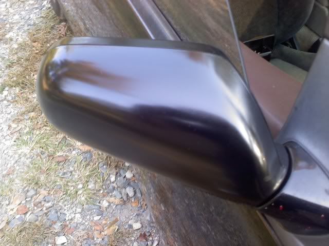

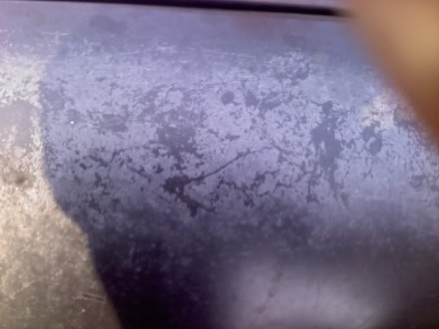

Mirrors were getting bad too.
Before (both looked this way):
After:
Before:
After:
daxnizmo is offline   Reply With Quote

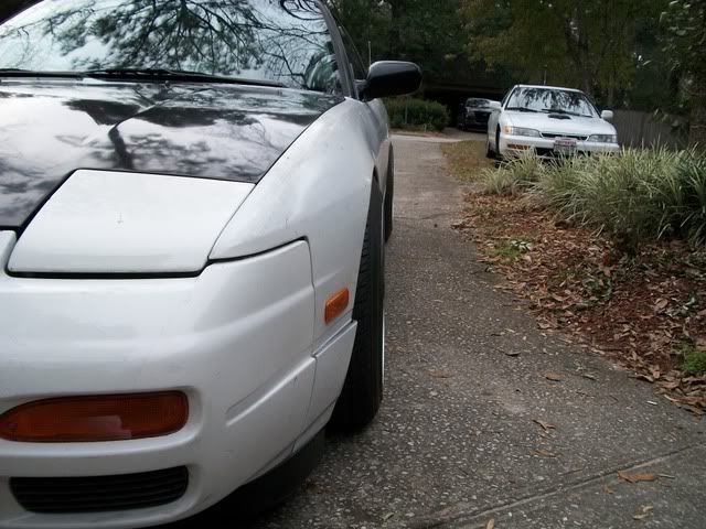

Both the hood and the fender were rattle canned.

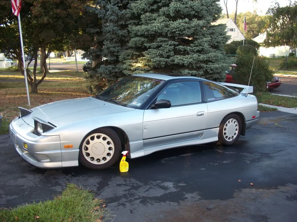

this is all rustoleum. track car or beater status. nothing more
body is 1 coat gloss white with minimal prep wet sanding. I clean it with a MR Clean Magic Eraser from time to time.
valve covers 3 coats metallic 2 coats clear
engine bay is 2 coats metallic and 2 coats clear
