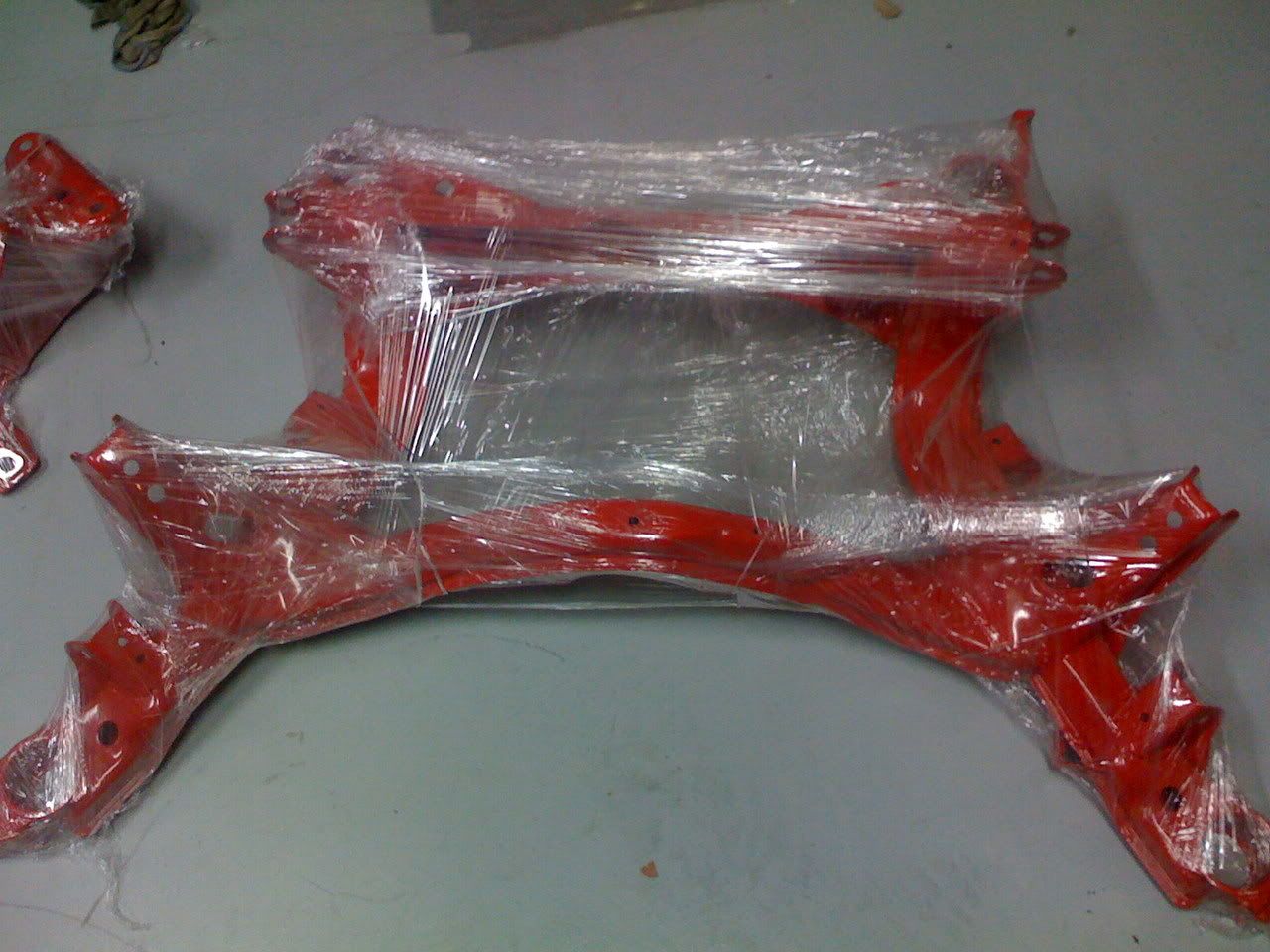

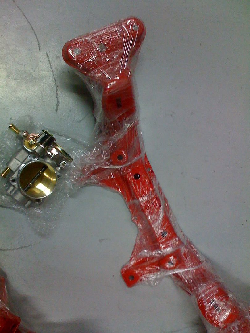

Back From Powder Coating
N15 Throttle Body + Adapter for a manifold I have coming in.

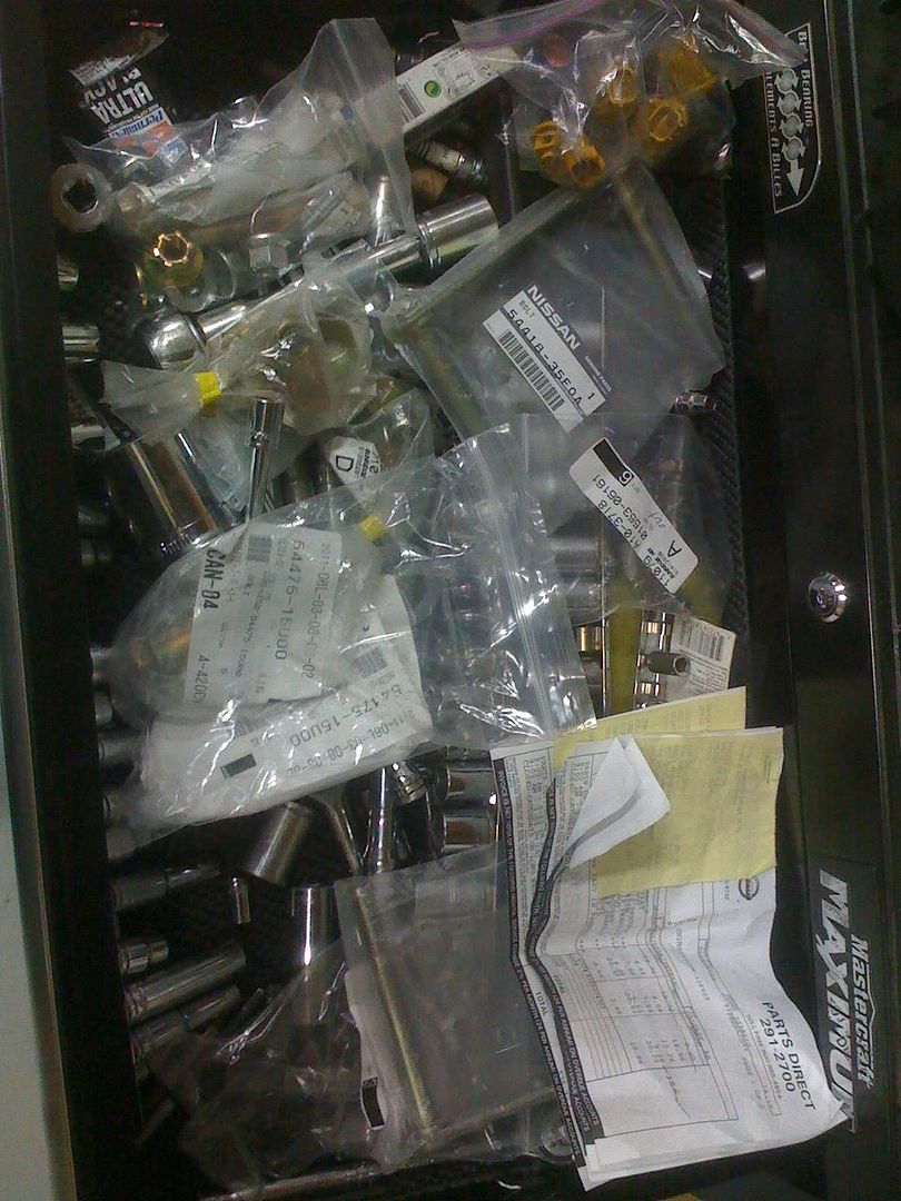

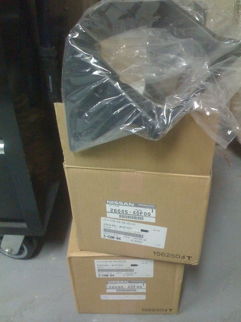

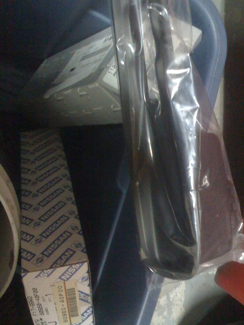

Misc Nissan parts iv recieved, trying to restore the the car, replacing all suspension bolts etc. interior panels.
Yes thats 4 Pages of part numbers.

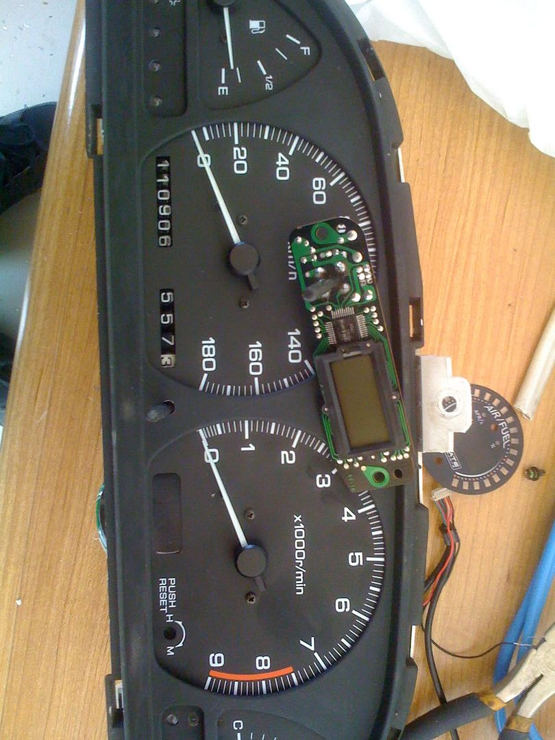

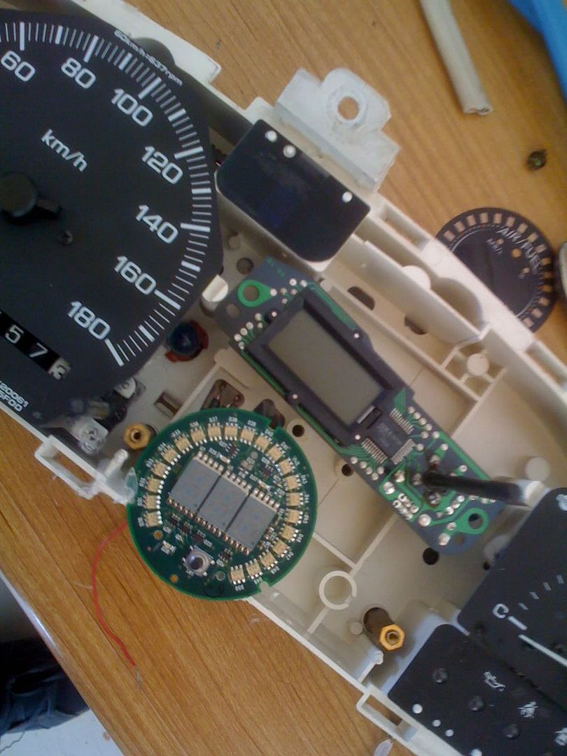

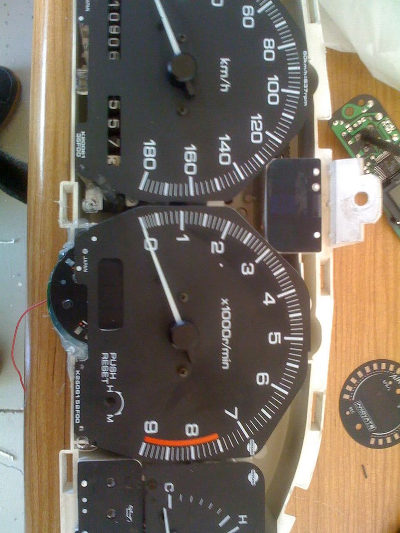

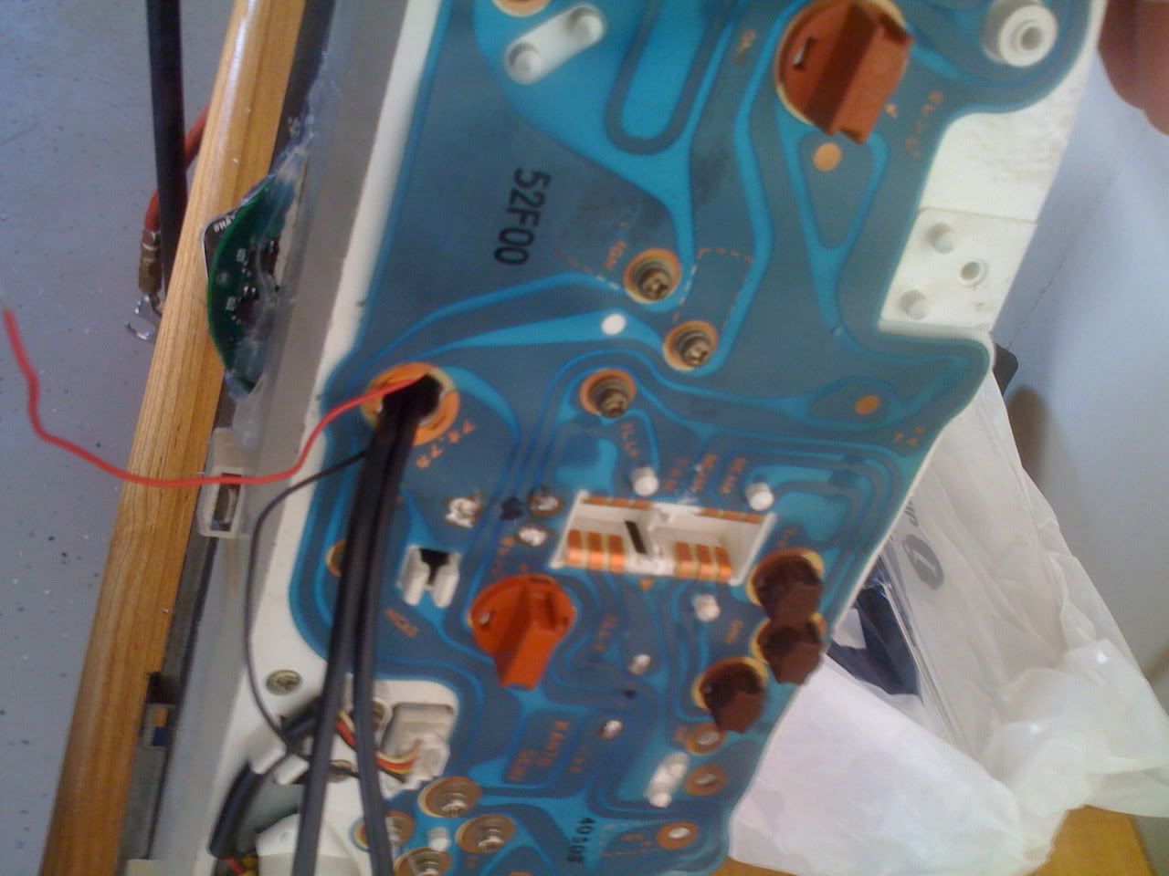

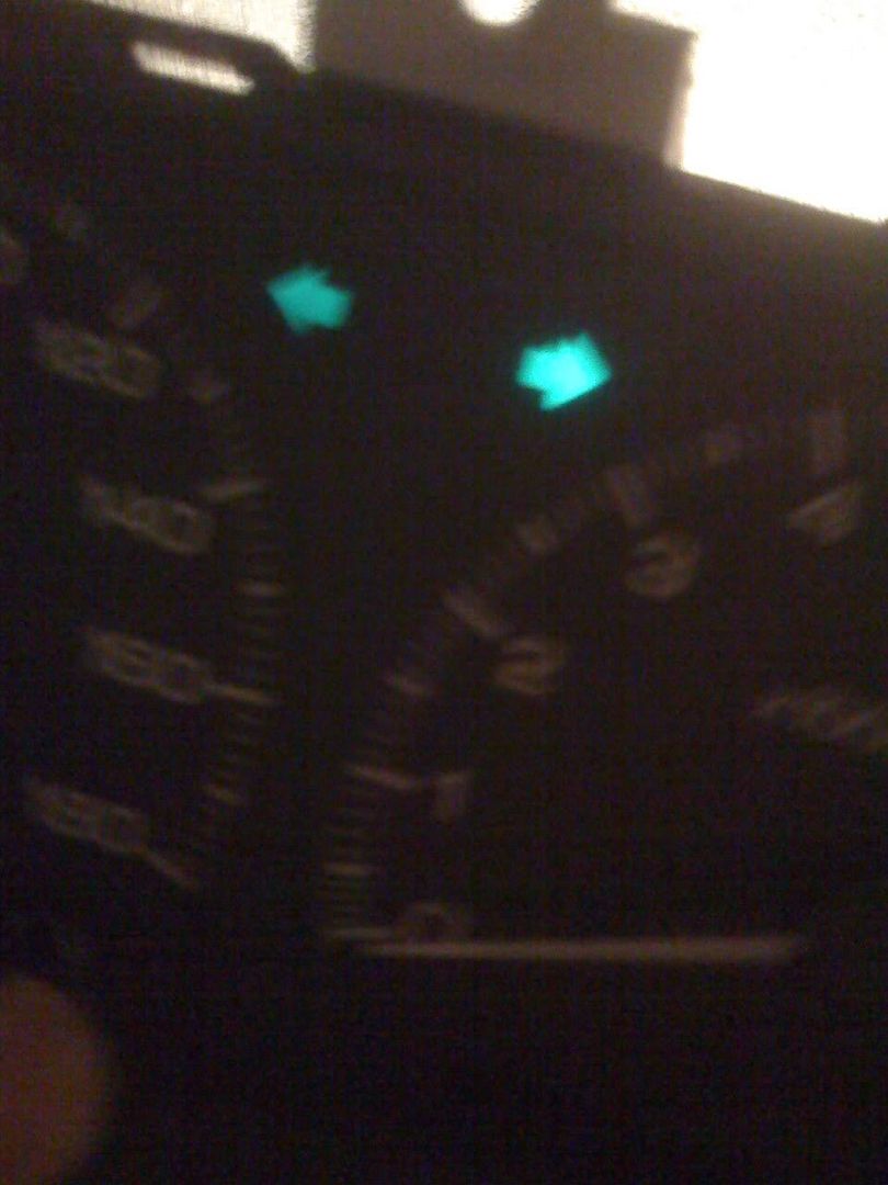

Gauge Cluster:
Testing this out on a spare, I have a spare Wideband and Spare JDM cluster. Once I get it figured out I will put it in my Nismo cluster.
Removing the clock. Disassembled the innovate gauge.
Trimed up the white plastic and the black plastic so it fits.
Feed the cables through the light socket as we will not be needing it any more.
Glued down so it wont move around as I try to stick it back together.
Place the face of the guage under the stock gauge so it looks stock.
once completed it should look almost identical to what it did when we first started. You wont see the white line on the innovate gauge face, ones its lined up properly.
Will finish this up one I pull my cluster out, Ill post pics of when its done.
