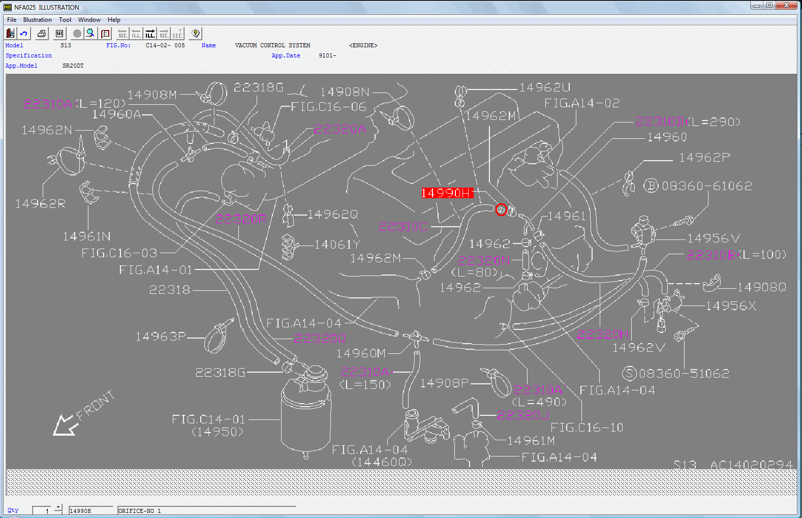

I'm still getting mixed signals but most of them say that the boost pressure itself is 10 PSi +/- .5psi for the S13/14 SR
Which would be more reasonable compared to the Avenir.

What I found on the Avenir was threw a japanese translation.
‚ª‚ñ‚΂êƒAƒxƒj[ƒ‹
ブースト
ノーマル(0.65)。EVCぐらいは付けたいかな?
Translated:
"Boost Normal (0.65). As for about EVC the kana which we would like to attach?"

Those pills are like the holy grail of boost control on the twin turbo Z32s.

Your wastegate actuator could be tired and on its way out.

i kno this is a old thread but interesting. did you guys ever think the bc could be used to keep the boost consistant. im on stock wastegate on a t25 but on a ka now 4-5gear the boost kinda doesnt stay consistant maybe the bc is ment to keep the boost consist through different conditions.
