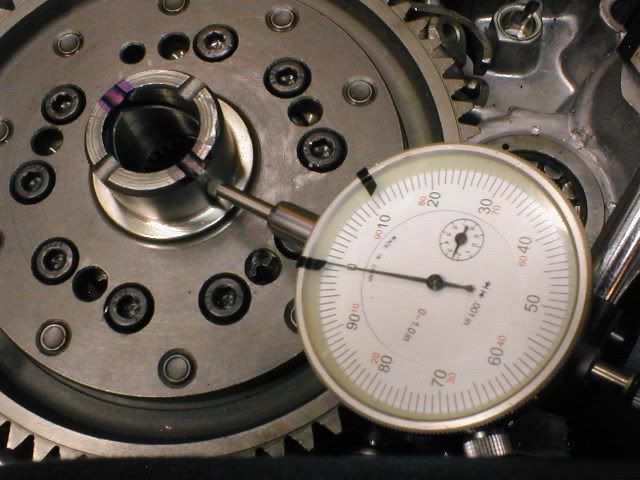

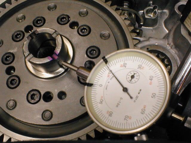

Not anymore. They used to be great, but now they are utter crap. As if quality control couldnt get any worse, they now have very bad issues with runout tolerance. I would avoid buying one unless you can do a runout test on it in person before you buy it.
