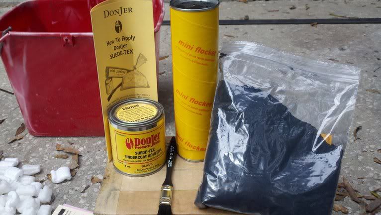

Then its time for this; Got 6oz (2 bags of black flocking) 2 cans of the black adhesive, hopefully it's enough. (Shout out to yellowxhoodie for the deal)

In primer, about to give it a quick sand then flocking right after. I hope it goes well
