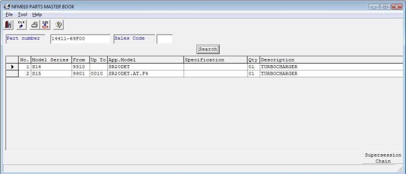

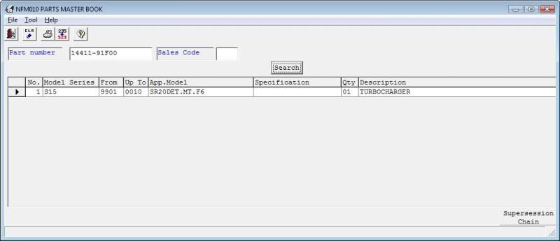

Originally Posted by mewantkouki View Post
I mod tamparacing.com's nissan section. This thread originated there. I told him exactly what everyone has been saying in this thread. S14 and regular non spec r t28's are the same. They are NOT 2871r's for the love of God! IIRC the only journal bearing t2 flanged t28 comes off a Pulsar. The turbo he was sold is a standard bb s14 / non spec R t28. If it was marketed as a Spec R dual bb turbo, then there can be a dispute. It is pretty evident that wasn't the case though.
All this crap over 10-15hp! I guess he needs to hear everything twice...
S14 vs. S15 T28 turbos!!!!!!!
S15's only came in TWO trims. Spec-S and Spec-R. So for you to say "non Spec-R" tells me you mean Spec-S. And if you knew anything about anything Spec-S models are NON-TURBO which means no T28 at all.
The difference in turbos is based on transmission and transmission only.
14411-69F00 is plain/ball bearing (S14 Kouki turbo)
14411-75F00 is plain/ball bearing (S15 Spec-R AT only)
14411-91F00 is ball bearing (S15 Spec-R MT only)
edit:
The part number below the main part number above will indicate whether or not its plain or ball bearing.
466541 = ball bearing
466543 = plain bearing
So if you have a turbo with part number 14411-69F00 and below it says 466541-, then its an S14 Kouki T28 ball bearing turbo.
But if you have a turbo that says 14411-75F00 and below it says 466543-, then you have an S15 Spec-R AT T28 plain bearing turbo.

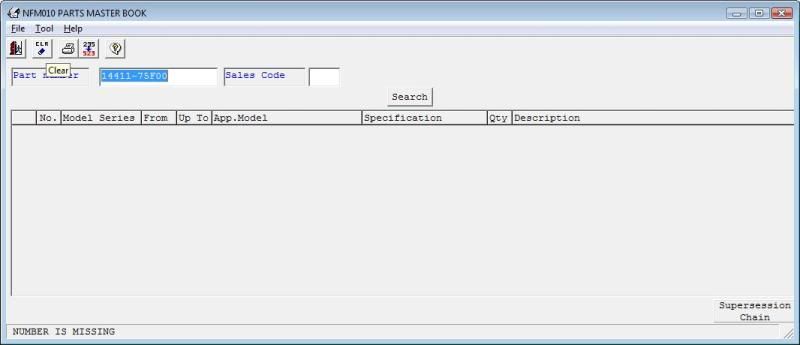

Hmm, it appears 14411-75F00 is Australia-spec...
Jap PS13 14411-50F00
AU/NZ S14 (pre-facelift) 14411-75F00
AU/NZ S14 (facelift) 14411-75F00
Jap S14 (pre-facelift) 14411-69F00
Jap S14 (facelift) 14411-82F01
Jap S14 (Autech/270R) 14411-RP801 (Same as S15 early MT turbo)
Jap/ NZ S15 (early*) 14411-91F00 Manual model only
Jap/ NZ S15 (early*) 14411-69F00 Automatic models
Jap/ NZ/ AU S15 late* 14411-75F00 Same as NZ S14 and same for both Auto and manual

I found the plate after cleaning the dirt/oil that was covering it.
YF 0958 J
14411 - 69F00
466541 - 7001
Mysterious Driver is offline   Reply With Quote

You have the S14 Kouki / S15 AT spec-R T28 ball bearing turbo. If you were told you would be getting the S15 MT spec-R turbo, than you could dispute it. But if you were told just an S15 turbo and you agreed on an S15 turbo, then the S15 turbo is what you have.
End of discussion.
