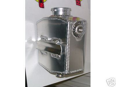

Originally Posted by Dousan_PG
wee works great
i have one on my car. its fantastic i love it
even my daily will get one. best mod for the money imo
mine's on the left. greddy unit. hecka cheap
how to hook up
there are 4 plus on the tank
3 top, onestraight down
top top goes to the overflow tank
the other two:
to the radiator plug (whre the overflow used to go)
other to the bleeder screw plug (greddy comes w/ the screw w/ a nipple on end to fit perfect)
lowest (bottom) goes to radator hose (lower) andfeeds water back into system
basically
the one that goes from bleeder is always bleeding AIR into the tank
the water goes back into the system going down (meaning air wont get back in once it goes thru bleeder
meaning: your system is always getting bled no more air bubbles ladies. = always cooooooler
makes draining and refilling syhstem easier (faster to bleed less work for me)
and when you 'refill your rdiator' you do it from the air separator.
its elementary my dear boy.
Couple of questions. I bought the GReddy Radiator Breather Tank and the nipple that comes with it has a different threading than the drain plug of my Koyo Radiator which is 10x1.25, Anyone else encountered this problem? Second question is what size Greddy Water Temperature Sensor Adapter for sr20det samco hoses?

1 88 U
1 88 U's Avatar
Join Date: Sep 2003
Location: Ga
Posts: 536
1 88 U is making his/her stupidity well-known1 88 U is making his/her stupidity well-known1 88 U is making his/her stupidity well-known1 88 U is making his/her stupidity well-known
bump. I can't find a hose fitting with 10x1.25 threading that will fit the Koyo rad drain hole. still need to know what size adapter for the samco hoses.
1 88 U is offline   Reply With Quote

if you got a diff rad with no rad cap and just a bleeder nipple on it, you could run a much simplier setup
like VW's run, expansion tank simply has the bottom outlet going to a rad hose, while the upper one goes to the nipple on the rad, it constantly flows coolant/air bubbles through the top and out the bottom of the tank
or you could keep your stock rad and have a very small expansion tank like the ones shown and run 4 hoses all over the place.

Old 01-04-2007, 04:06 PM   #48
McRussellPants
Location: Austin, Tx
Posts: 2,168
Someone has to have these answers?!
First off. lolololol at trying to plumb expansion tank into your radiator drain. don't do that.
Expansion Tank Hose
Filler Neck Barb = Overflow Tank
Top Barb = Coolant Elbow on Drivers side of Block.
Second Barb = Filler Neck on Radiator
Bottom Barb = Lower radiator hose.
(exact same shit dousan said on second post)
Samco hoses are either 36 or 38mm, either way, SPL has the cure for your sickness.
McRussellPants is offline   Reply With Quote

Instead of the lower radiator hose?
it goes to the same place on the engine and is still lower than the bleed kneck on the exaust side?
Only diff is the throttle body line is after the Thermostat.

You want the lower port of the expansion tank going into the suction side of the water pump. So that would be the lower rad hose.

Here is my contribution
This is on the Atlantic car I helped to build.
You can see there is three blue lines, one went to the back of the block, one went to the radiator and one went to the swirl pot.
There is also a big hose covered in fire sleeve that goes to the lower radiator hose, and another that goes from the rad cap to the overflow tank.
I know that.]
I was suggesting putting the line ont one of the nippels just behind the the thermostat that goes to the throttle body instead.

So:
Wouldn't it work if you just did it like this: (rather than using an awesome 19 extra hoses)
Remove the lower rubber seal from the radiator cap, so coolant can flow from the nipple out, hose to the upper area of a sealed coolant resevoir, with a pressure release CAP... then there will be a hose coming off the bottom of that into the lower rad hose (or any suction section of plumbing)
The only thing id be worried about is that the nipple on the rad is so high... I know on VW's which use a OEM system like this the nipple is on the end of the top endtank
