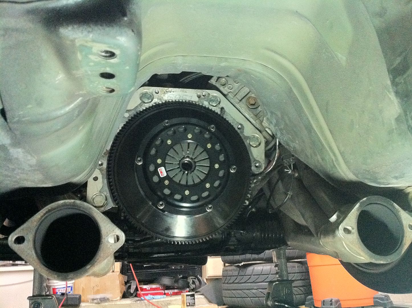

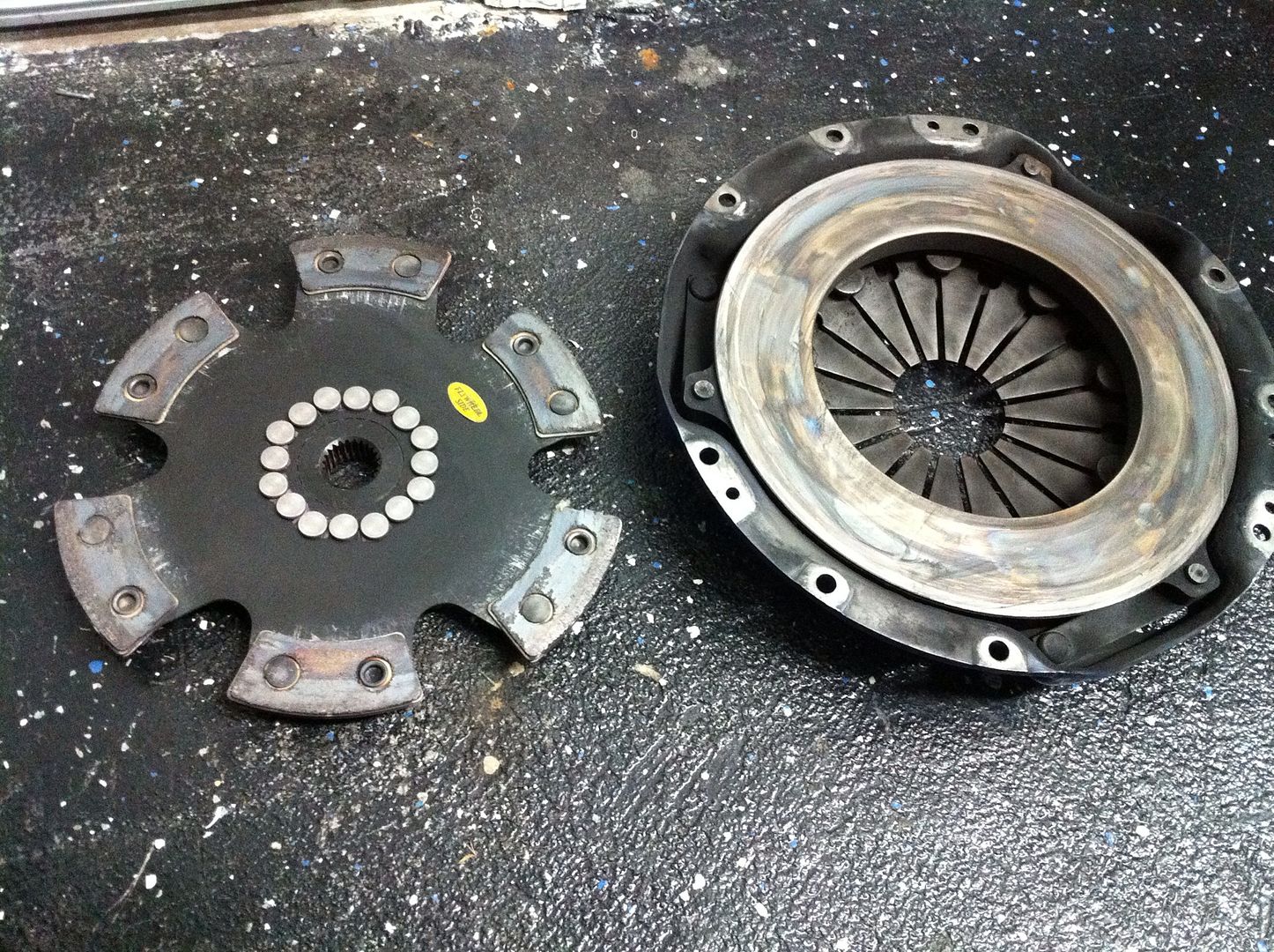

what happens when you clutch kick 4th with big tires
You take your clutch with 565 ftlb of tq capacity and destroy it...
Luckily the guys over at competition clutch where able to get me setup up with a new Twin plate clutch that will make sure that never happens.

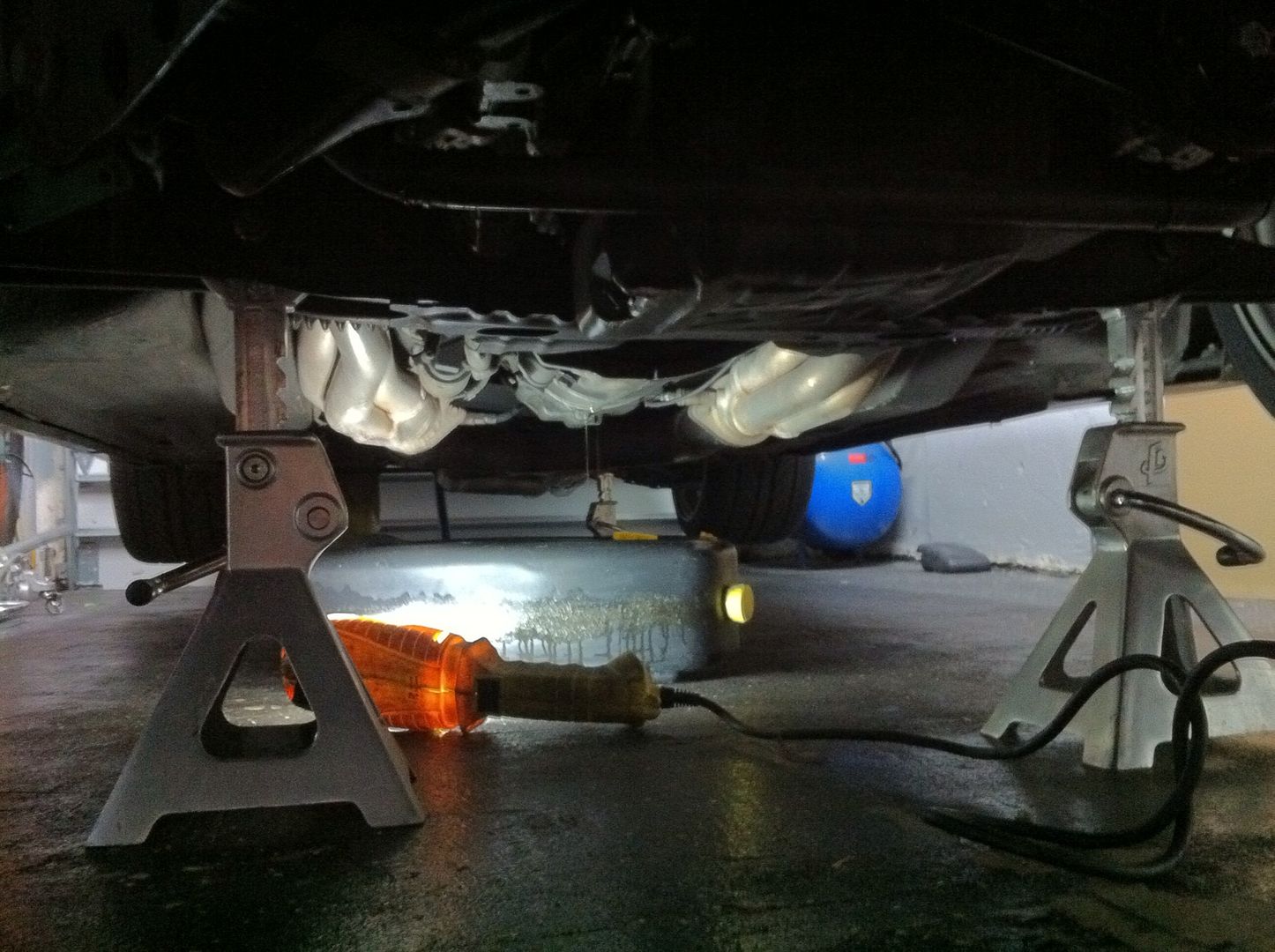

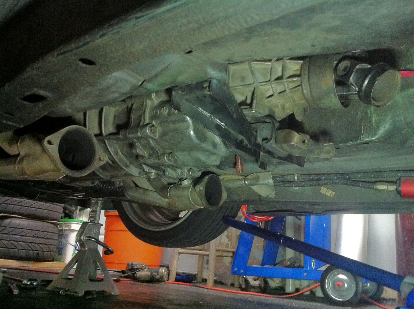

In the mean time, i was bored tonight so decided to drop the tranny, and get everything ready....
240sx hover conversion.
draining the tranny fluid thats been in there for like 3 years as to not make a mess

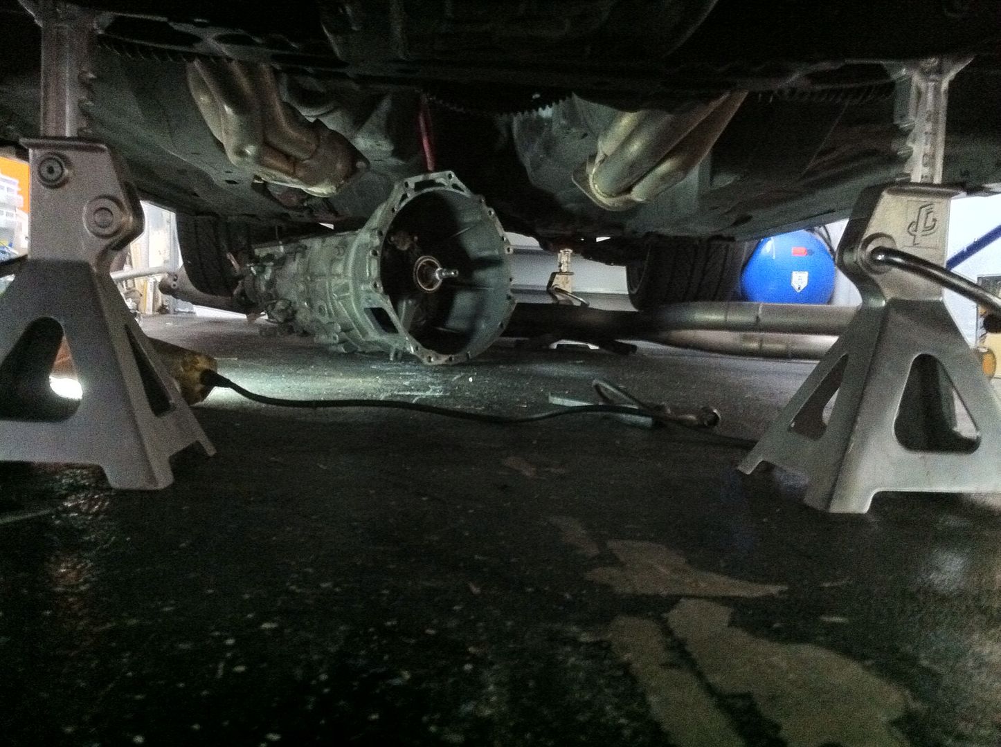

and boom goes the dynamite... took about an hour and a half to drop with some help from the wife.

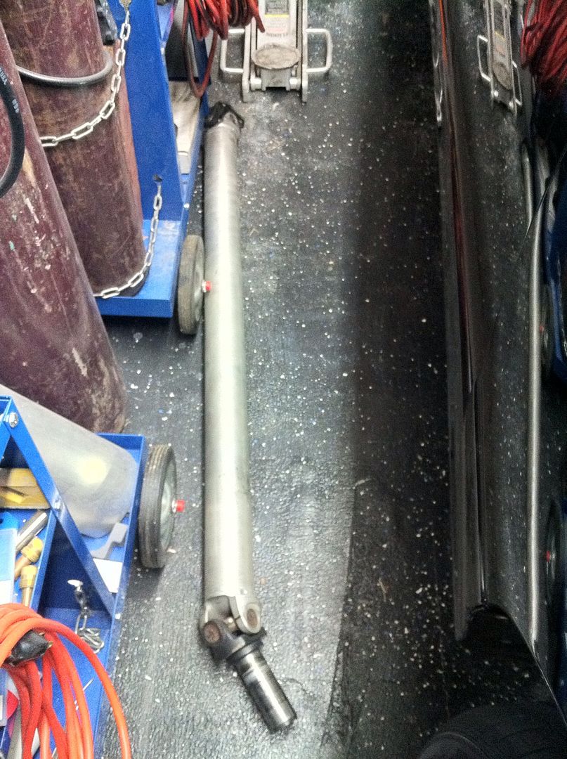

heres a picture of my baller aluminum driveshaft, its one of those things that you spend 500.00 dollars on that no one ever sees, so look at it haha.....

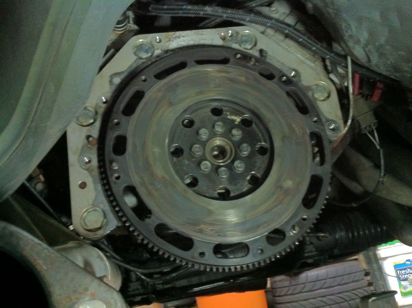

heres the flywheel, its not bad still useable with a resurface. Not that ill need it as the twin plate comes with its own flywheel.

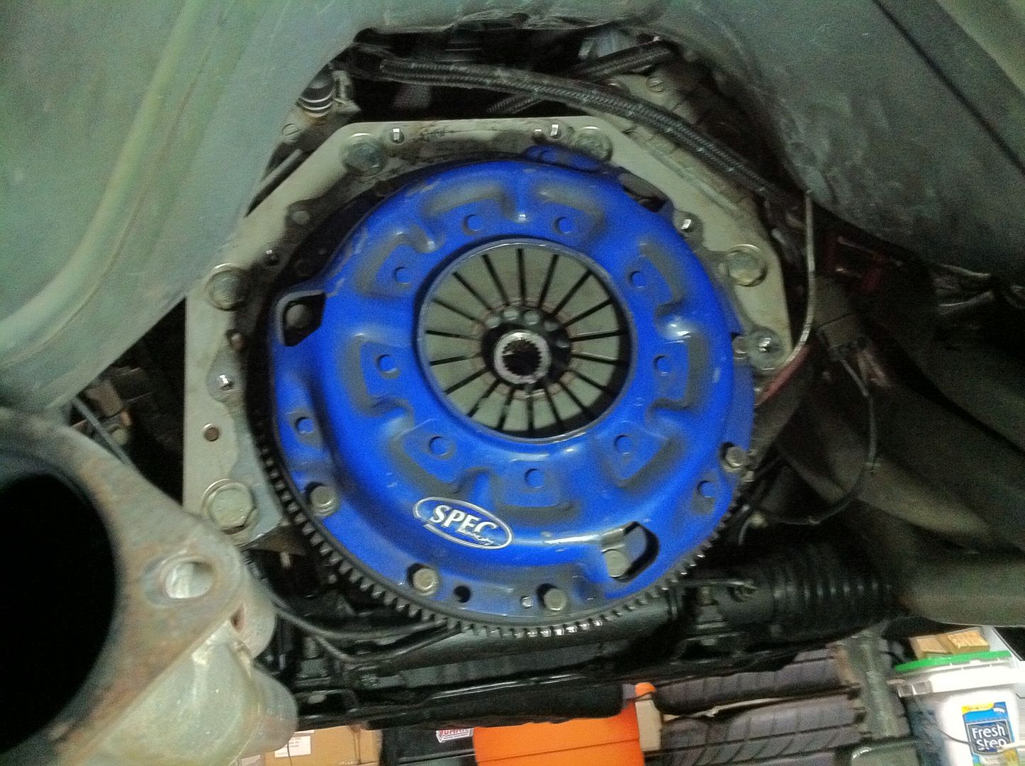

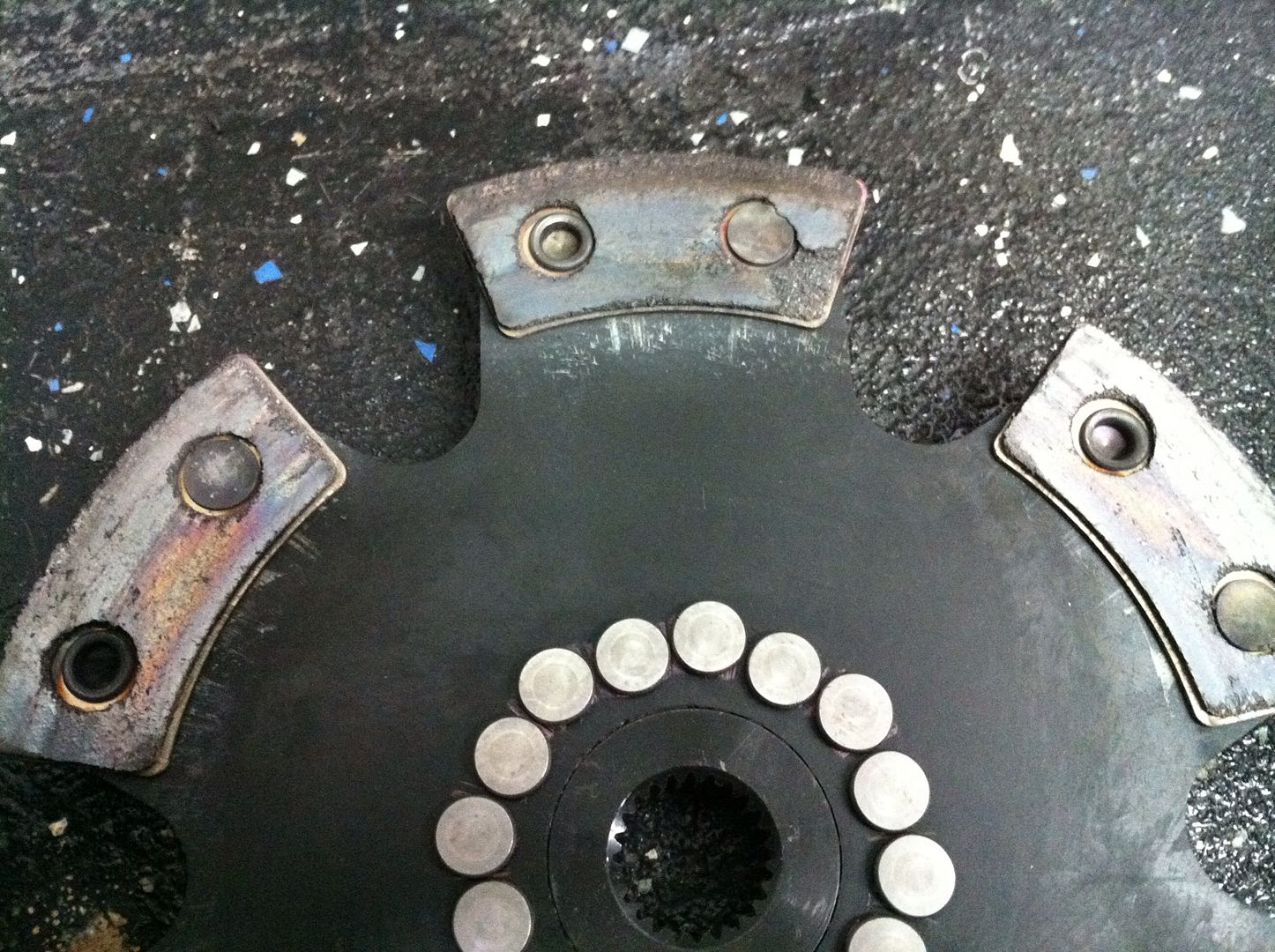

Pressure plate and disc fare a little worse...
some pieces of the disc chipped off and the disc looks glazed... but whatever.
Got it in, heres some pics......

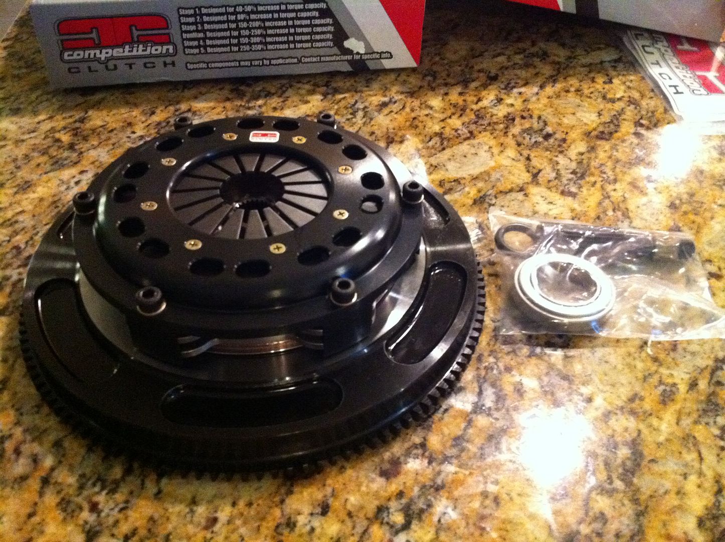

the box...

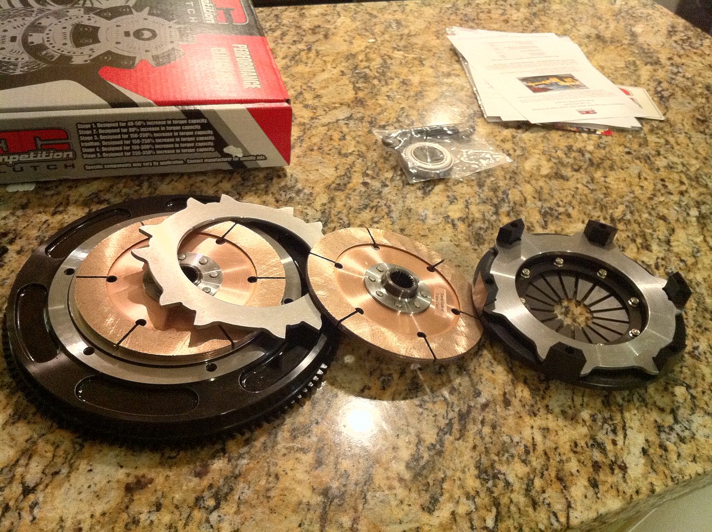

whats in the box....
Here it is in all its twin plate glory..... looks super beefy..

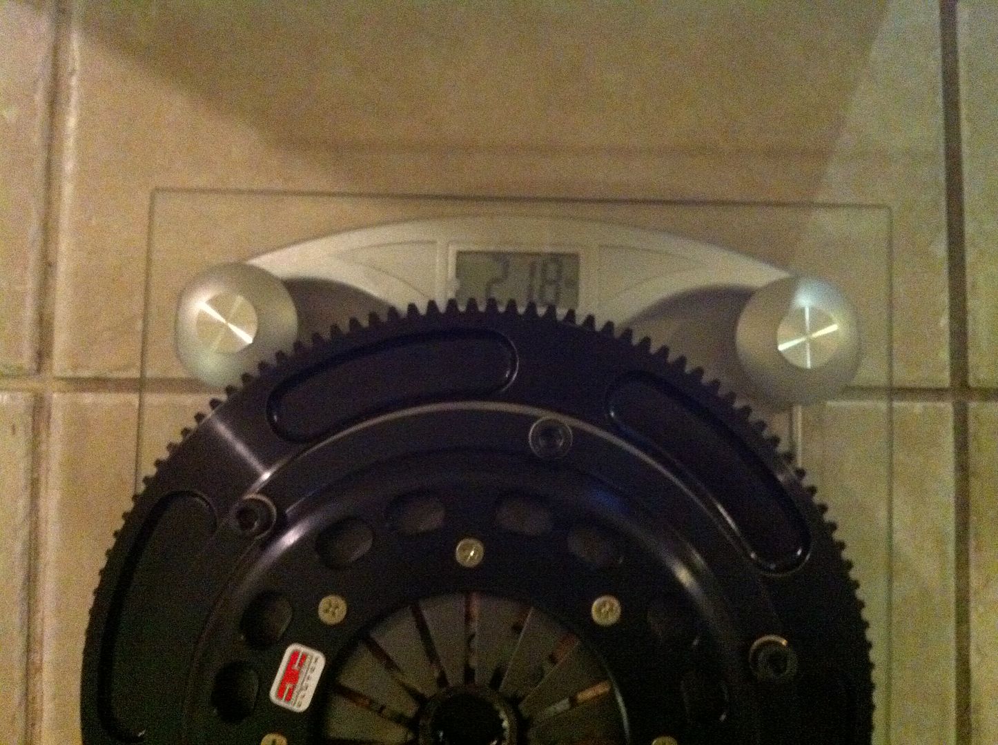

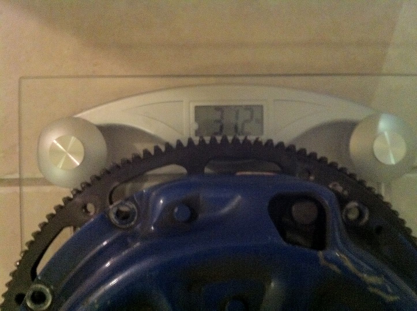

As requested... Here is the weight of the twin plate clutch and flywheel. 21.8 lbs
Compared to the previous disc and pressure plate.... XTD chromemoly 13lb flywheel and spec pressure plate with act 6 puck solid hub 31.2
Here it is disassembled.
9+lbs of rotating weight is an incredible amount, it should rev SUPER Fast!!!!

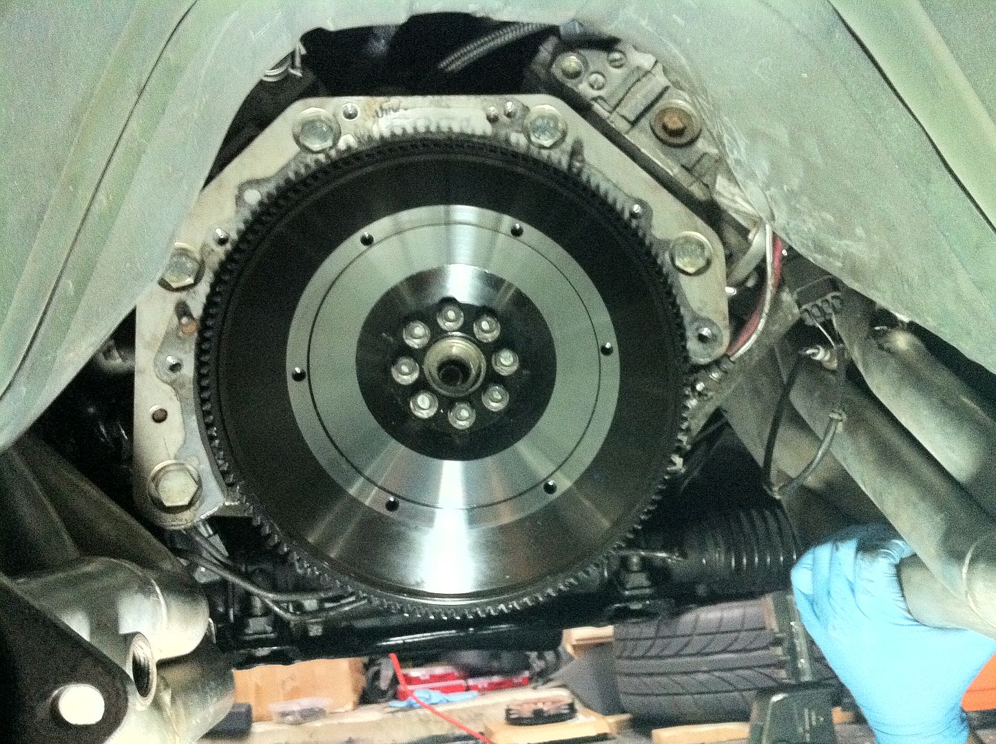

Got the flywheel in, simple enough Factory tq settings are 69 ftlbs
Pressure plate and disc went in smoothly with supplied pilot bearing, and alignment tool.
Then it came to the tranny, i used to be able to loosen the motor mounts and tilt the motor back to get the tranny in. But the new intake manifold had to had to be removed in order to get the engine to tilt back because it would crash into the firewall. At least the old one for all its ugliness cleared the firewall with enough room. But the long and the short of it, is its in.
Preliminary report..
This clutch ROCKS!!!!!! I didnt know what i was missing before. The engine revs up faster, due to the lighter weight. The up shifting and down shifting is way quicker than before, and man o man does this thing grab. I gave it a clutch kick in 4th at about 30 mph and it just lit up the tires. Now i understand how 240's can break axles as hard as this grabs.
As for the drivability, Ive gotten plenty used to the 6 puck unsprung disc from before and while its more aggressive its not terrible for a what it is, i had no problem getting the car going, it didn't even stall on me once. But then again its a light car with V8 torque an there aren't any hills in flat florida besides, its a race car.
As for the rattle, which was expected with a twin plate, its very faint, much better than i thought it would be, you can hear it but you have to really listen for it.
Car is all done and ready for tomorrows drift event so i will have a more detailed report tommorw on the track, as i really could get on it too hard on the street.

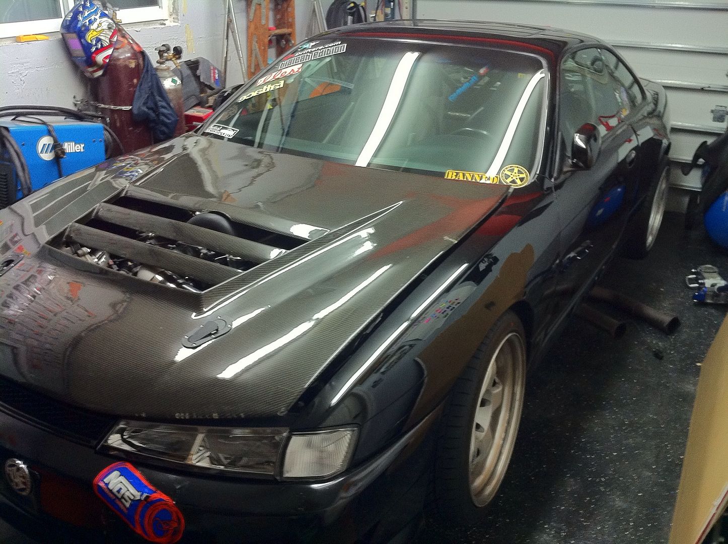

the car is still around.. i drive it all the time. Track, street, everything i just don't post that much because it doesn't break often. As a matter a fact I've been bored lately and have been contemplating upping the boost to 10-12 lbs to see what happens.
I actually drove it today and snapped this pic.

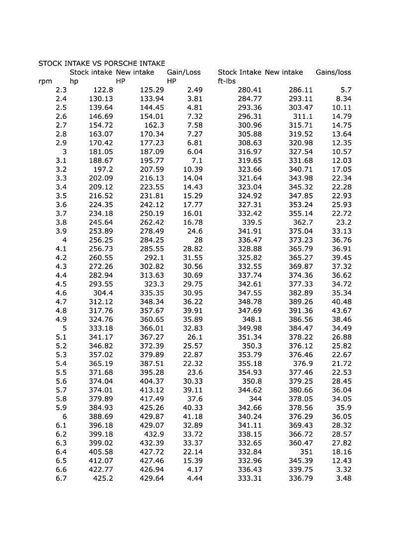

How did the Porsche intake pan out? I remember seeing a preliminary dyno chart but I thought you were going to play with things and see if you couldn't get more out of it.
