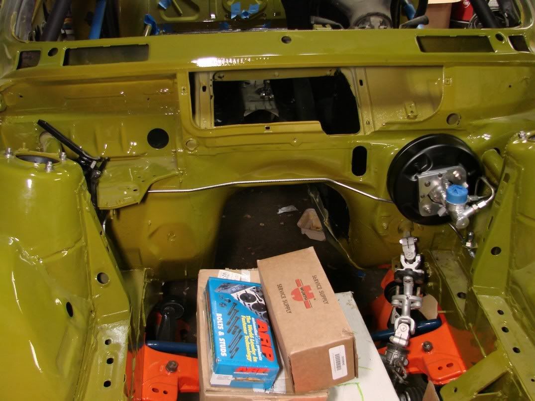

Painted my honda accord brake booster and polished my honda civic master cylinder and associated mounting brackets. Not a super siqqq job, but it will not stick out like a sore thumb in my uber clean engine bay...
BEFORE:
AFTER
Some other stuff...
Had to order ARP flywheel bolts today... and then i ruined my damper by trying to machine it down, So i had to buy a 500 dollar ATI superdamper. LAME.
Also spent 400 dollars on AN lines and fittings. Just keep spending spending spending...

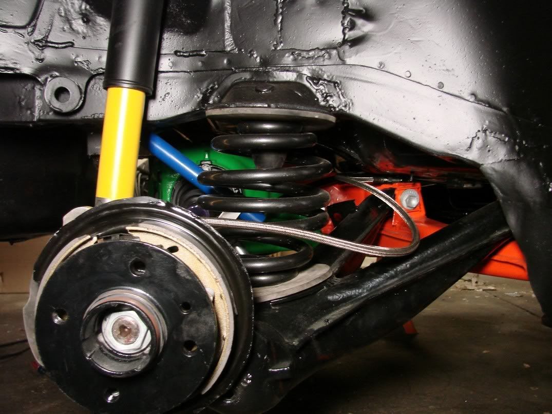

Here's a shot of the new rear ebrake setup. Probably one of the few e30s with a completely new oem rear ebrake. Also pictured are purple axle, green dif, yellow strut, blue swaybar and orange subframe. Black is so boring.

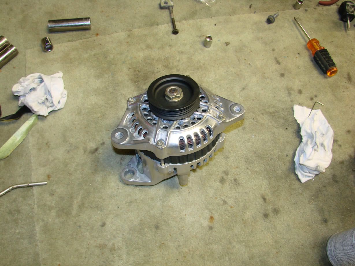

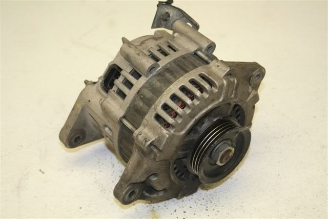

So i needed to do something about my alternator..
Before (reference pic, mine was actually MORE beat)
After a bunch of hours of sanding, painting and polishing. Again, not super baller or anything, but way better than it was.

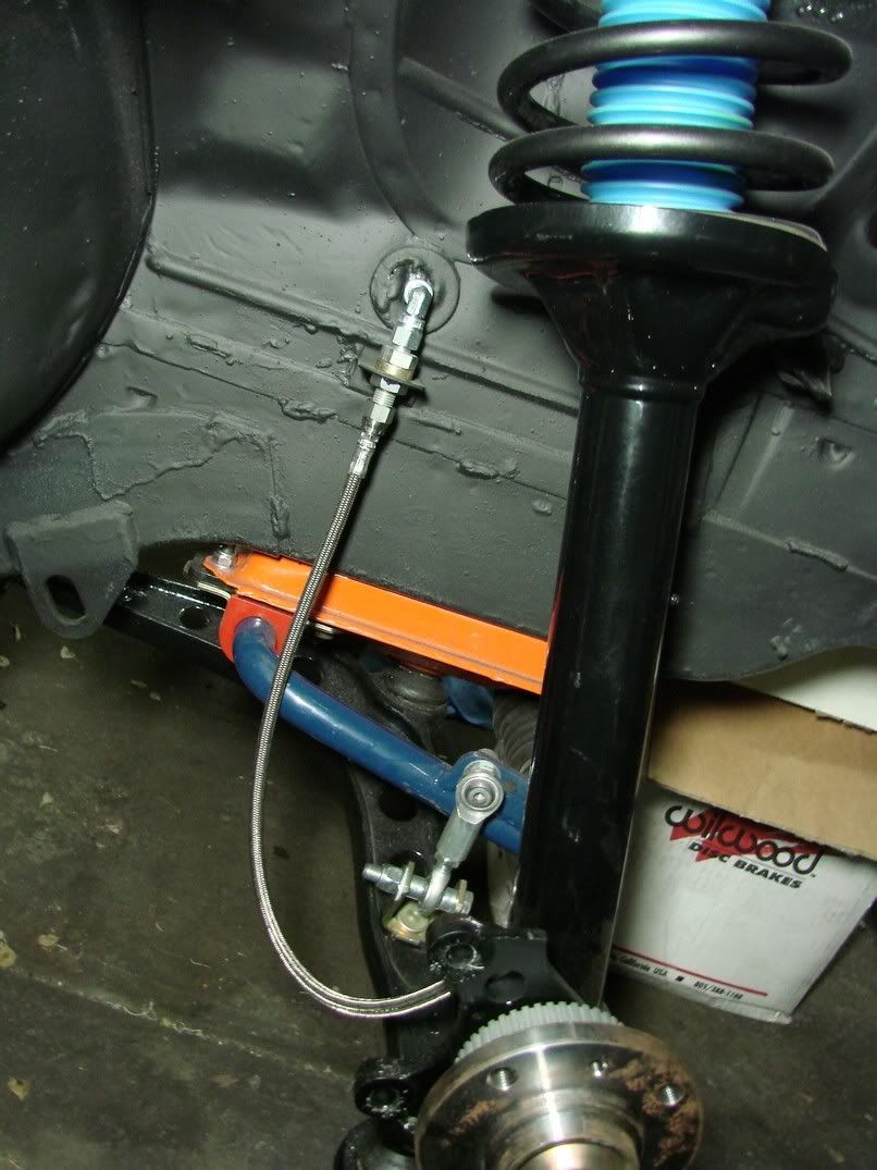

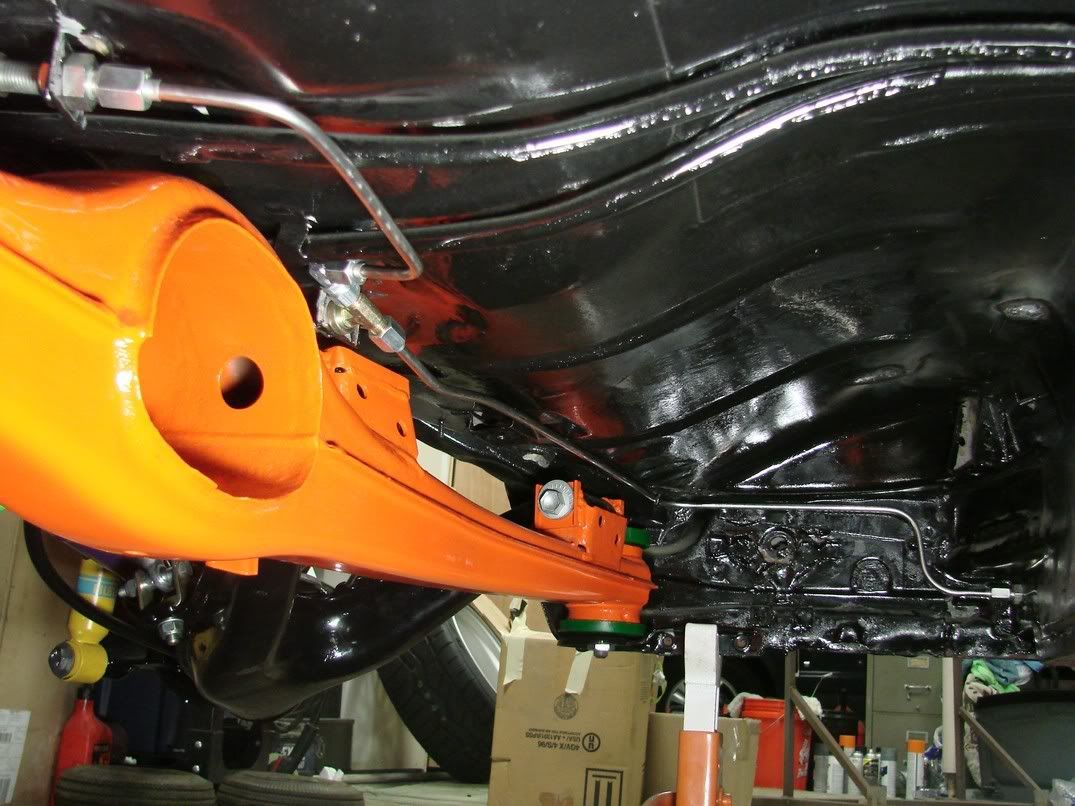

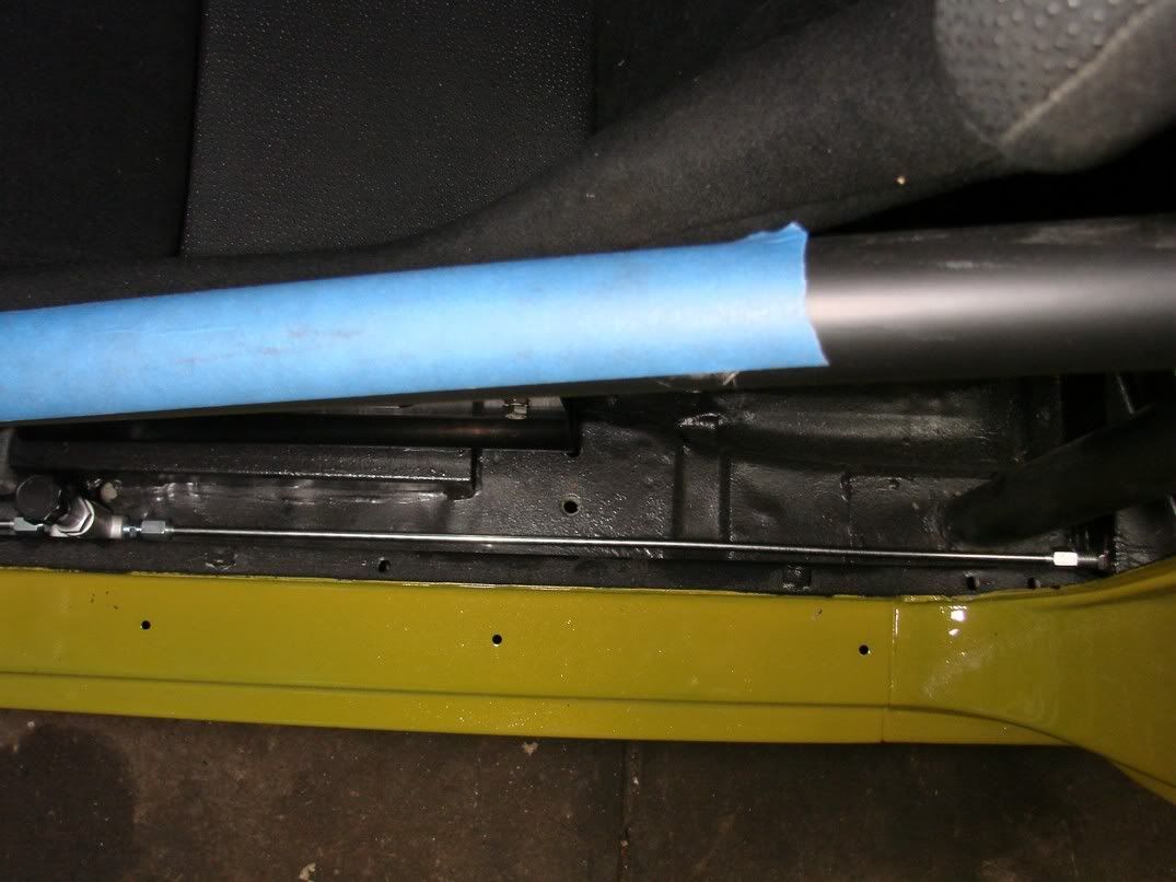

Finished all the brake lines. Still need to make mounting tabs though.
REAR
Here are the braided connections to the rear:
Here is the T area near the rear dif. In the Background you can see the line from the master where it pierces into the cabin:
Then the line running up to the prop valve:
The prop valve line runs forward up the firewall and in the background of the pic you can see where it pierces through under the master:

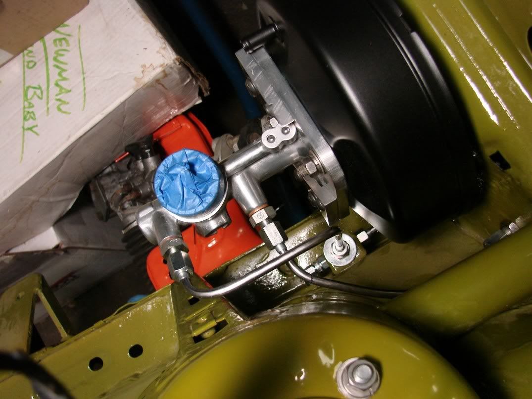

FRONT
Here is the braided connection for the front caliper:
Which then feeds this line that goes across the firewall:
And then into this T, which connects to the driver front and then into the master. (IDK why it looks so wet down there. Fluids haven't touched this car in ages. Haha. You can also see the bulkhead fitting where the rear line ties in:

As for the alternator, Yeah, I took it apart to paint it. The only things I painted were the stator laminations and the pulley.
The housing was hand sanded and polished using 100, 220, 400, 600, 900, 1200, 1500 then polish. It took a really long time to get done, haha.
Taking apart the alternator is REALLY easy, however before you take any bolts out, there is a small hole (about 1.5mm) on the back of the alternator. Slide an allen key in there to hold the brushes in place. Works great.

Originally Posted by ctnewman View Post
I used a pretty cheap bender from autozone or something that I bought for my old 240sx. It's black and has 3 different spots for 3/16, 1/4 and 3/8 tube. I have been using the 3/16 slot for the 1/4 though with good results. I am using an Imperial Eastman 37* single flaring tool.
you. I'll probably pull the alt apart. That's a lot of polishwork for a part that hides under the IM lol. Love it.

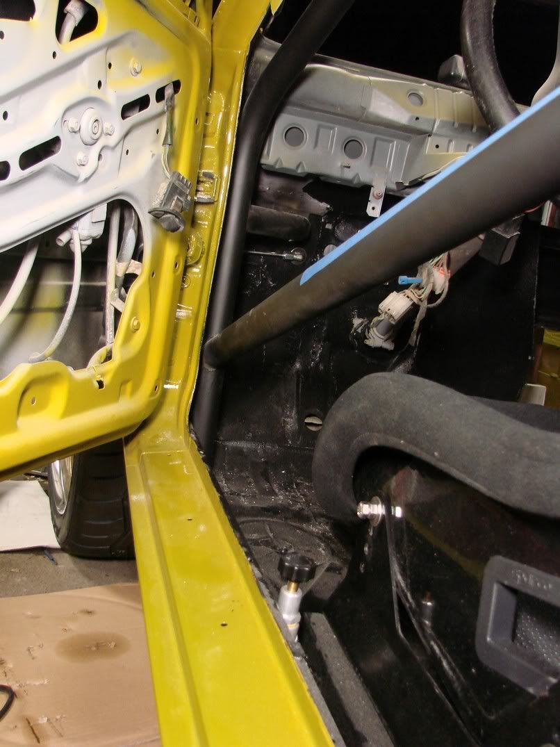

OK. Did work...
Mounted the fuel filter in the engine bay. Should be easy to get to. I machined that mounting bracket from billet.
Then I ran the -6 return line to a new bulkhead fitting on the tank (I still need a grommet.
Then I mounted the pump and ran the lines. I feel like a lot of guys spend pretty big money on braided fuel lines then turn it into a hackjob by ziptieing it to frame members. I wanted mine to be clean, so I used some shaker motor cable clamps. These are easy to install and look/hold great. (I also machined the fuel pump bracket)
