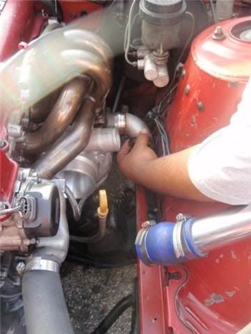

OMG that shit barely clears...... if the engine torques it looks like its hitting?

Its all good man, my mounts are pretty solid, atleast it will work now for sure, it wasnt expensive for the angle either, i just got 2 v band flanges and got a 90* bend made.

But it is close eh..... man....
