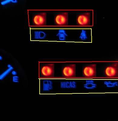

^Looks like the individual warning lights to me. "Cruise Control, Low Fuel, Battery, etc. etc."

But in the first post he has with pics.. he says it was just that bulb right? Or he changed all those little guys too?

First pic he has the bulb circled that lights up the little "icons" under the warning lights. That one bulb lights up all those, but each warning light is it's own bulb. Does that make sense? I don't know if I'm explaining it well enough.

So the big bulbs owns all the litte ones?

thatguy is correct. on the s13, the warning lamp icons are always lit, whether or not a warning exists. above each icon is a separate, round light that comes on when there is a warning. See the pic below. I've copied and pasted the oil pressure warning light over to all the other icons to sort of show what it would look like if all the warning lamps were on (in actuality some are different colors). All of the icons are lit by the bulb marked (1) in the earlier photo. The actual warning lamps are lit by individual bulbs, the black/dark brown ones that aren't circled in the earlier photo.
the icons are in the yellow boxes. these are always visible, and are lit by bulb number (1). The actual warning lamps are in the red boxes, and are individually lit by those black/dark brown bulbs. I have not changed those yet, but plan to in the future.

Well that makes sense..
