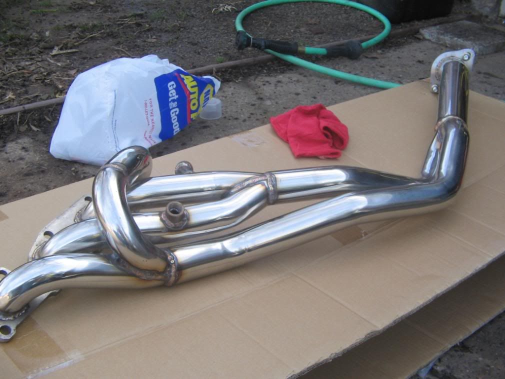

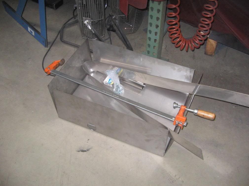

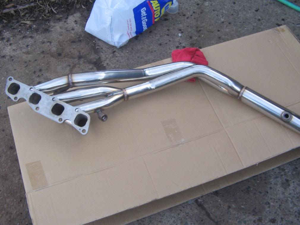

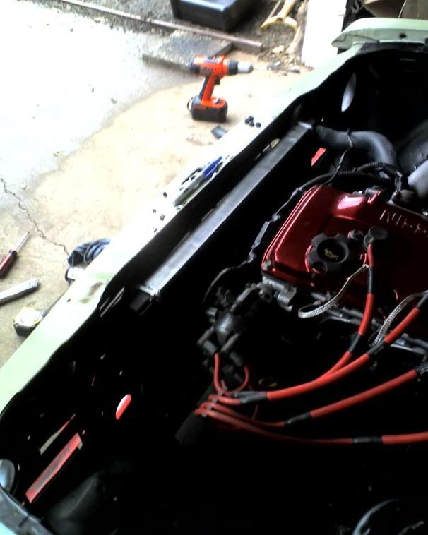

Okay, not REAL progress, but good news, nonetheless! I ran over to FBI today to get a part made for my dad, and decided to check out the piece of metal that came in on Friday. But not just ANY piece of metal... it's the piece of metal that's been laser cut for my fuel cell!
Nifty, eh? The next order of business (tonight or tomorrow) is Marty bending the sides inward and starting to weld! It has the exact bolt pattern laser cut out for the sending unit to line up with, so we've got to get some nuts and bolts and weld them inside to screw it all down to. Then it's a matter of capping the bottom off, and finding the correct tube for the filler neck, welding in some baffles, and SHA-POW!! Fuel cell done!

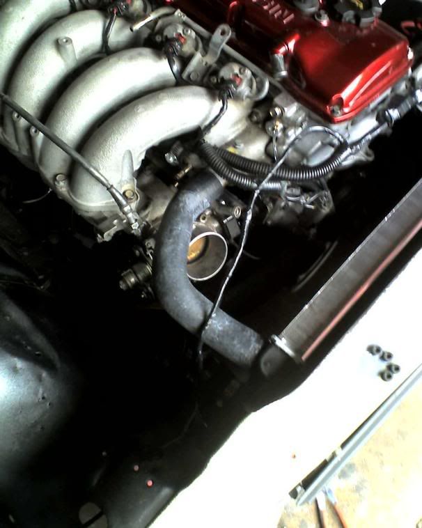

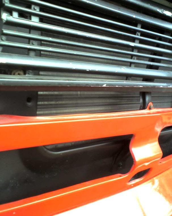

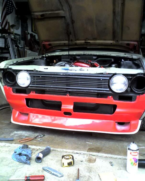

Right, picture time. Today, Phil and I drilled some holes into my radiator support and mounted the radiator all up in there! We also grabbed some 240sx radiator hoses, both of which had to be trimmed quite a bit to fit on there. The next step is to get the pressurized overflow tank from a VW, get a 10" electric fan and mount it to the radiator, and toss some hose clamps on the hoses and radiator is all done.
Also, we threw hose clamps on the heater hoses, so that's ready to go. Tomorrow, I'll go back to SMA and get my headers (hopefully the right ones this time!), and Marty is going to get the rest of the metal for my fuel cell. He told me that by the end of the week, it'll be ready, so keep your fingers crossed! Next on the list is wiring, and re-running a few fuel lines and we should be ready to try and start the motor... I hope...

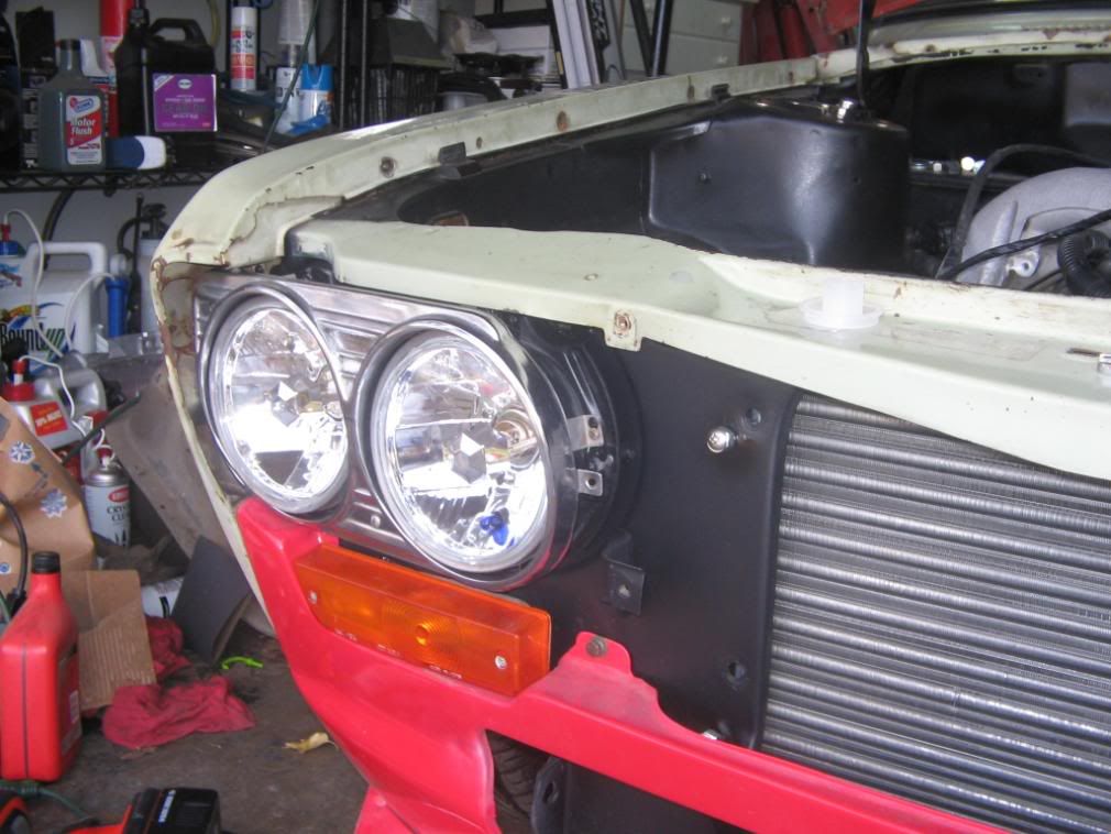

Radiator fillin' up the space:
Mounted:
Hoses:
Pokin' through:
Grille:
I'll keep you guys posted this week, but there won't be much progress until next weekend.

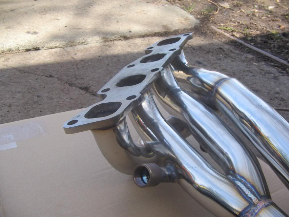

Big, Humongous, Giant, Shiny Update!!
I have plenty of pictures this time, taken by an actual camera, not my phone, to keep you guys entertained, cuz nobody likes reading anyway!
Today, I finally picked up my headers, and ran to FBI to show them off to my brother. It's amazing what $113 will get you, so long as it's made in China!
Stainless steel headers:

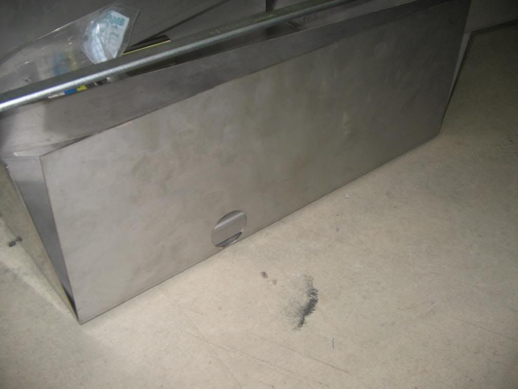

While I was at FBI, I checked in on my fuel cell, and it actually was finished today after I left, so tomorrow I get to take it home and set it on the dinner table as a centerpiece! I have baffles welded inside, as well as a laser cut hole for the sending unit and nuts welded inside to thread through for the sending unit (pictured a few posts back when it was flat):
Filler:

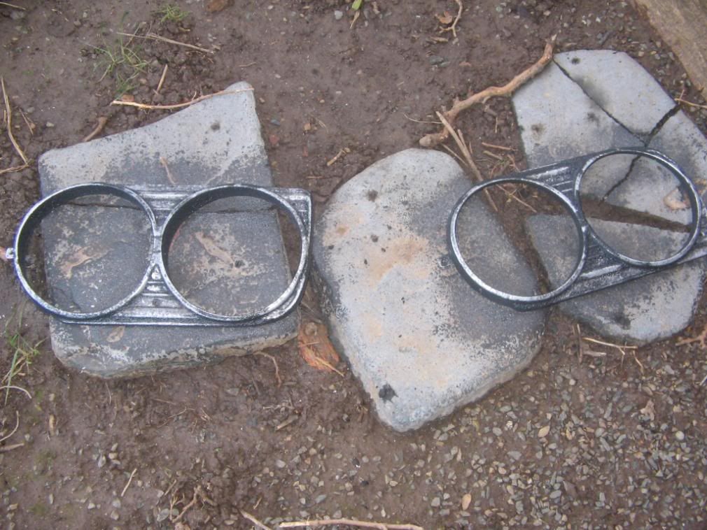

I ran to NAPA, and grabbed more paint stripper, like I used on the new hood, as well as some new rags (I flew through the last 25 pack of shop rags) and steel wool to clean up my stainless trim bits and grille.

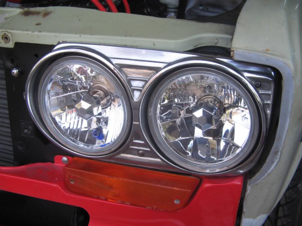

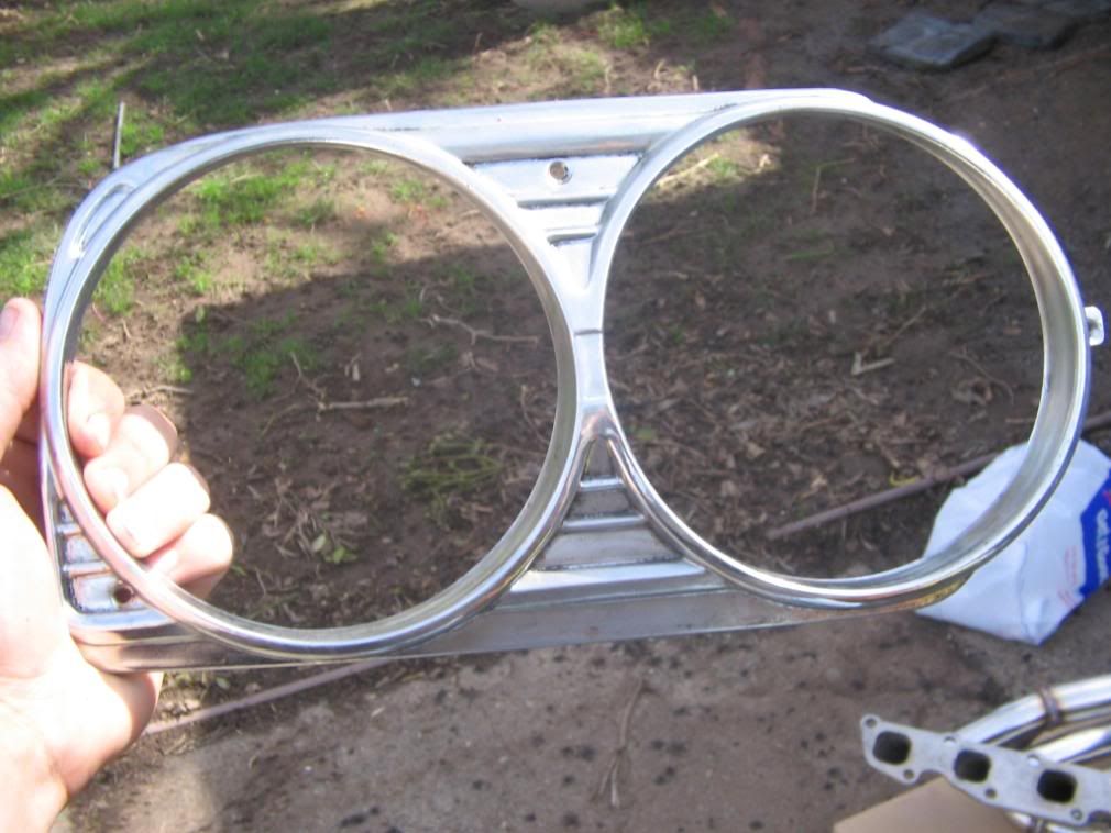

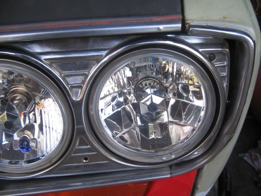

Sprayed a few layers of stripper on the headlight covers, which were covered in black (see first post for before shots):
Stripped:
Then I hit the grille:
And bottom trim and hood trim and "eyebrows" (fender trim):

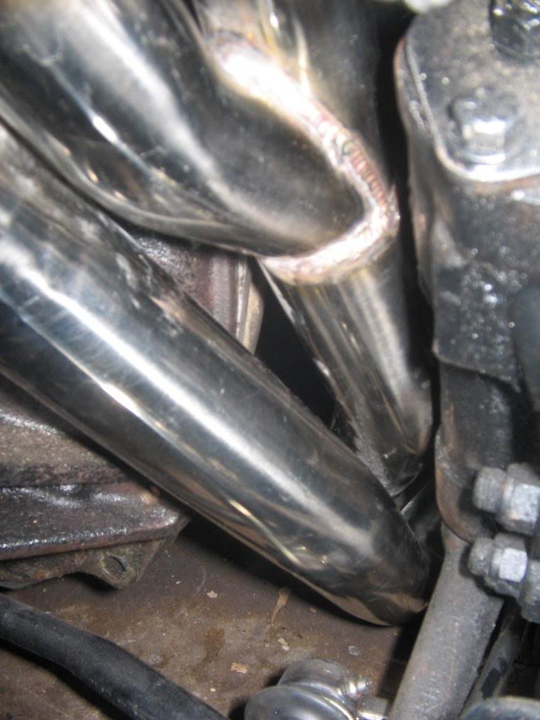

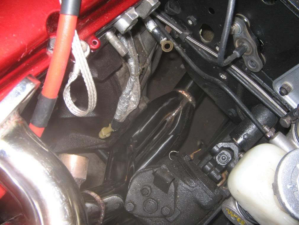

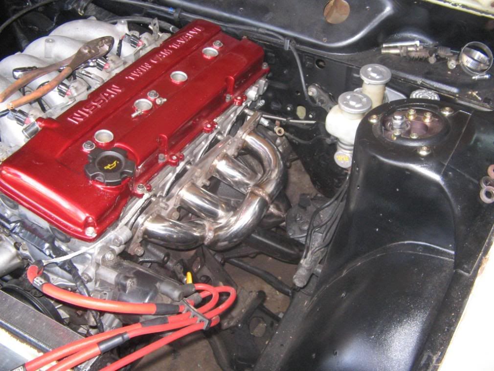

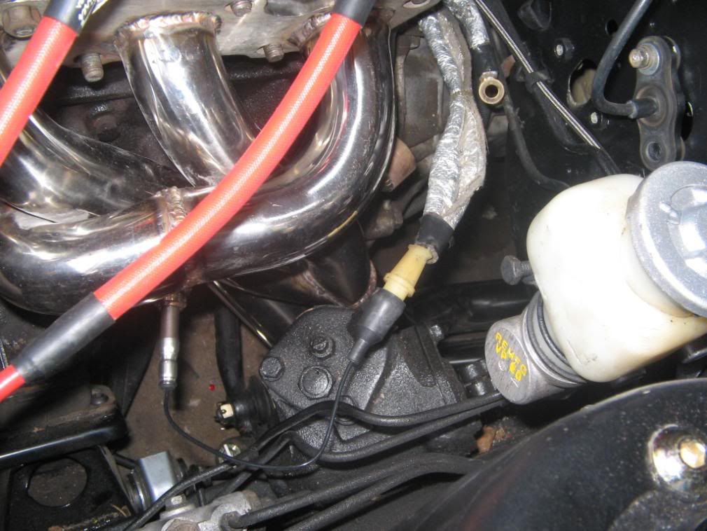

Cool, then it was time to drop in my nice, new headers and see how they fit! Oh, wait... They were made for a 240sx? Well, damn! As with my brother's 2-door, the flange curves up too much, and hits the floor pan BARELY too soon to bolt it on, so I'll have to take it off and cut the flange off to mount it permanently, and let the exhaust shop deal with it! I was also having a bitch of a time trying to fit the exhaust between the tranny and steering box, it's a tight fit and I couldn't remember how we did the 2-door. I ended up having to crank the wheels ALL the way to the right to get it here:
And then ALL the way to the left to get it to drop down where I needed it so I could get the flange onto the block:
But like I said, it hits the floor pan underneath, so I can't thread it on there completely, but it'll be done this weekend before we fire her up.
A few misc. shots I took:
Clearance on steering box (will probably get a lil tighter when I mount it completely):
Shiny pipes:

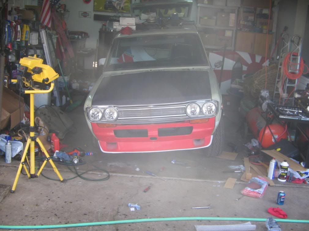

Raising the suspension to ride height/car on jacks:
New O2 sensor, and plenty of wire to use it:
So as far as a plan goes, I need VERY little to get this thing driving! Wiring shouldn't take long, Phil just needs to find the old diagram we used, and tie in a master cutoff switch. Mounting and plumbing the fuel tank should only take a bit, and then it's just a matter of tossing some nuts on the fenders, bleeding the brakes and turning the key! Unless something severe comes up, this car WILL be running this weekend.
