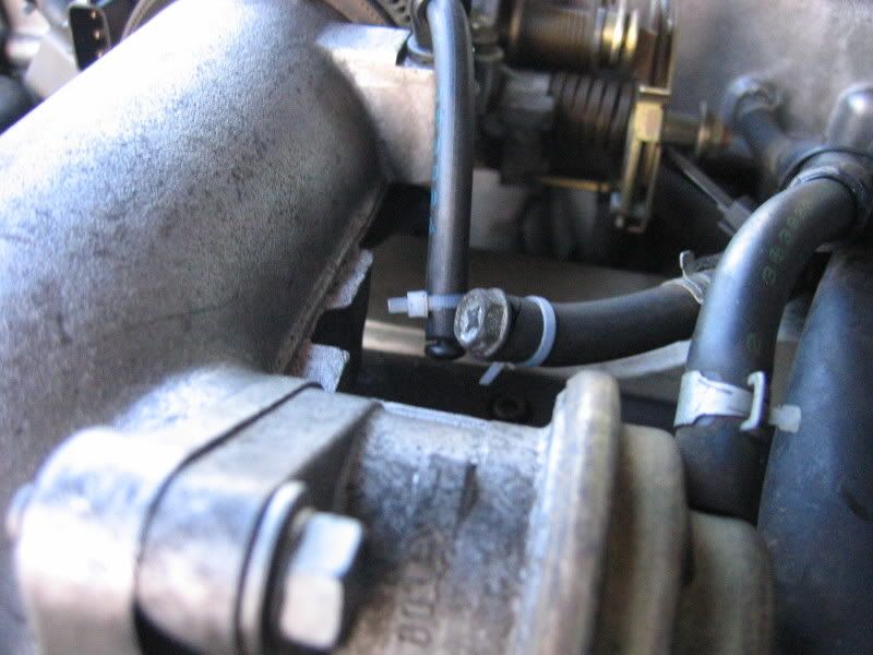

here are actuator and mysterio hoses that i was wondering about before:
and after:
Yes I realize that it is wrong. I just realized tonight that the hybrid FMIC kit uses 1 or the stock pipes with a nipple on it so i am going to hook that up to the pipe rather than where it is right now and block off that small hose pictured.
The other 2 hoses blocked off and unbolted:

Also i am looking for help on what to do with these 2 lines that wer attached to the KA and i gots no clue. right now i am thinking to block them off:
#1
#2
any help with those would be appreciated.

Evap purge system.
Get rid of the black box too.

Have you removed the whole line, AJ? What went where that picture is?

so i take it both 1 and 2 are trash and i should just off them and it really doesn't matter if i plug them or leave them open.

Possible that the gas tank may explode if the evap can is left on. I would remove it.
The Map/Baro should be a part of the KA harness. Which I don't understand why you didn't remove it.

Ken, the right hose might have been on your clip and fell off in the transfer. when the clip was trucked down to you. Usually you use the power steering hoses from the R33 clip or motorset not the s14 ones. hence,why you have that difference.

Gas tank explode if you leave the evap on? that's pretty unlikely. I'd say it's more of a possibliity if you were to remove the evap system, and not plug the gas tank.

but for anyone that wants to hook diectly up to the S14 rack nozzel, don't be like me and get a ride to the parst store only to return and find that you need biger hose.
