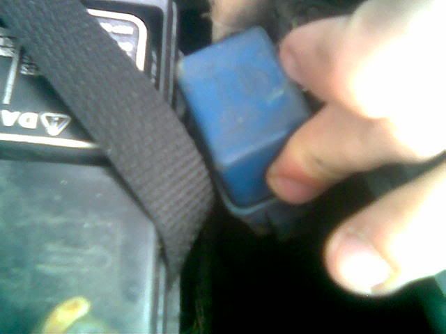

tre, that relay your talking about, when i relocated my battery, i didnt see any relays. do you have a pic or anything?

hrmm i'll go snap one real quick.

k i belive its mounted to the side. But I dont remember. Mine got crushed in an accident. Had to fidget with it to get it to work properly agian

S14s do not have a starter relay like the S13 does.
There's a clutch interlock relay that does a similiar function in the main fusebox.

oh he has an s14? lol
