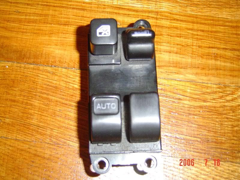

first take out the panel from your door. there should be 1 screw holding the door handle and button switch panel thingy together*remember to take off harness ). see pic below
then take the 4 screws(yes i lost one:) holding the switch panel together, see pic.

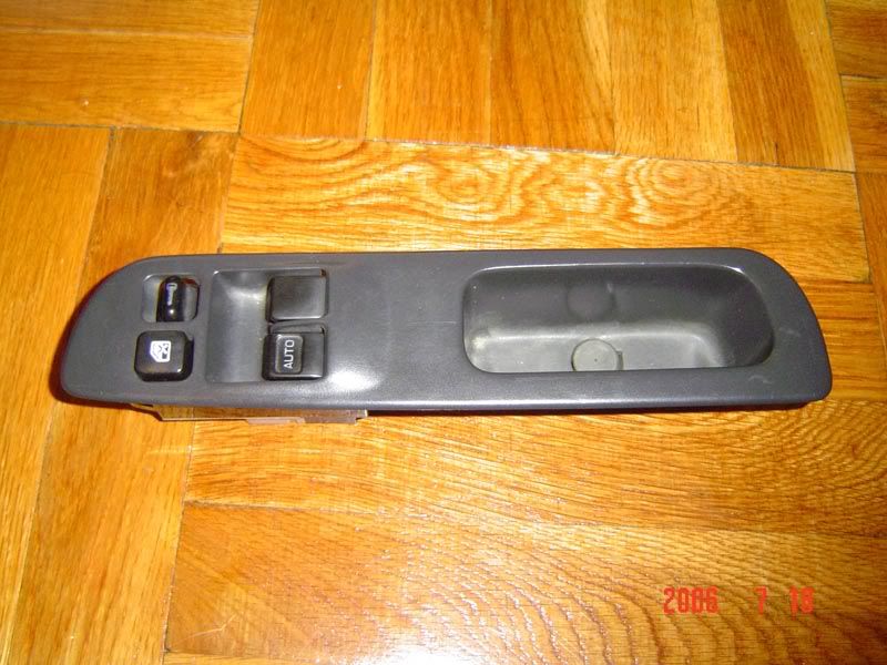

than take off the panel and you will have this, see pic

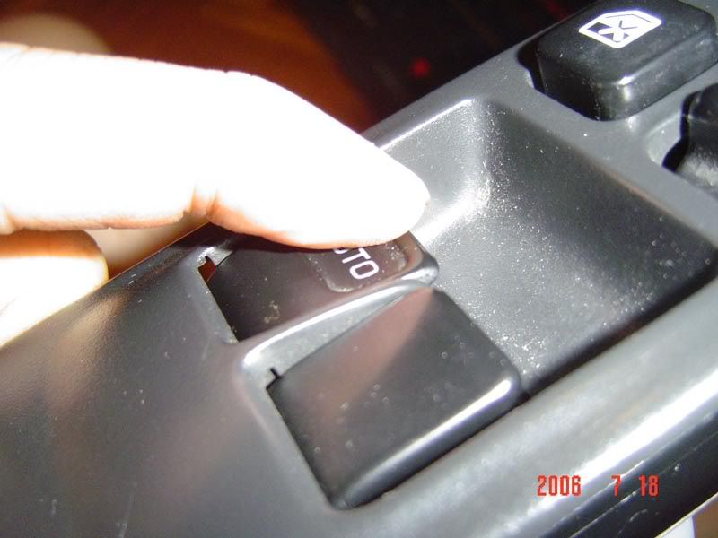

now take off that window lock button, all you have to do is yank it.

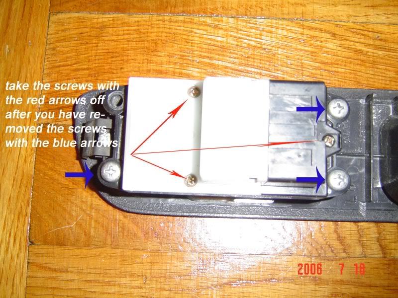

then take off the 3 screws with the red arrows pointing at it. see pic
take the white cover and the black cover off, and the board out.

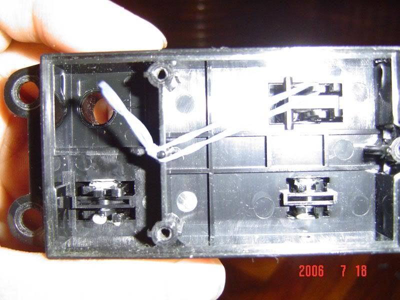

then you will see an underpanel with the little arms that pushes the switches up and down.see pic
as you can see there is the auto switch on the top and there are 2 prongs or w.e you wanna call them. the one the rubber band is hooked up to is not used so it will be ok. so just hook a small rubber band to that and the little dimple or nipple in the middle cut off section.
ur done!!! just put everything back together carefully, and remember put the board on first before flipping it right side up so the band doens't fall out of place. * trust me i used this for months and it was FINE * now if you are not satisified keep reading.

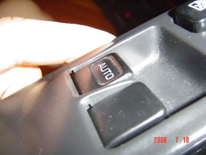

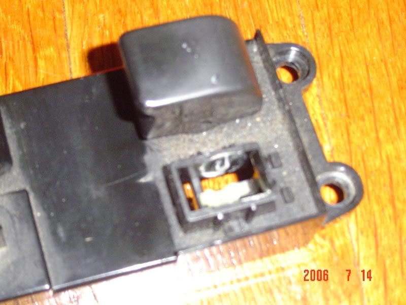

now becareful because you might break the switch. you take a small flat head and wedge it between the *auto* switch and pop it out. take your time. trust me don't break it. or you will have to buy the whole thing i believe
see pic to see how it looks like with it off

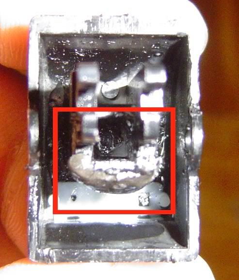

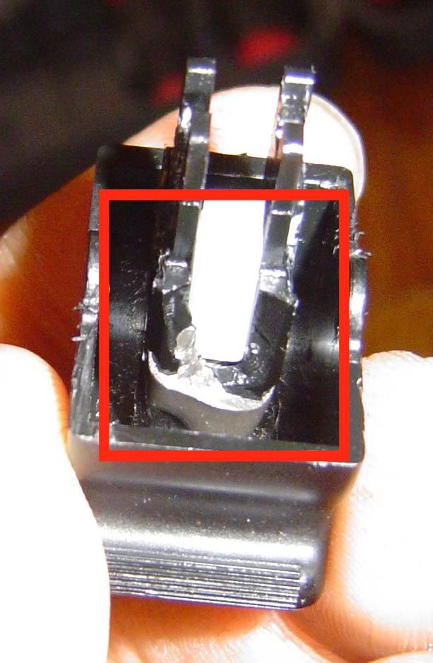

this is the part that is cracked see pics
there should be a piece floating around if it is broken ... if it is cracked don't do anything to it. get some pliers and take the white piston out. clean the area with alcohol, or nail polish remover w.e you have around the cracked area or broken area because there will be grease. now get your jb weld or super super super glue and liberally apply and clamp with something that can do it.. i used my needle nose and rubber banded the handles. ** do not get any glue into the square hole** let it dry. ** do not put the piston back in before letting the glue dry because then your piston will be glued together with the hole and it won't work at all. ** happened to me, was a real bitch to take out **
now after letting it dry grease the piston a little and shove it back in. put the switch back on. put it all back together. bring it to your car and plug all wires and screw down. feel how it should've been new ** well not really but hey... it works perfectly** it depresses a little to just scroll the window down to the height you want or if you press it a little more it clicks and the whole window goes down * auto * haha
see pics it comes right back up to the neutral upright position it should be.
