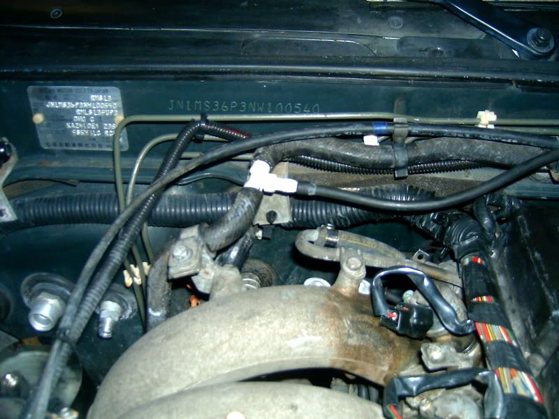

I see five ports in front of the throttle body not three like you said, and the one on the far right is the fattest not that far left.
And keep the brake booster on this nipple?
Thats the tee i have for my bov off the brake booster. So should i take that out and move it to one of the ports under the throttle body?
If you could, please go over the five ports under the TB and say which one should go where? I would appreciate it sooo much.
And how do i find where my vaccum leak is from?
Just a pic of the engine bay for reference.

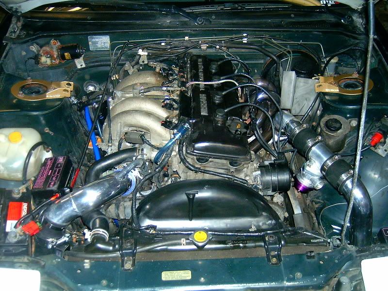

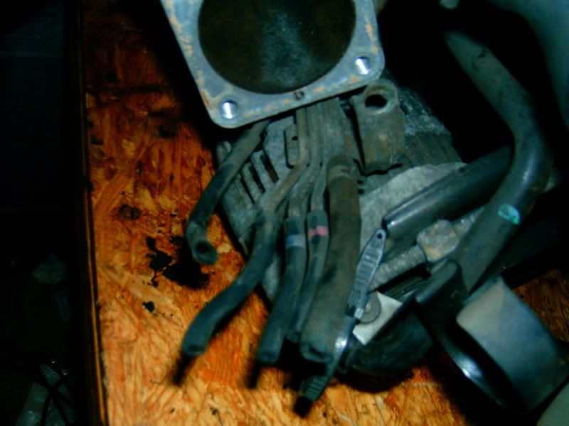

that plastic tee was way whack, i have a vac block like they were describing, check it
thoes 5 pipes from the tb all go to emissions shit, if you gut the manifold you can remove that entire thing of pipes. notice in my pic there is no fistfull of shit comming from the intake manifold
to check for vaccum leak go to home depot and get a 2 inch rubber cap. get an air compressor or drive to sombodys house with one first. cram it over your turbo inlet. poke a small hole in the rubber cap with a straight pin, and cram the inlet to the air compressor into it. then you are putting compressed air into your intake system, so it will hiss and blow air wherever it is leaking.
