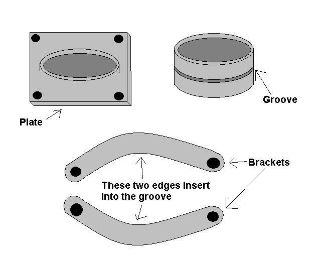

May I offer a suggestion? If you used a digital camera to take pictures of what you needed help with as far as re-assembling your shifter into the transmission, I bet everyone could help out. I'm down to help you out also.
I did a B&M knockoff. The round spring that's not flat but kinda wavy goes in first. Then you slide the bottom of the shift rod through your plastic spacer and insert it into the transmission, making sure that the pivot point fits properly into the linkage connection housing. Then you slide your 1/8" plastic spacer on top of the shift rod pivot ball. On top of the plastic spacer sits the top plate, and the two brackets you have attach the plate to the shifter housing by sliding into the groove on the side of the shifter housing and then being snugged down by alan (sp?) bolts at the four corners of the plate. I've included a drawing that may help.

Originally Posted by s13_gearhead
Thats not a B&M knockoff. Thats a C's knockoff or whatever.
B&M has a single rectangular plate that is a solid one piece design. The SHifter, IIRC, is also single onepiece design.
The shifter type shown above is ASS.

Oh, right, actually I think it was an ASS knockoff. Wow, I spent 10 minutes drawing that picture, and it means nothing to this guy. lol.
hey man thanks a million for the time you took drawing the picture. i appreciate it.

Its been a while since i took apart that shifter, but again, the plate is a single piece.
