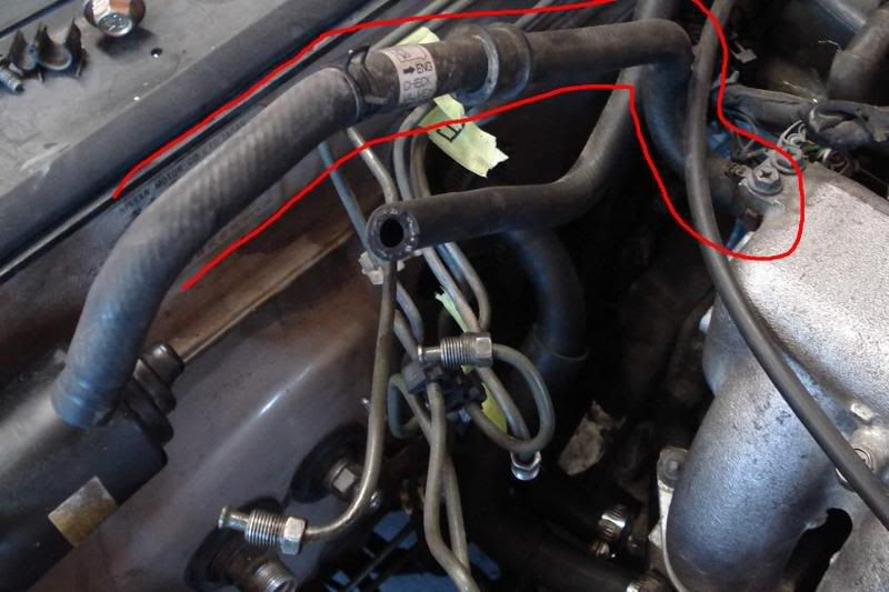

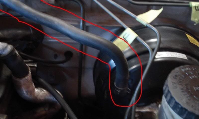

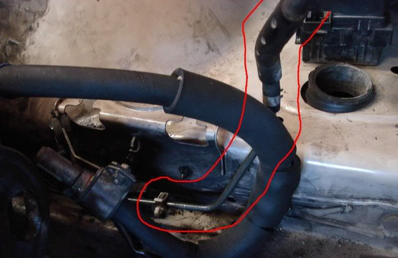

Thanks. That makes sense. I got my camera now so I have taken a few pictures of some lines that I am not sure where they connect too. Any Ideas?
This hose comes off the back of the intake manifold
This line comes off the master cylinder
This hard line comes from beneath the car somewhere

top one is for the power brakes and benieth that little black flanged thing is a check valve.

Sorry I think I made a mistake in the second picture. I believe thats the brake booster that the hose is coming off of. I got a response from another thread saying to connect that to the back of the intake manifold. Just need a second opinion on this.
and I was told that the bottom picture is a hard line that went to the activated carbon canister which I believe is connected to the fuel tank. I think I can just cap that one off.

no dont cap that one off
thats a vent for your fuel tank. it lets air in so the fuel can come out
get a mini filter or just let it chill there.

ahh good point. makes sense because of suction. Well.. I guess it was previously connected to the canister which was then connected to vacuum?
So does it make sense to connect that hard line to the intake manifold or my other vacuum lines? Thanks

ehh i guess you could, but i dont think it would matter because as the fuel pump sucks fuel out and the fuel level drops, it can suck in air by itself via that hardline
could be wrong

ya makes sense. i'll probably just leave it

just cap it with a mini filter. its the breather line for the evap system. used to conect to the charcol canister, its not needed unless you live in a state that you have to pass emisions tests. DO NOT hook it to any vacume line. it was controlled previously by a vacume activated solenoid and not drawn from all the time. repeat, DO NOT hook to any vacume line
