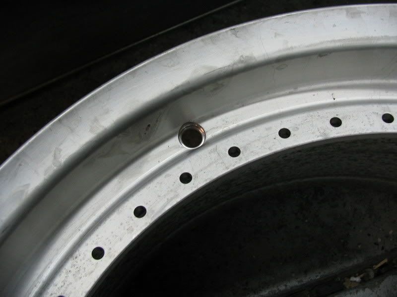

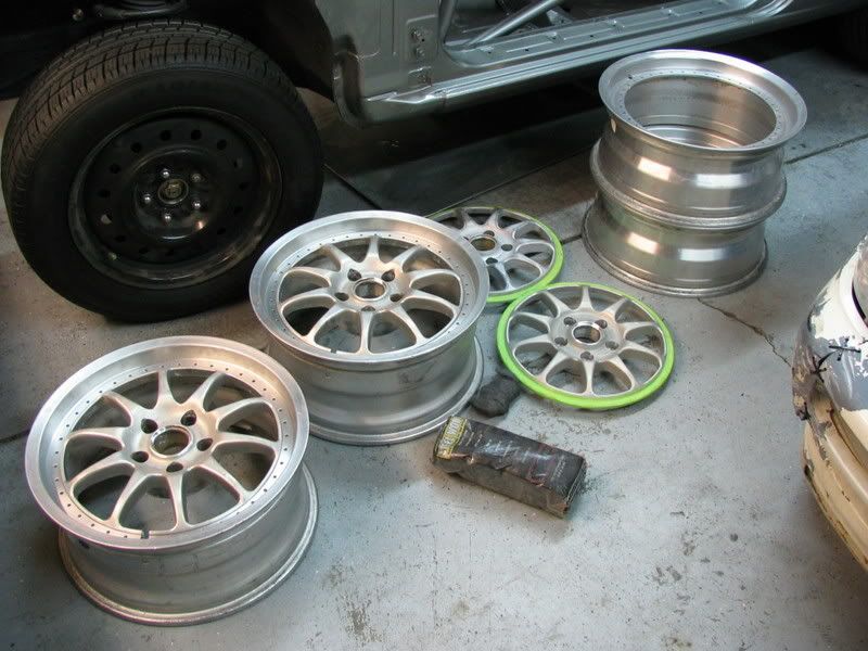

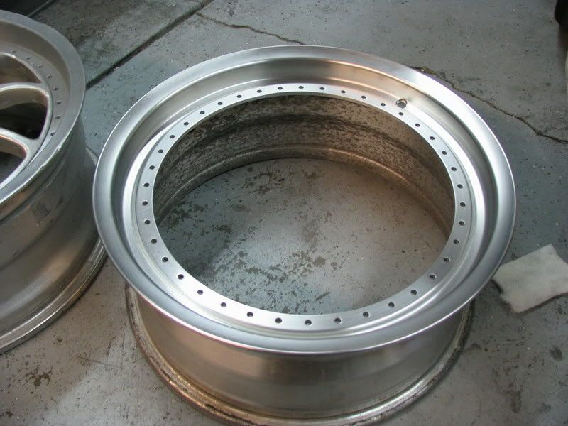

The wheels as I received them:
Oxidized lips...

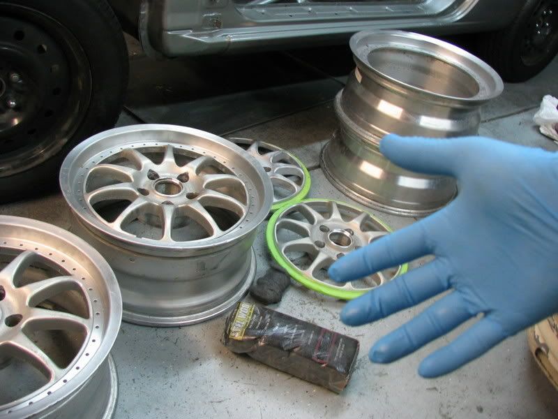

Almost forgot, just me n my hand lol...
How do you get your kicks??? Dahaha!

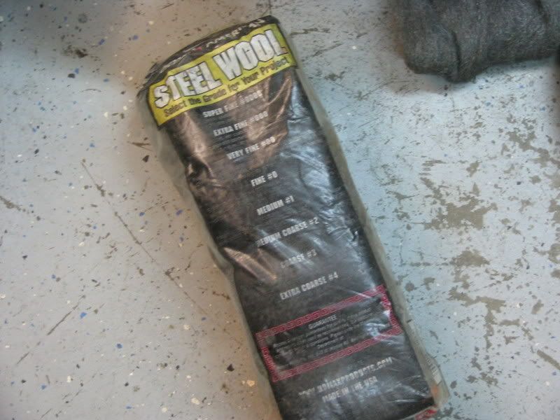

To bring out the bling, I used red scotch pads, then white scotch pads, then very very fine steel wool:
What happens when its just me n my hand tonight, take that pink!!

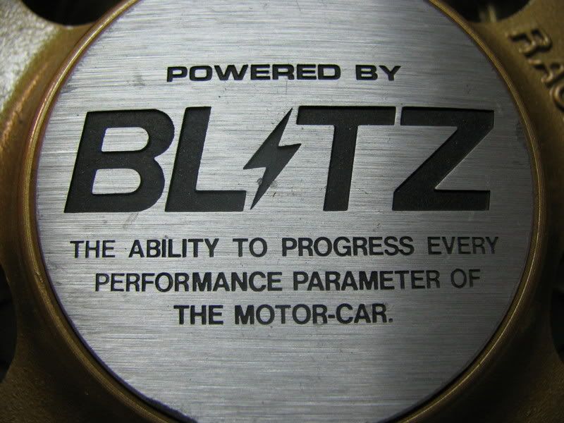

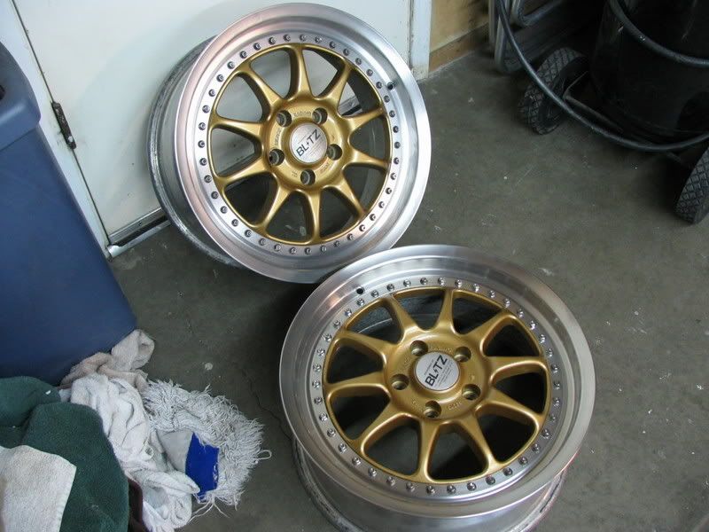

Paint centers n clear em
Bolt em back together and admire!
Rad center caps!
Ridding myself of lame stockies shortly!

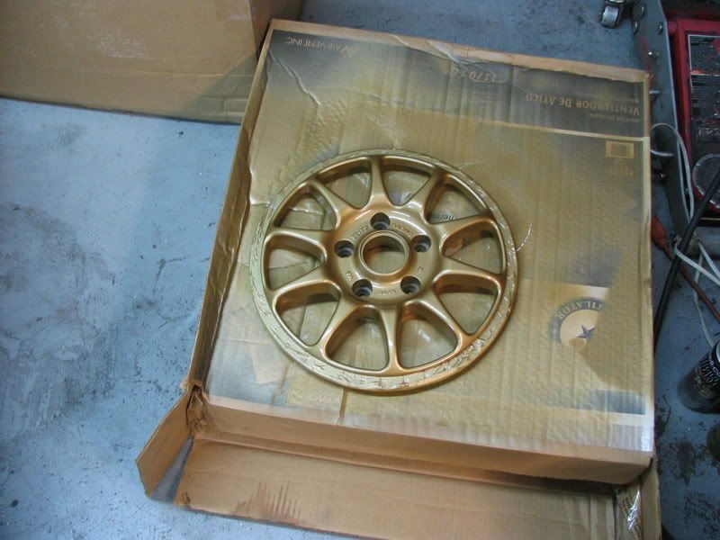

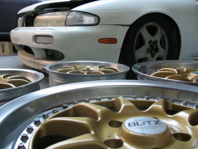

Rear wheels "masked" and just primed..the index card trick works great!
Tonight I finished painting and clearing the rears but still need to bolt them together....tomorrow they should be all done, then I just need tires! Thanks for looking and maybe this can help anyone thinking about doing a DIY wheel restoration, its the second set Ive done! Enjoy, and remember, if some girl tells you its just you and your hand tonight...it CAN work out

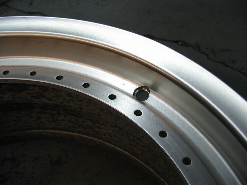

So, if i'm looking at the pics right, the 2 pieces are held together by a butt-load of allen bolts? I never knew that before.

ima have to try that steel wool thing. good job YO!

Amazing what that steel wool can do isn't it! Nice JOB.

did you torque them when you put them back together? How many ft lbs? Just curious because Im thinking about taking my wheels apart to do the same. Gotta give my wheels a nice hand job.

speedgod^s13, Not allen heads, they are 12-pt and all stainless steel so super tough, and theres 40 of them, such a bitch to tighten!
Logan, haha yeah I will for sure after Im through with em...I need to talk to you as well about some new kicks since I sold the maximums...
95Blue240sx, used loctite and ~20ftlbs, which is a little more than they specify IIRC but i dont know how accurate my tq wrench is....def is comparable to very tight with a 1/4 drive wrench by hand lol. Either way...i trust it!

looks good. did you clear the lip as well? otherwise it'll just oxidize.

I decided to leave the lips raw so i can keep em clean and polished, just reapply the polish here and there and itll be tits!
