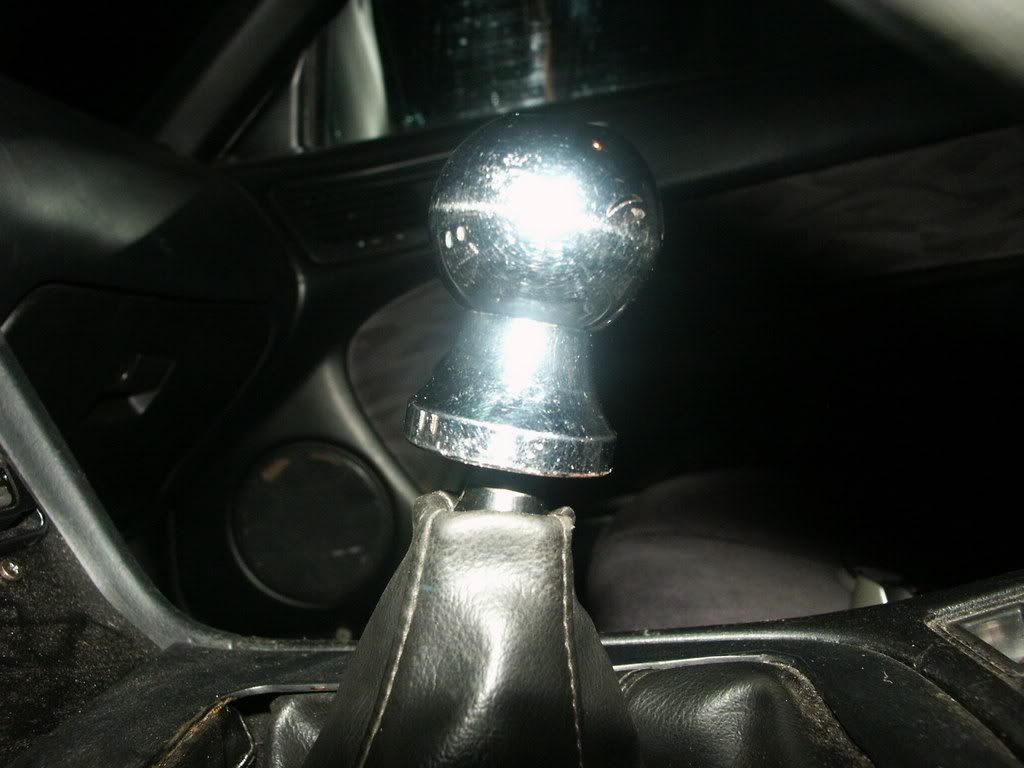

So you want a heavy shift knob?
Been wanting to do this for a while, I figure it was $7 for the smallest hitch and free to machine (you'll need to have a friend who works at a machine shop because the stock shifter flares out to .55 inch, which is 5 thousands more than most people have for drill bits) and is nice and heavy and feels good in the hand. Just wondering if anyone else has beaten me to it?

Originally Posted by TravisSW View Post
And a dirty center console!
Yes... Looks alot worse under a camera flash... Damn 10 year old cars...
But really, it's got a great feel, I was planning on doing something to keep it temperate, like powdercoating or leather wrapping. It's just the right size though.
And thanks to everyone who digs and even those who don't.

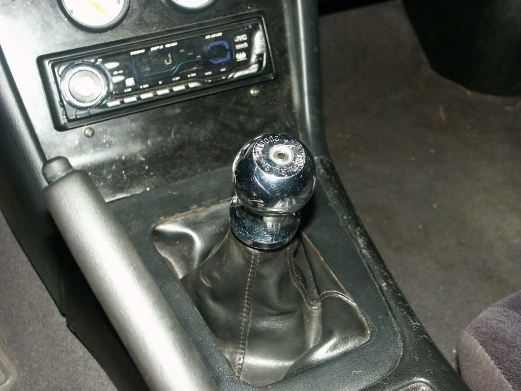

I know short throw shifters are the bomb, but this thread is for cheap skates like me who appreciate stock and making it better without dropping cash. Those of you interested in improving your stock shifter, read on.
Soon after getting my '92 240SX SE I took off the stock shift knob and replaced it with an expensive MOMO knob I had lying around. Since then I've used the MOMO and another cheap knob.
I like the look and feel of the MOMO, but it sticks up so high, and you don't have much confidence when shifting fast because after a few months the little set screws can loosen up and the knob can twist or come off.
To try to make the knob sit a little lower I used my dremel to cut about 3/8" off the threads on the top of the shifter. Still, too high, and could still loosen up unexpectedly.
Being a home grown DIY guy, I came up with a plan, it was a dirty and raw plan, but I thought it was good.
I suspected that since the factory knob was counter wieghted, then it was done so for a reason, so I needed a heftier knob, but I'm too cool for stock :grin so it had to be something custom.
So I decided to cut up a 2" trailer ball and make my own shifter. At first I was planning to drill the bottom and taper the hole and thread it so I could screw it on, but I don't have a drill press for precision, and I don't have a tap set for those metric threads, I just wanted something different.
I decided to drill straight through the ball, and since the shifter is tapered just below the threads, I drilled the bottom hole a larger diameter than the hole where the shifter comes through, then when you tighten a bolt on top it pushes the new knob against the taper and locks the shifter into position.
I made a drawing to clear it up a little, the verticle red lines are where I drilled, the horizontal line is where I cut the ball off.
What that drawing does not show is that I notched the top of the ball so that the washer and nut on top would sink into a little bit, I would have sunk it deeper, but I started with a hollow hitch ball and didn't have much steel on the top to work with.
So I made the thing up, sanded and smoothed it a bit (it was the used hitch ball that came off the back of my Samurai) and painted it. I was going to go with black, but everything in the car is black, so I went for some contrast with white. You might hate the look, I love it, it's different. The thing is, you've got a blank slate, you can paint it, wrap it in leather, go with a layer of carbon fiber cloth and resin, whatever.
That's the finished project. If you are wondering about the nut on the top, you don't even feel it when you are shifting, I painted it red, but I might take another nut and put some gun barrel blue on it, it would be cool to find some color anodized nuts to put on there.
Anyway, that's the aesthetics, this is where it really gets good.
The extra weight of the knob and it sitting lower has improved shifting 10 fold... at least! With a taller shifter you'd have more leverage on the shift, but sitting lower decreases the distance you throw and gives more precision. It feels so much smoother shifting, and I'm more confident knowing that this shift knob is not going anywhere. That's the main point, this shift knob is functional!
