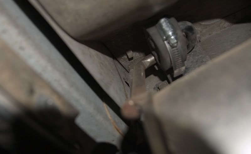

For low sitting exhaust:
If you want a quick fix or just trying not to spend money on urethane exhaust hangers, get some worm gear hose clamps from your nearest auto parts store and wrap them around your existing hangers and crank down on them. Done
I did this and I don't use the trasmission exhaust hanger. No more low exhaust.

Originally Posted by S13Leprechaun View Post
Timanator- what??? i dont understand what your talking about.. i dont see how its going to LIFT my echaust higher... my shits like 1/4'' off the ground literally..
Look at the pictures above. Notice that some of the rubber hangers are streched. Take a hose clamp and put it around that rubber hanger and tighten it. As you tighten it it will lift the exhaust.
If this still doesn't make sense I will go take a picture of my car if I can get to it.

Old 10-17-2007, 06:19 PM   #20
TheTimanator
TheTimanator's Avatar
Join Date: Apr 2002
Location: Nashville
Posts: 2,535
Kinda forgot to take pictures until tonight. It sucks because my camera wouldn't focus b/c it was too close. Plus, there's no room in there b/c my muffler is so close to the underbody. Hopefully it will give you an idea though:

OHHHHHHHHHHHH!!! around the whole thing, so its scrunches it up.. nice! ok cool... iw ork at kragen so ill just get asome tomrrow.. anything that will fit will work right? smaller the better im assuming...

Well the hose clamp method works but it's a PITA when you're trying to install/remove them. For the cost, NISMO exhaust hangers are a great upgrade. I've been using them for about 5 years now and they're still holding up really good.
They run about 15 bucks a piece, so getting just two for the first two mounting points - minus the muffler mounts - will work wonders.
