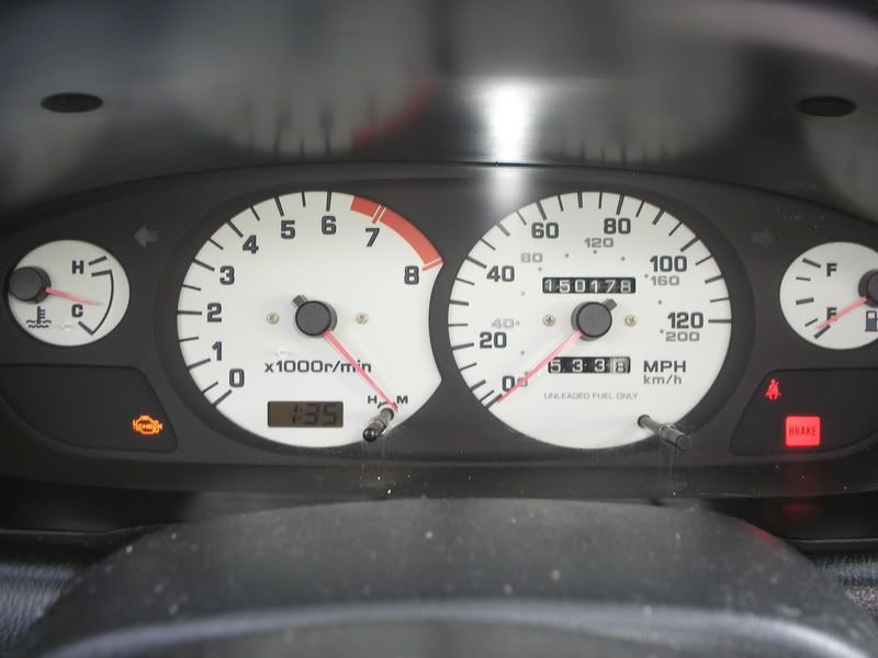

Okay so seriously, I need to get my tach working right again. Sometimes it works, sometimes it works but twitches a bit varying around 200rpms off, sometimes it reads idle, and sometimes it ever so slowly climbs to how you see it. The motor in the car is a lower mileage KA, and the previous owner said someting about how the tach is getting the signal from the engine. What should I try, without fishing the gauge cluster out of the dash?

Eh... I wanna make sure that there isn't something loose on the motor or something first. And if the tach is bad, what can I do that doesn't require hunting down another SE cluster?

Yeah, my tach is bad. It broke today. It is stuck pegged out. Time for an aftermarket unit.
