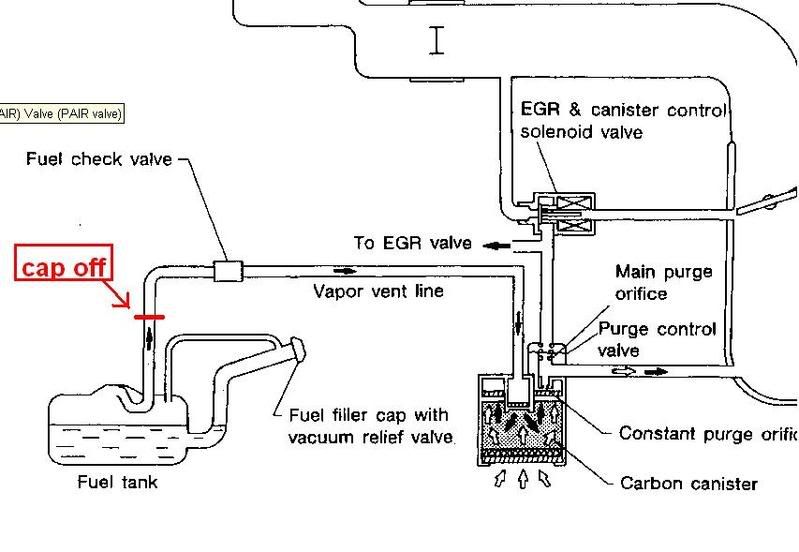

yeah its on the car like theyve all mentioned. they stick a thing in the gas tank to replace the gas cap and pressurize the tank to allow the fuel vapors to enter its path to the cc.
does the carbon canister sposed to have a big tube connected on the bottom that vents to the frame? if so how come it dont show on the FSM.
eerrrrr is offline   Reply With Quote

yeah thats what i was thinking about doing. there are 2 soft lines at the end of the hardlines, one from the gas tank, and one to the cc. i was planning on capping off the line from the gas tank. if i still fail, i know its something back there instead of up front. but i dont want to do this cuz i get a free retest. if i dont pass the free retest, ima have to pay another 50 or so bucks for smog test, and the diagnose also.
ok nevermind about capping off the lines. i just looked at the vid of how u use that smoke pro thing for the evap and i dont think i can just cap off the lines. it first checks for the flow of it first. if i cap it off, there would be no flow.

it only checks for leaks, the canister has nothing to do with it, we clamp off of the lines before it hits the canister, make sure your fuel evap lines going back into the tank arent leaking, and that all clamps are tight.

so when u "clamp off the lines before it hits the canister" did u plug it up or did u just tighten previous clamps on there. if u did clamp it off, did u pass the test?

when you evap test, you use locking pliers to clamp off the line right before it hits the canister up front or where ever it is depending on the car. so pretty much you have to make sure you dont have any leaks from the gas tank to your evap line.

do u guys think doing this will help me pass? if it dont pass, ill know that its somewhere in the back maybe? ive been reading lots and it seems like detection of a leak is due to loss of pressure when pressurized. so if this helps keep pressure (blocking path with something), would it be a way around the test? i need SMOG TECH helps.

that would be one method of pinpointing whether it be the tank or the lines, but your best bet, is to use a smoke machine. rent one or just go to a shop. =) fix the problem
