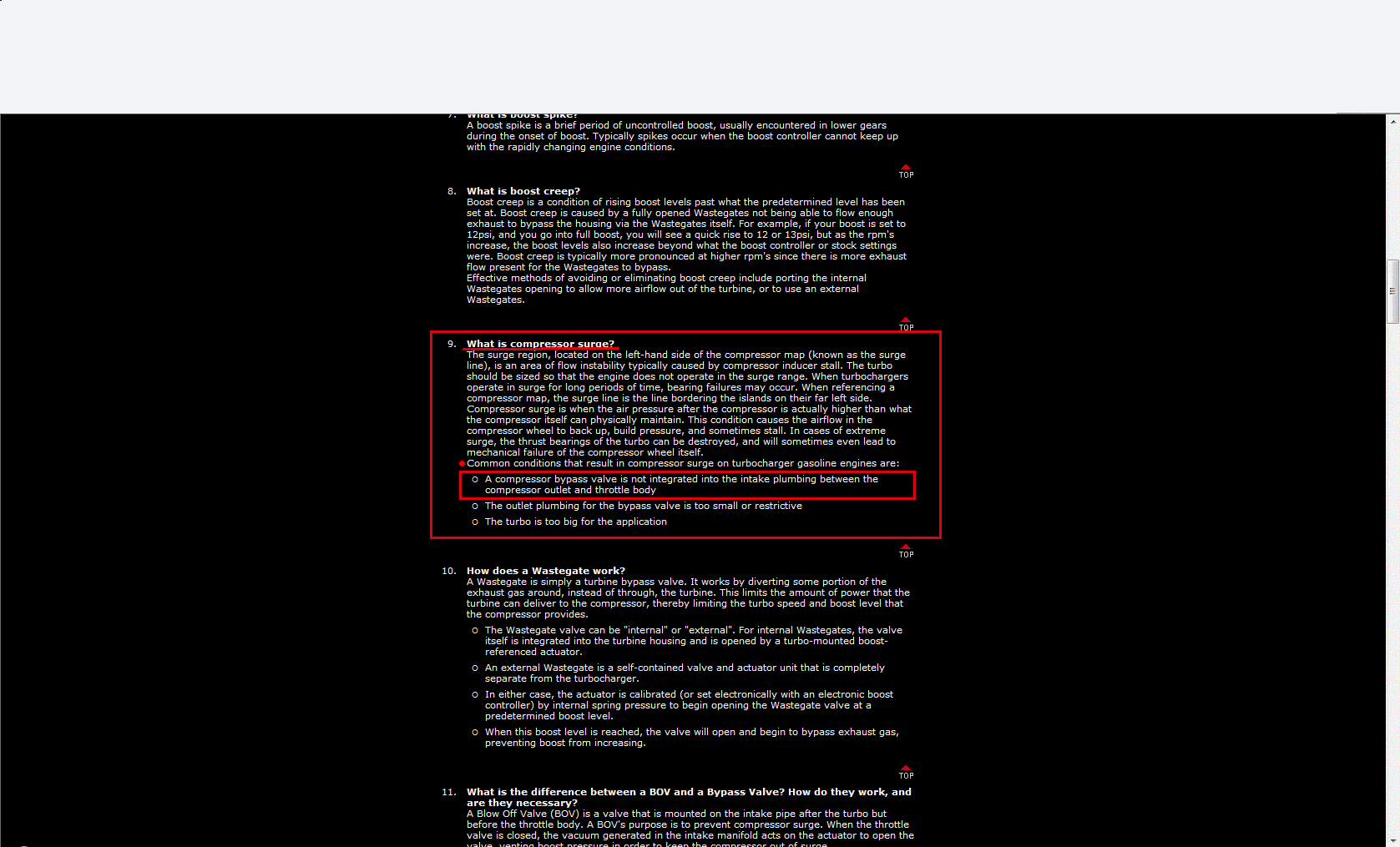

Here, straight from Garrett, I think they might know a little something about turbo's:
TurboByGarrett.com - FAQ's
Old 08-25-2008, 12:43 AM   #24
